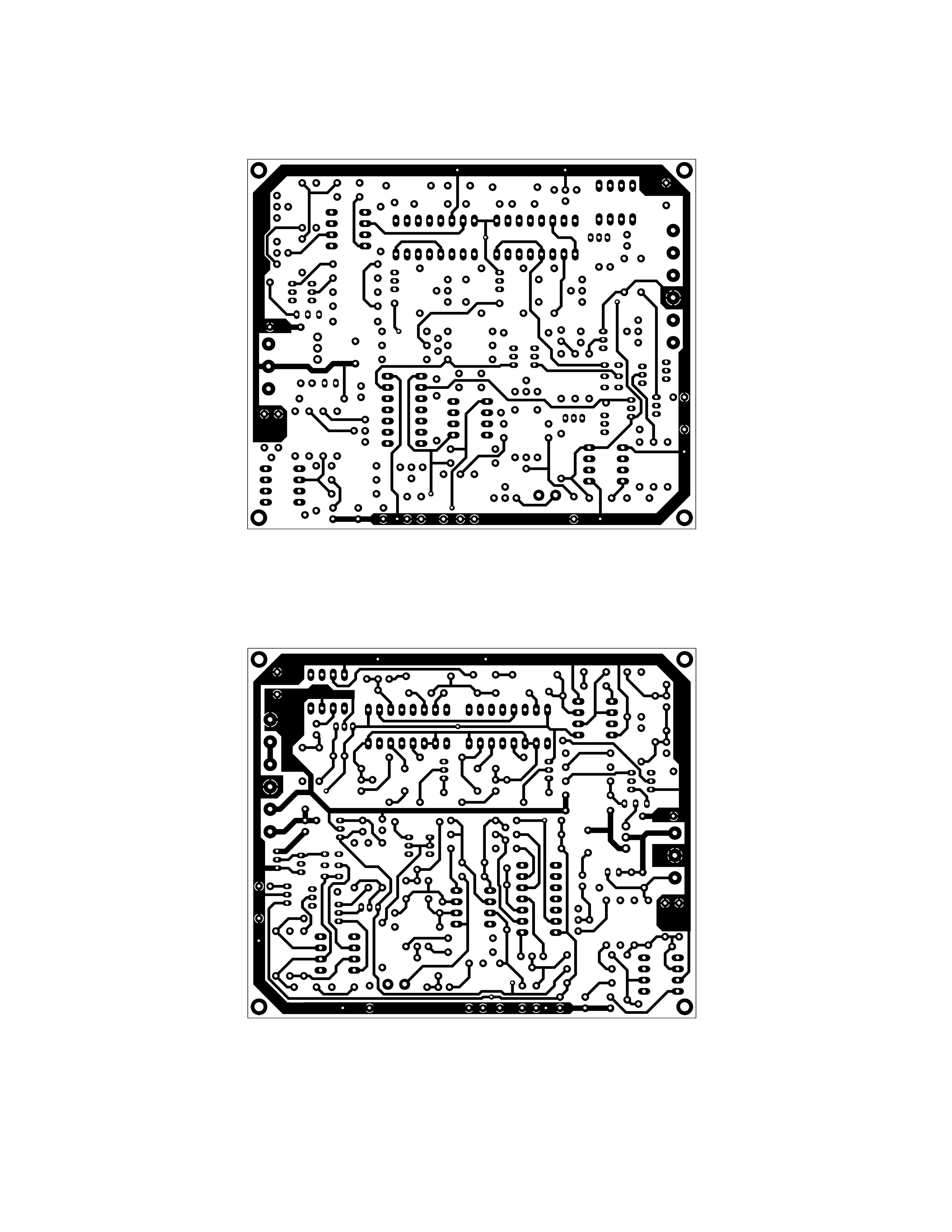

Here are the PCB layouts for both Rev C & Rev D, please note that it is 2x. Also the Gerber files for both revs, for those who want to import them into their CAD program for modification:
