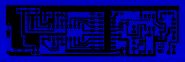

The Techniks transfer film is a clear plastic sheet with a blue coating on one side. It is the coating that acts as a release agent when heat is applied. So you print the foil image on the coated side of the film and simply iron it on. I used a 600dpi HP LaserJet5; I also did a test print to a 300dpi LaserJet4 and found the image quality to be slightly worse but still acceptable as long as you are not doing aggressively narrow line widths. Here is what the transfer film looks like after printing:

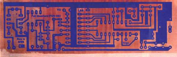

When you're ready lay the film, coated side down, onto the copper board and align it. Using an iron on a medium-hot setting (no steam!), press the film gently and evenly to get it started. Don't twist or slide the iron initially as it might move the film. Once you get it started, the film will stick fairly well to the copper and you can move the iron around. I recommend that you use a hobby iron, such as the type used to apply monokote to model airplanes. Work the transfer for several minutes, even for a small board. When you think you're done (it's sort of guesswork) rinse the board under cold water and peel off the film. Here is what you will see:

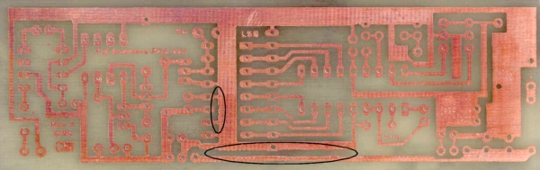

At this point you may or may not have to do a little bit of cleanup or touch up. The direction sheet says that you can put clear packing tape over the board, then peel it off to remove filled donut holes and the like. In my very first attempt (what you see above) the transfer worked very well with only a few traces that had rough edges where I did not do a good job with the iron. Nothing that needed attention, though, so I went directly for the etch tank. When the etching was done I cleaned the transfer film and toner off with acetone. The result was this:
The two areas that are circled are where the copper edges are a little rough; these are the areas where I did a poor job with the iron. The rest of the board is very sharp, almost no over-etching. Even the text is very readable, although from this scan it is hard to tell. The minimum line width on this board is around 25 mils, so Techniks' claim of 10 mil line widths is possible. The final stage of PC board fabrication is to drill the holes, thoroughly clean the copper, and apply tin coat.
