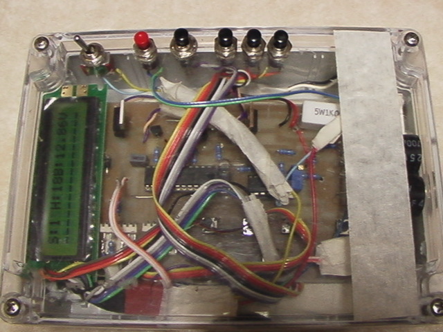

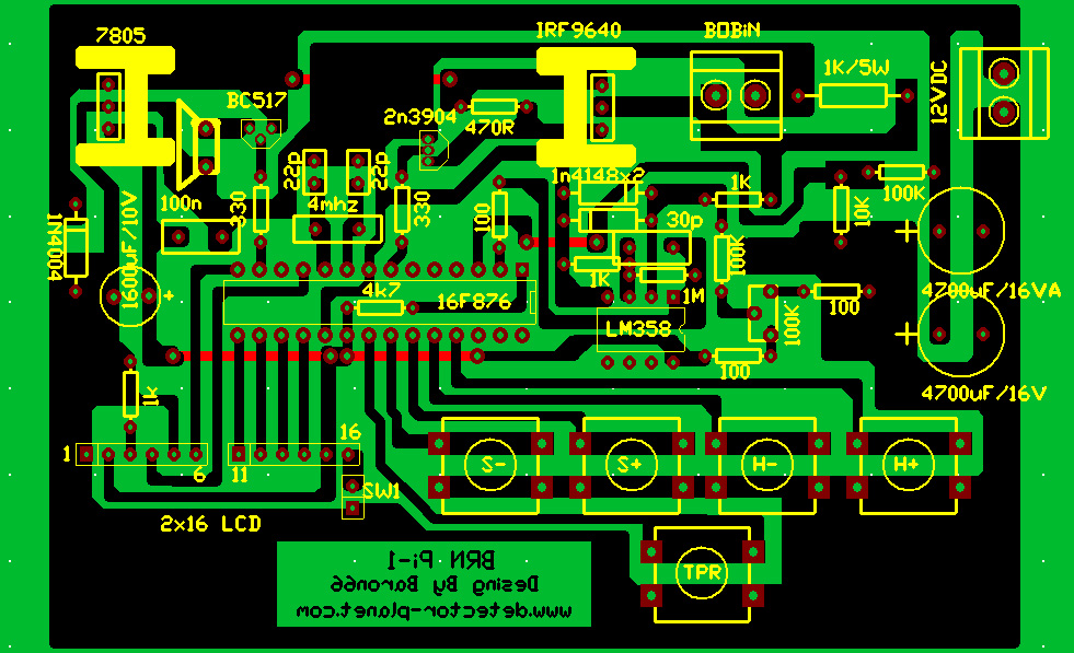

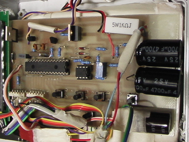

I have just finished building the BRN Pi-1 DİJİTAL Pİ...it is very easy to build.In its original form its not very powerful ,with an 18cm coil it detects a 2.5cm Australian coin from 20cm and with the 32cm coil it detects it at 30cm...However I have been fiddling around with it,according to the designer Baron from www.detector-planet.com it is open for further development and can be developed further and modified so that it is more powerful and has a lot of potential.

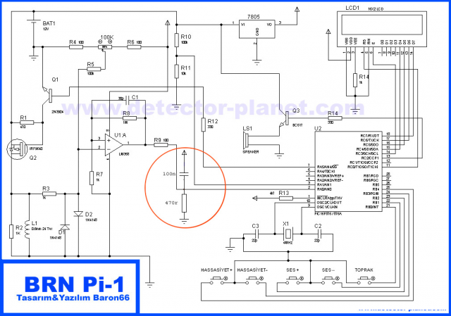

While I was tinkering with machine ,Baron advised me of a mod to addon that will help reduce some unwanted noise.When I did the mod initially I did something wrong with the way I wired it up and when I turned it on I couldnt belive my eyes .it was picking up the 2.5cm coin with 18cm coil at 40cm clearly and fainty and dyeing out at 50cm which is awsome .My problem is right now that when I went to tidy everything up and make every thing permanent an neatto finish it off I then did the rewiring and this time I wired it the correct way as Baron described it and it is still picking up weak ,so whatever I did wrong in the first place was amazing and I am trying to remember what I did and when I do I will post it...
Any help in further developing this machine will be very nice
