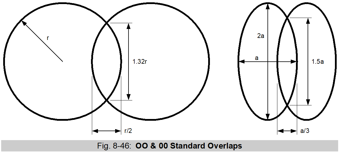

                      On p159 the left-hand drawing should say r/2, not r/4:
