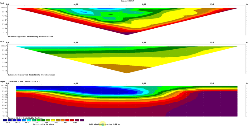

I have made a geophysical Resistivity imaging system working with 16 electrodes that gives a about 15 meter underground image.
this device gives you the underground resistivity values through lcd monitor attached with it.
it gives you about 120 values for the underground survey.
and you entered this values into computer software manually to produce the underground image.
and this values changes automatically using an internal processor.
this is a samples of underground imaging for my device :
this device gives you these underground survey just in 8 minutes.
this is a picture for possible underground buried room.
and this is a picture for empty of targets land :
and this is a picture for underground buried room:
and this is a picture of underground very big stone
