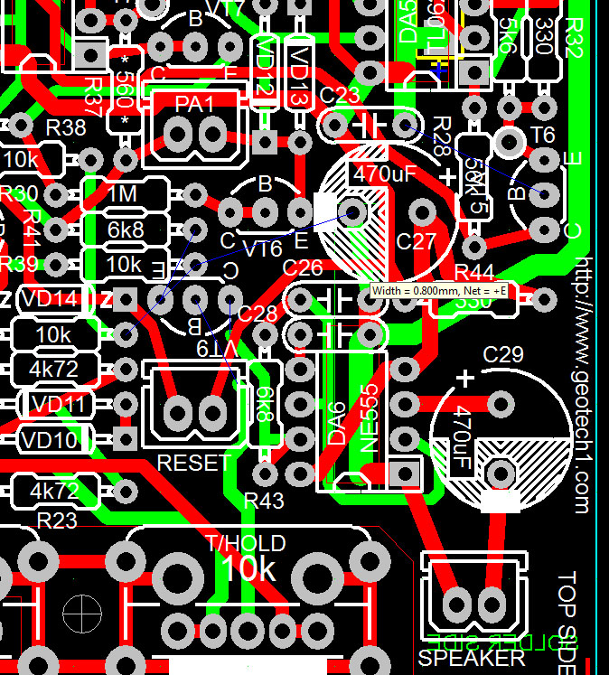

i almost remake the layout and order will be in near time, before chinese new year i hope. i do some change pinplacement of transitors on all-in-row. thats good if you use desoldered transistors with short pins. also i do isolate copper pouring under MOSFET because if you set MOSFET without isolation there will be connection of DRAIN to +E.
