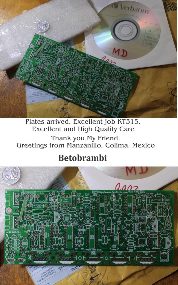

        KT315 Hello, how are you? I guess well, it shows that you are concerned and I appreciate it. Indeed, the board came to Mexico.
        You are on the Postal Service, however, I would not have it handed to me.
        I guess tomorrow morning, deliver me. Now I'll tell you how everything goes.
        I send you a big hug and I are in touch.
        Thank you my friend.

          Now I have to find the pieces (here in Mexico is difficult to find some pieces) and put it together to see if it works.
          Now I will inform you of my progress. While leaves can tell you a lot to give me counsel.

            Heriberto,
            I am glad the board has reached you. have a fun with it
            follow what I tell about right shielding of housing in DP thread, because IMO the shielding is important matter for the stabile work of DP.

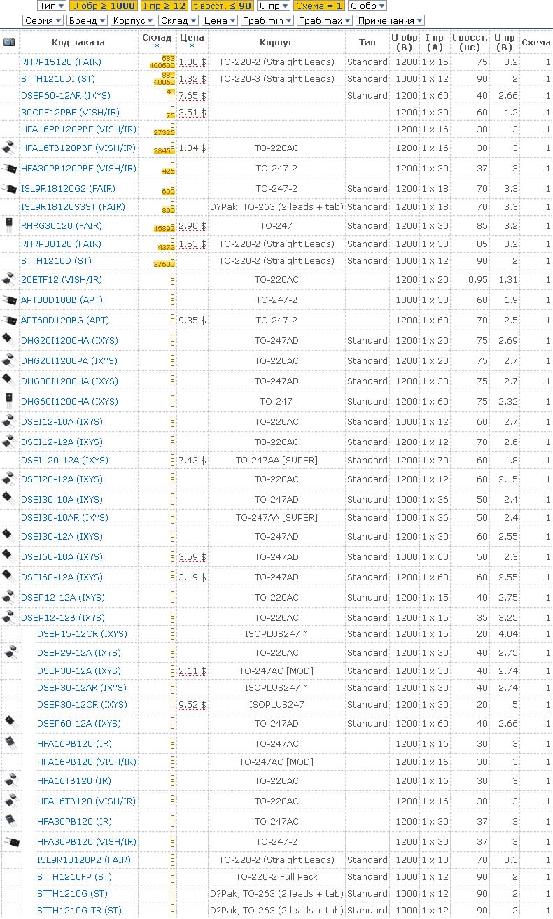

                      Hello kt315, hope you're well? Sorry, I have trouble finding the following components (zener diodes) ...
                      VD14 1N756
                      VD15 STTH1210D
                      What is the replacement?

                            Hello Heriberto, 1N756 is Zener diode on voltage 8,2V. you can change it on any 6-9V Zener diode. chinese diodes are marked '6' - this is 6V,
                            '9' - this is 9 V, '8' - this is 8V. they are not to be marking like something '1N756', they marked by the voltage.
                            if you can not find the diode then stay a resistor 100 kOhm in this place.
                            about VD15 STTH1210D. open folder on DVD you got with PCB 'Delta Pulse Sniffer XR-71' then open folder 'diodes for Delta'. in this folder is all information on the replacement.
                            if you can not find the diode stay then nothing, in this place solder a wire jumper. Click image for larger version

                              I checked on my PCB DTV56F diode that used in CRT monitors and TV's (CRT HORIZONTAL DEFLECTION, HIGH VOLTAGE DAMPER DIODE). it is on 5-10A, slightly warm working.
                              DTV16 DTV32 DTV56 DTV64 DTV82 DTV110
                              DTV56F.pdf

                                The problem is that VD15 STTH1210D has 2 pins ... In the electronics store I got 2N6073A ... No I have CRT and threw or gave away .. tomorrow I'll go to the store to find T0-220AC ...
                                They also sold a diode black 6A6 DC...????? that is unlike anything I say.
                                I read the file and DVD Sniffer
                                VD14 1N756 ---- 8.2V 1N4738 ... In the case of VD14, I have in my components, the 1N4732, 1n4737 and 1n4739 ... but ... I do not have 1N4738... morning I will go to the store if they sell ...
