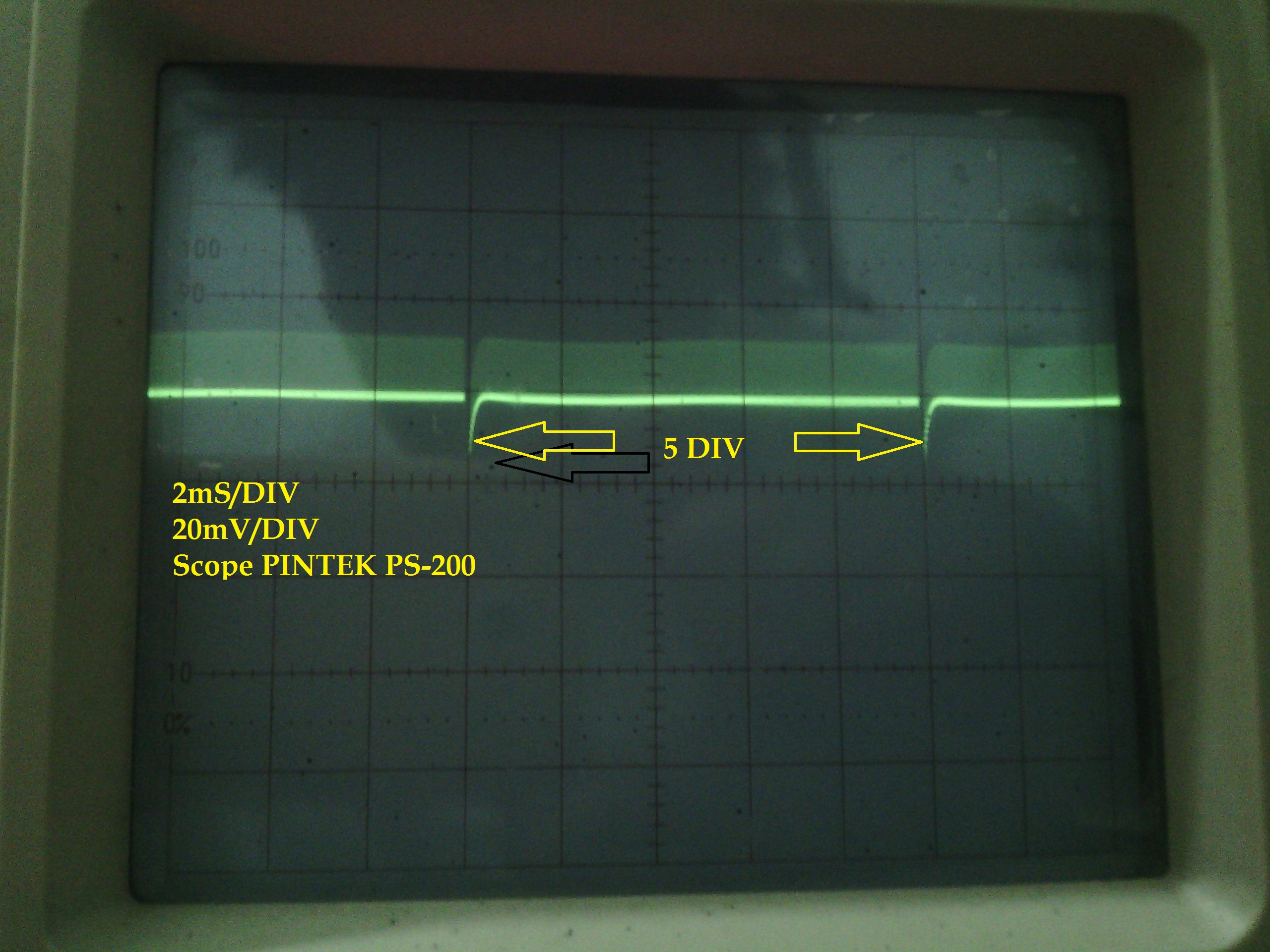

          This i see on 2mS/DIV. Click image for larger version
          I am unable to understand it.
          This i see on 5mS/DIV. Click image for larger version
            ......do not ask me how control by your car if i'm on back seat of it and you are driver.
            This is a confusing signal. No harm in asking for advice. BTW you ar not on the back seat. Be a good navigator.
            • bad. i think you see a clog on signal from your converter. i do not see the signal itself here.
              you have to see rectangular impulse with approx 10V amplitude.

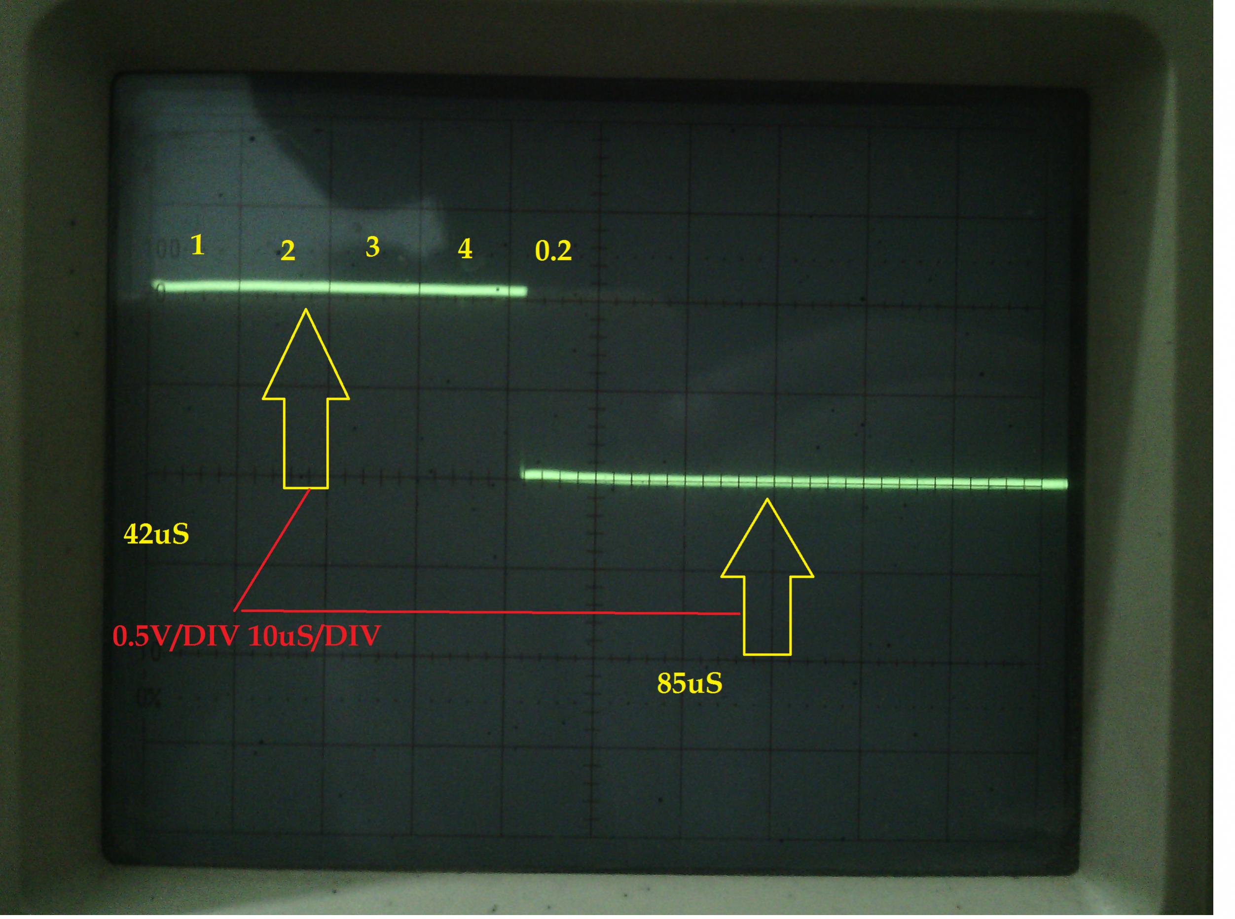

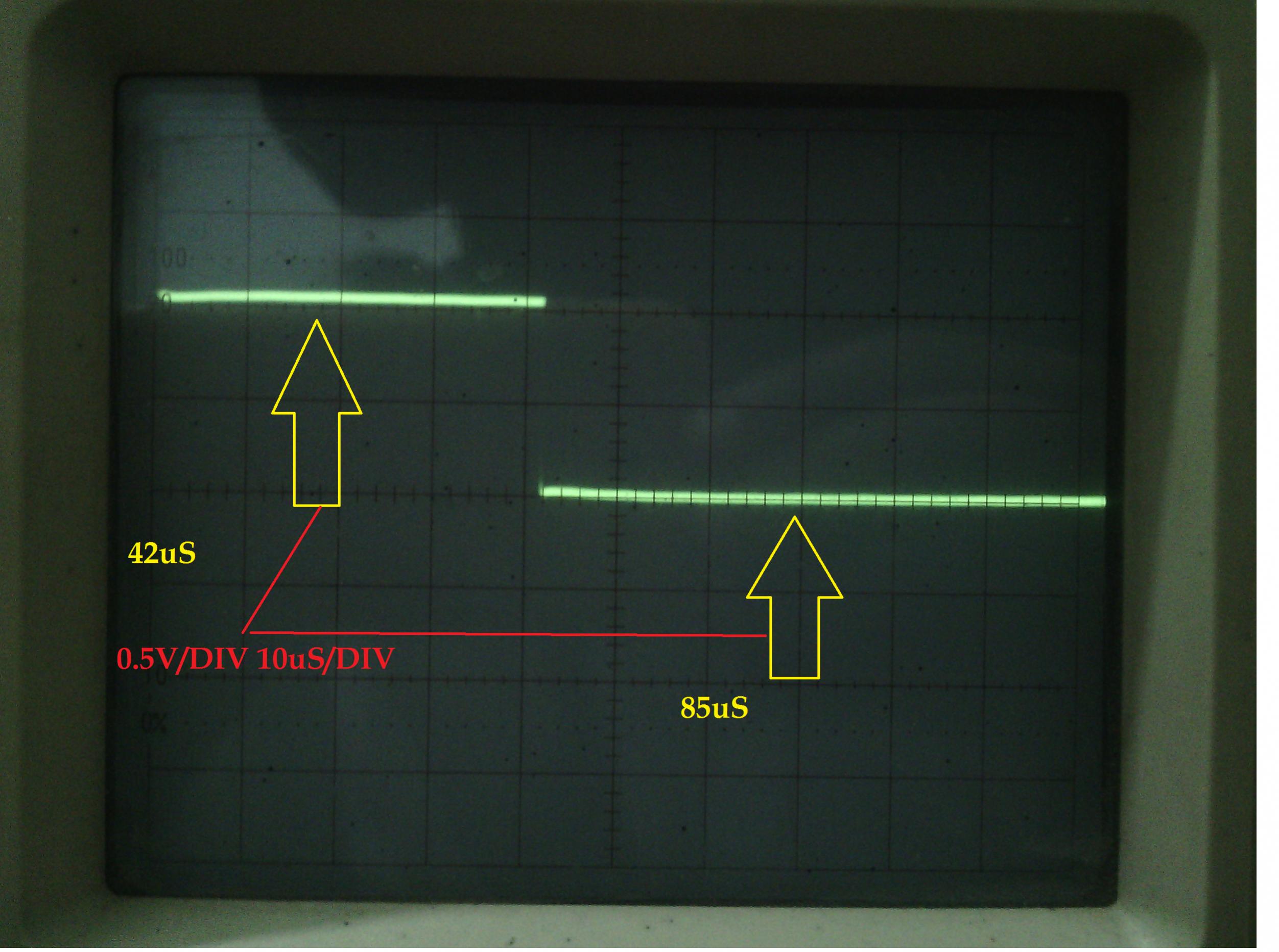

                Now on 0.5V/DIV 10uS/DIV i see this for T4 and T5 . Click image for larger version
                Pulse width of 42uS??
                • just one Q. why WHY you did not see THIS signal right on i asked you to give it?
                  ok. good. thats all on today. enough.

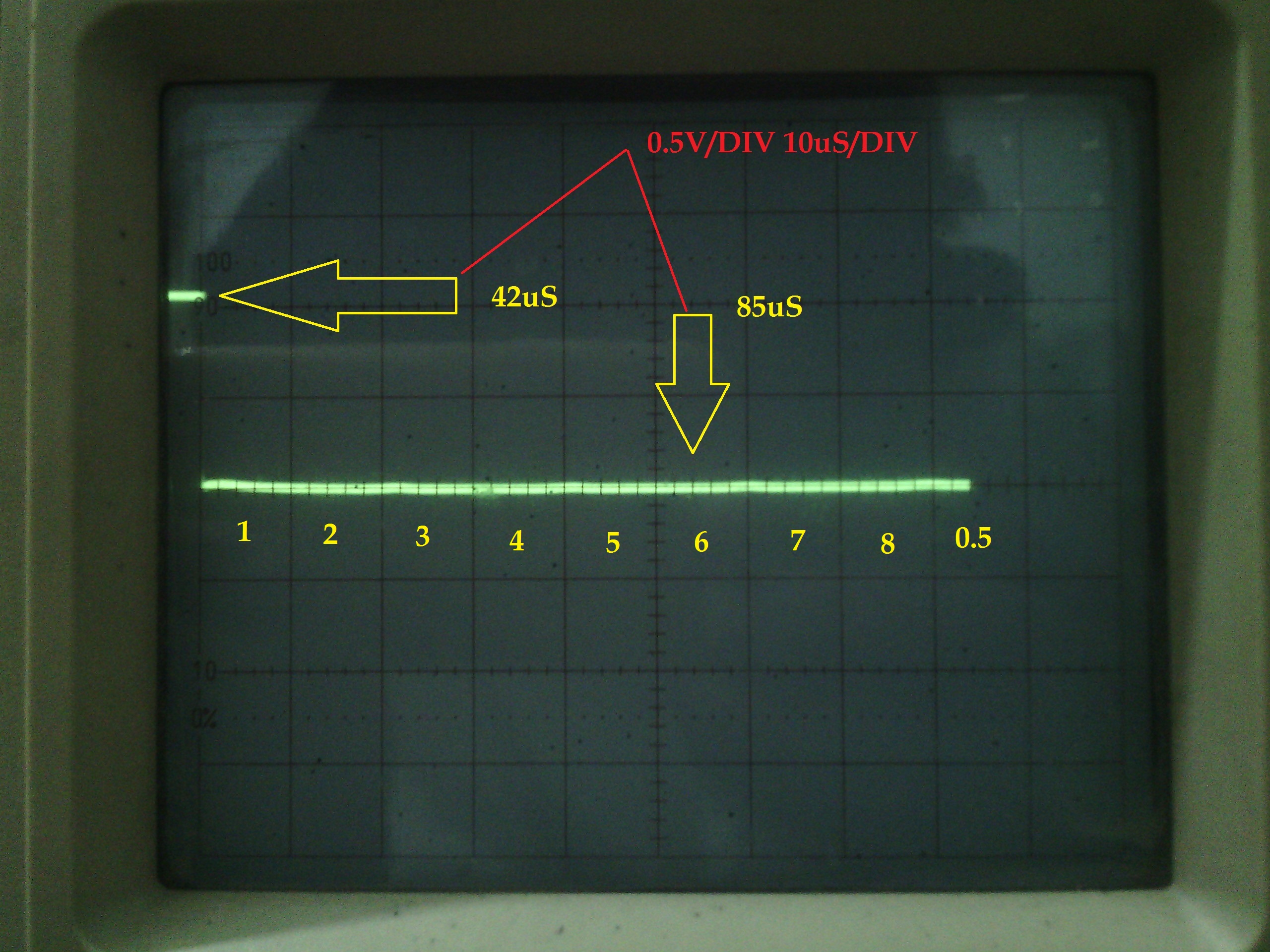

                    The width of other signal is 85uS on T4 and T5 Click image for larger version

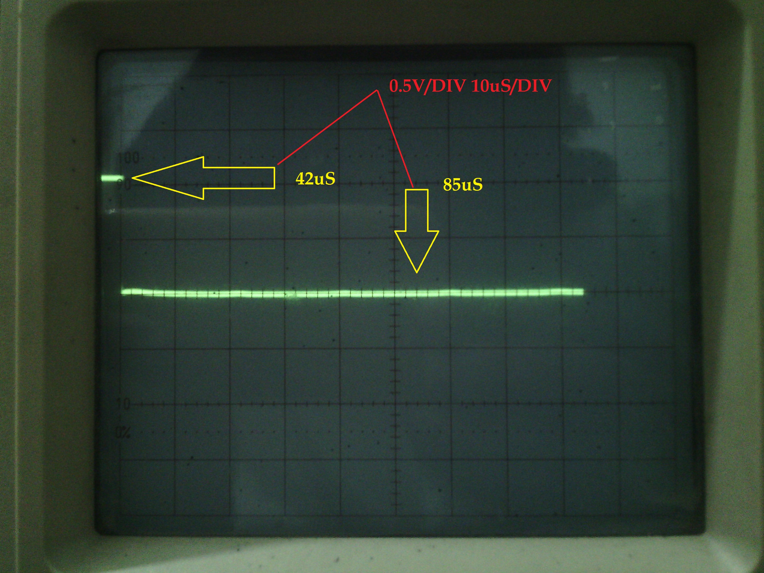

                    • scale? uS/DIV?
                        scale? uS/DIV?

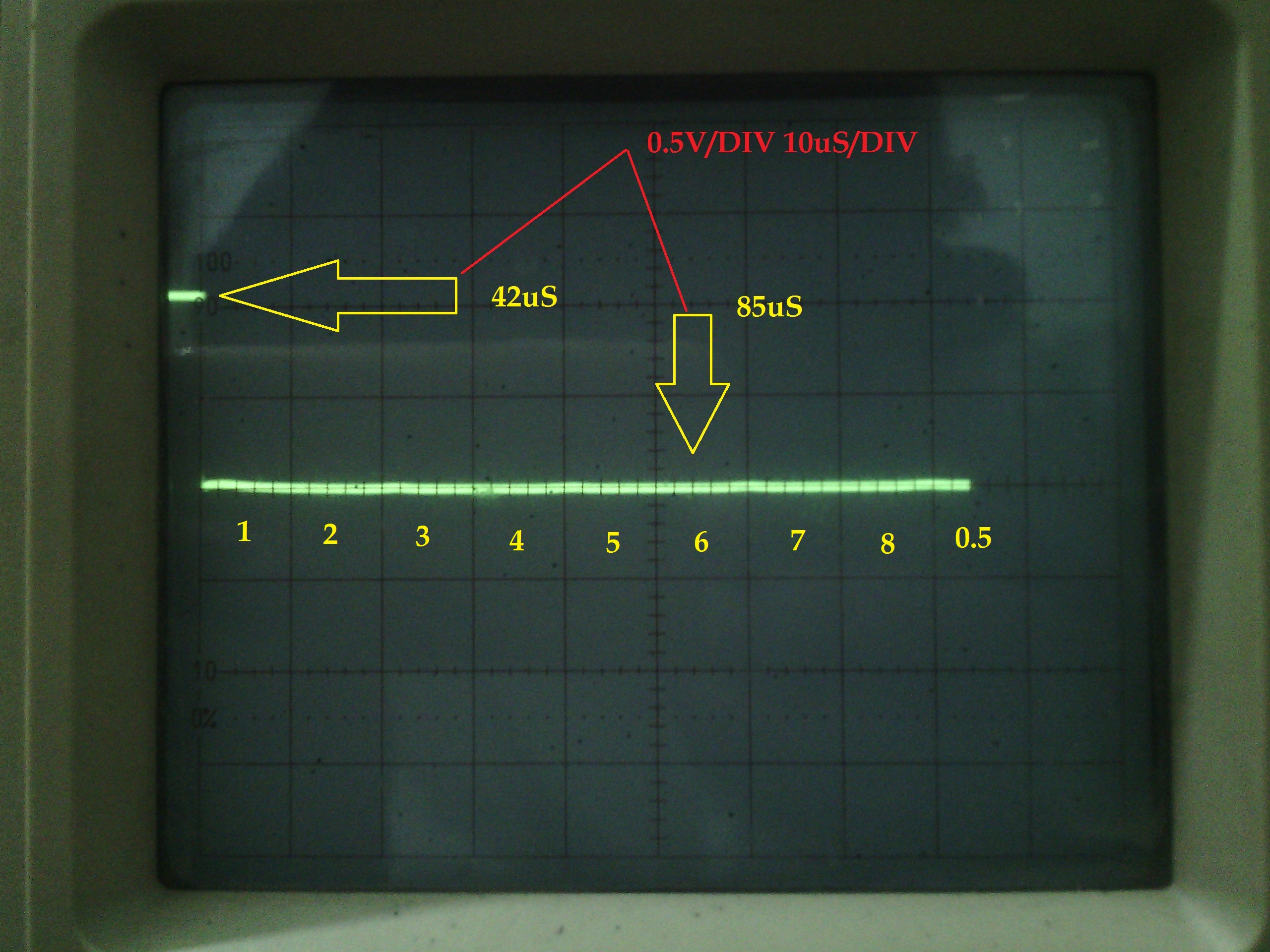

                        • you have to see whole period. click timing scale on 2ms (MILLI--).

                            See new photos in my previous post. Click image for larger version
ID:	355353 Click image for larger version
                            Whole period 42uS + 85uS = 127uS ??
                            • practical guide you ask. waste a time to read it.
                              • Whole period 42uS + 85uS = 127uS ??
                                this is just your fantazy period. our period has to be sure 10ms. 10ms gives us clear 100Hz frequency.
