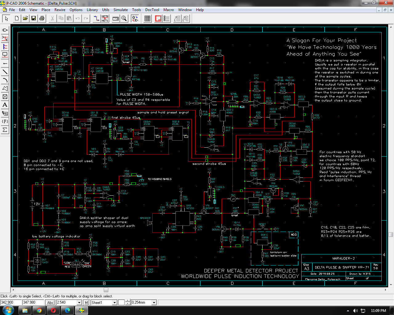

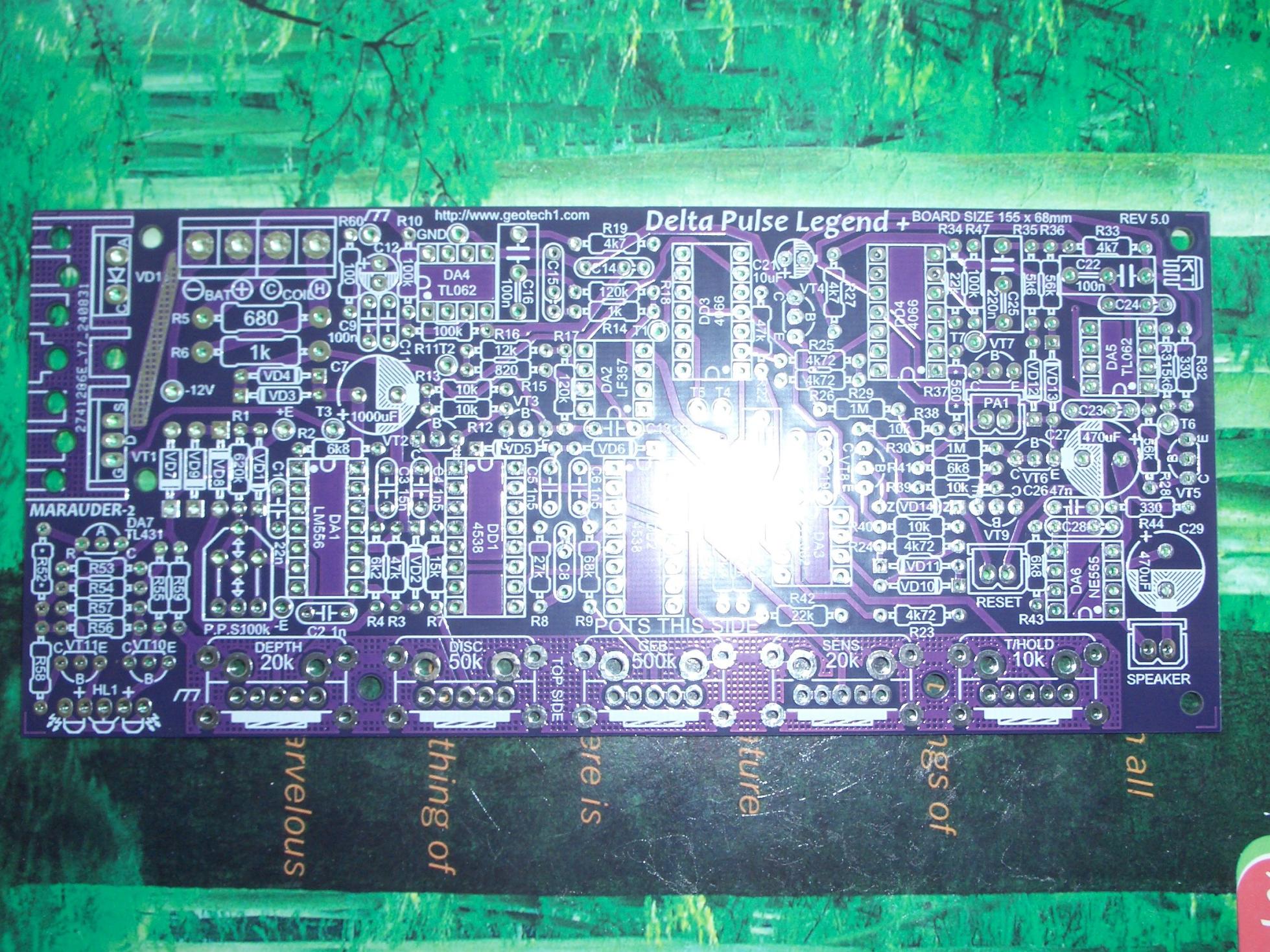

    • Does the PCB also comes with the schematic that matches the PCB?
        sure.

                  The drawing is beautiful.

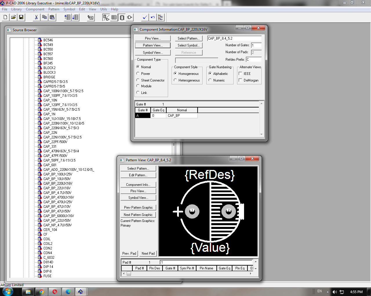

                    file of/from Library, made by me...
                    .lib
                    Click image for larger version  Name:	image.png Views:	0 Size:	135.7 KB ID:	429057​
                    • a file .sch, schematic file.

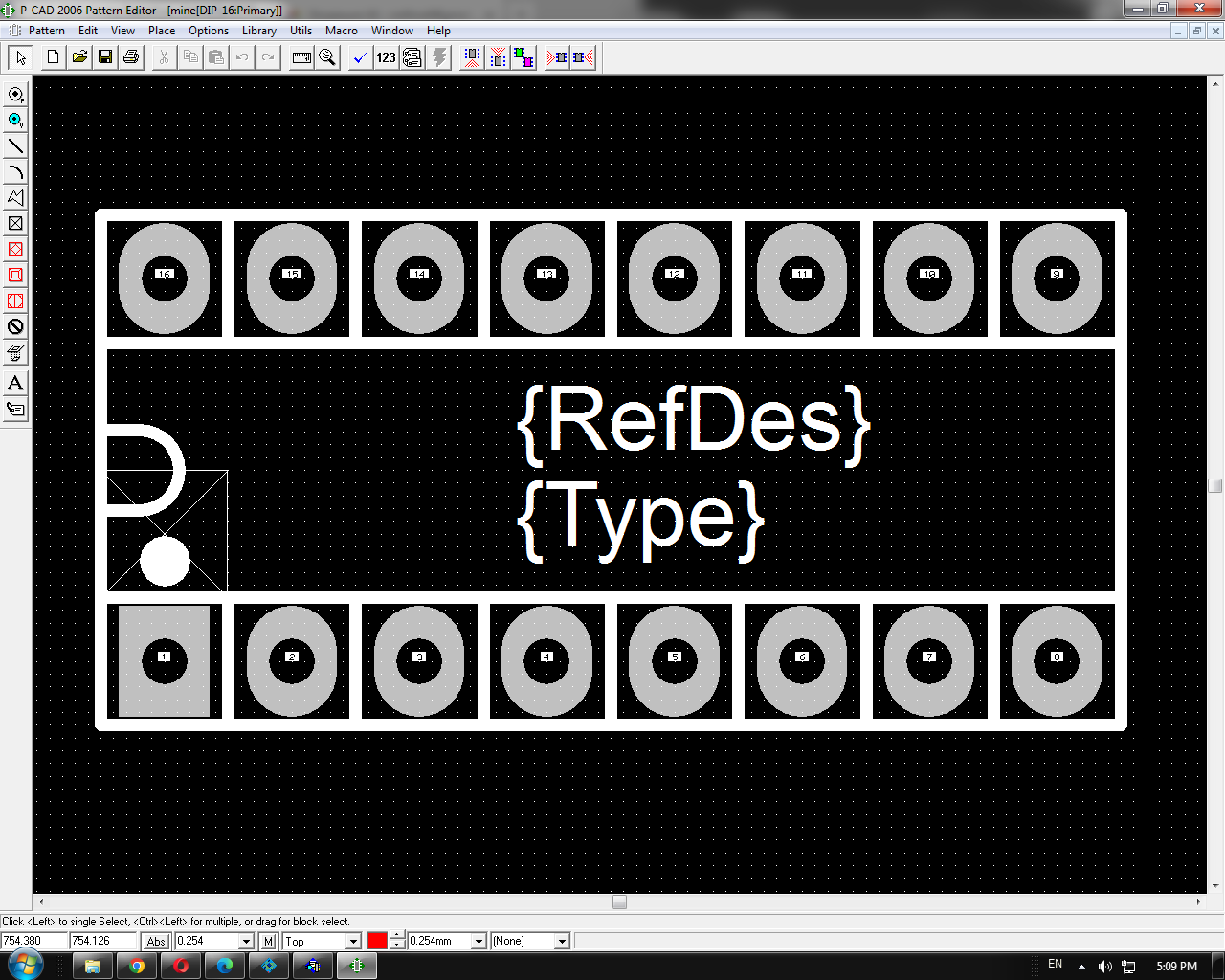

                      • 4538 in Pattern Editor, just for example
                            Thank you .....I understand that you are not interested in secrecy.
                            Спасибо
                            Я понимаю, что вас не интересует секретность.
                            И ты щедрый.​
