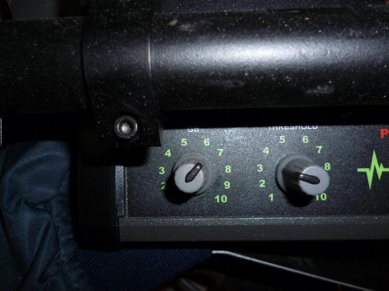

    thats not bad considering only 10.5" coil...just wanted to ask why your circuit draws over 300 mAH ???? also are you the designer ???
    Hi no not the designer, just a field tester in Australian gold fields.
    • #47
      On how GB set ?
      For how gives a red brick ?
      Hi I am not certain of your question but for the testing,
      the GB was set for balancing out the ground from one of the goldfields here in Australia,
      it is set for just under 7 on the scale.
      I do not have a red brick to test the GB, I will try and get one to try.

              Yes that's it between 6 and 7 GEB and eliminate red brick .
