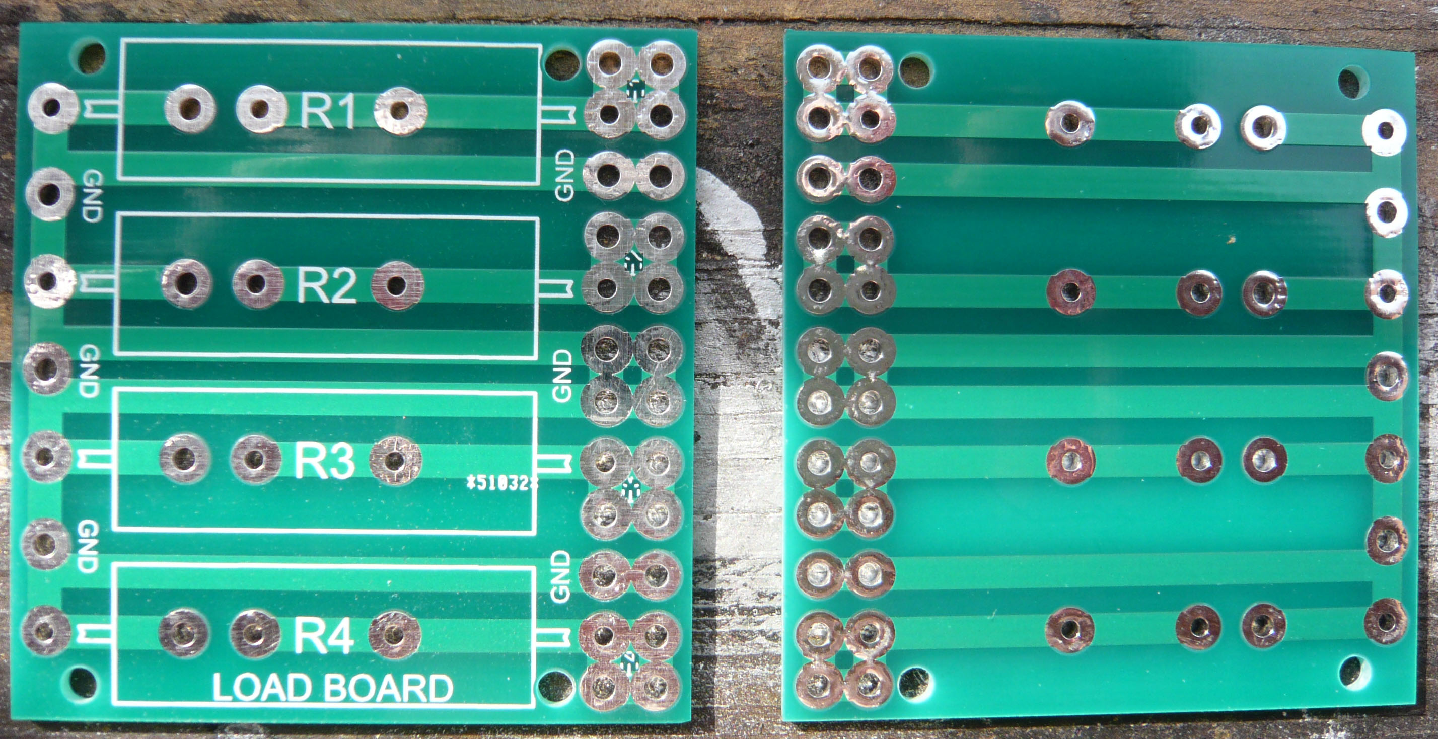

    good for any impulse power supply if you need to get it working right. done under all types or resistors, vertical or/and horizontal. max number of outputs is 4.
    price is 2 euro if you buy any board from me.
    i again get a request what is loading board. you have some impulse power supply (PS) with several outputs (read my topic TRASH TECHNOLOGY). but you want to use just one output, for example for DP it is 12V.
    but left outputs are not loading, they are free - not connected (N.C.). PS either will not turn on or will working in ciliary mode.
    you have to load ALL outputs, then you get normal work of PS.
    how to load... by what resitors values... on your choice. calculate 0.25-0.5A for 1A output, 1A for 5A output, just example.
