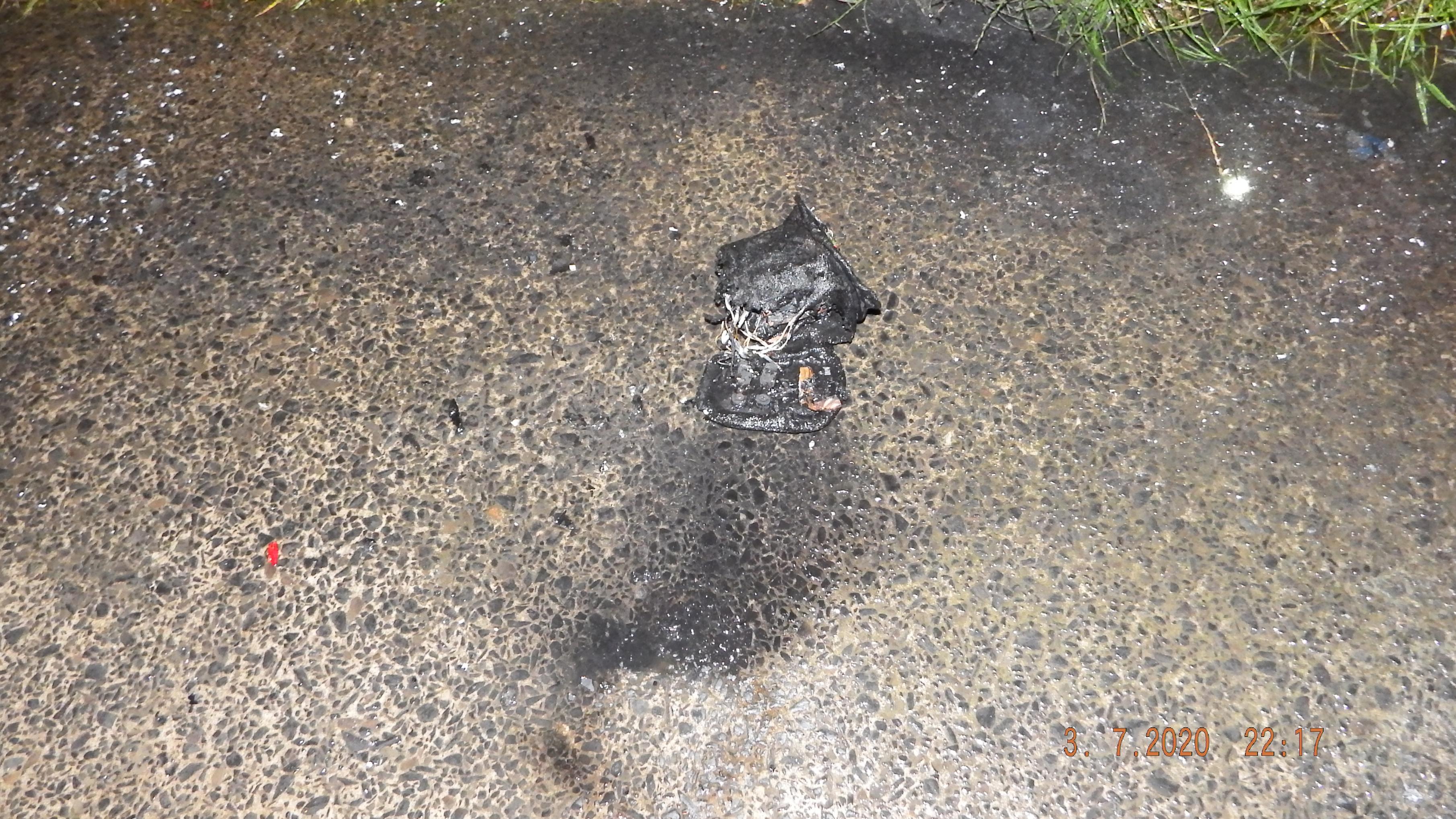

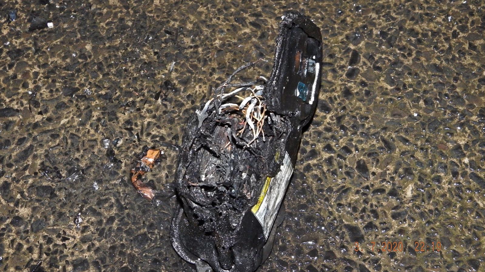

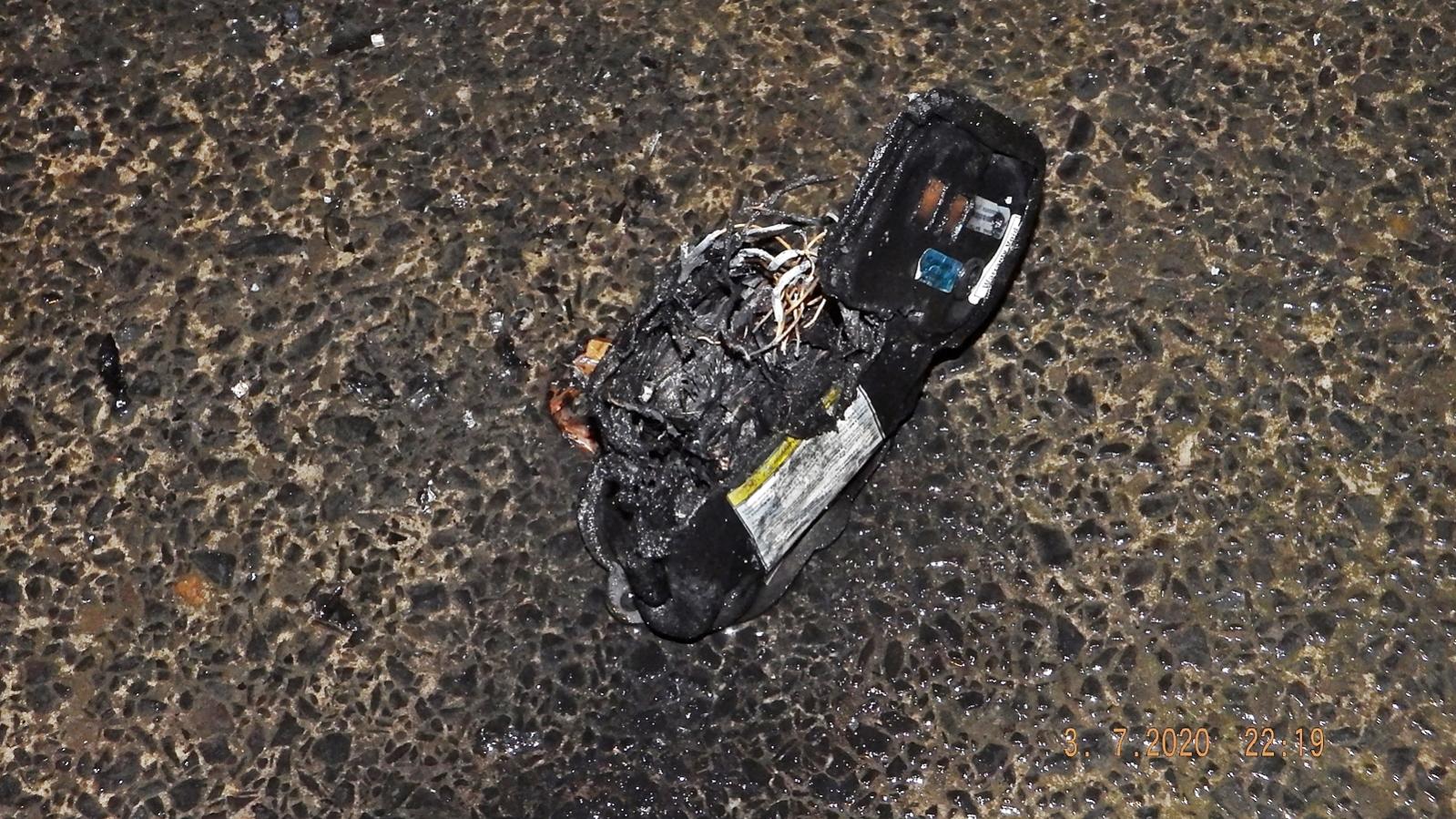

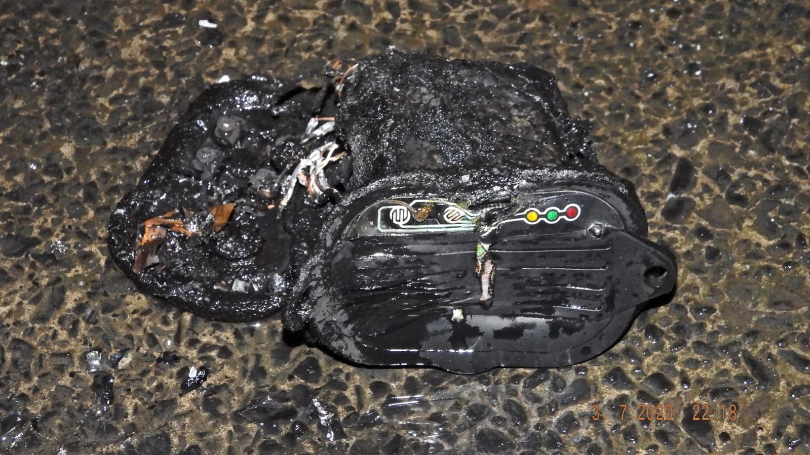

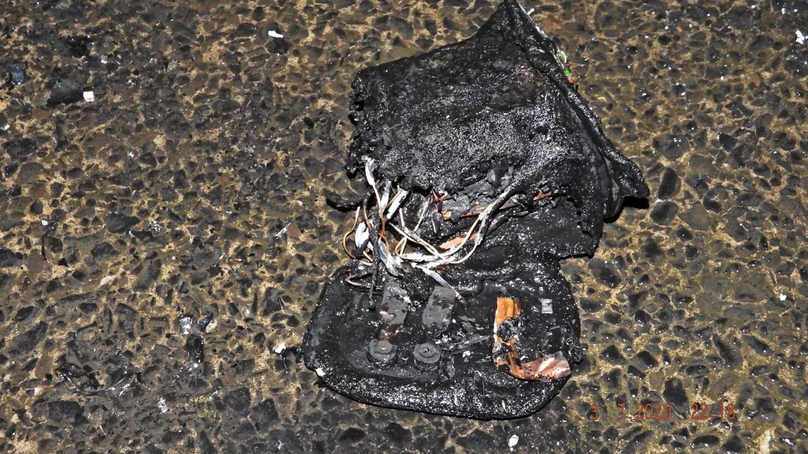

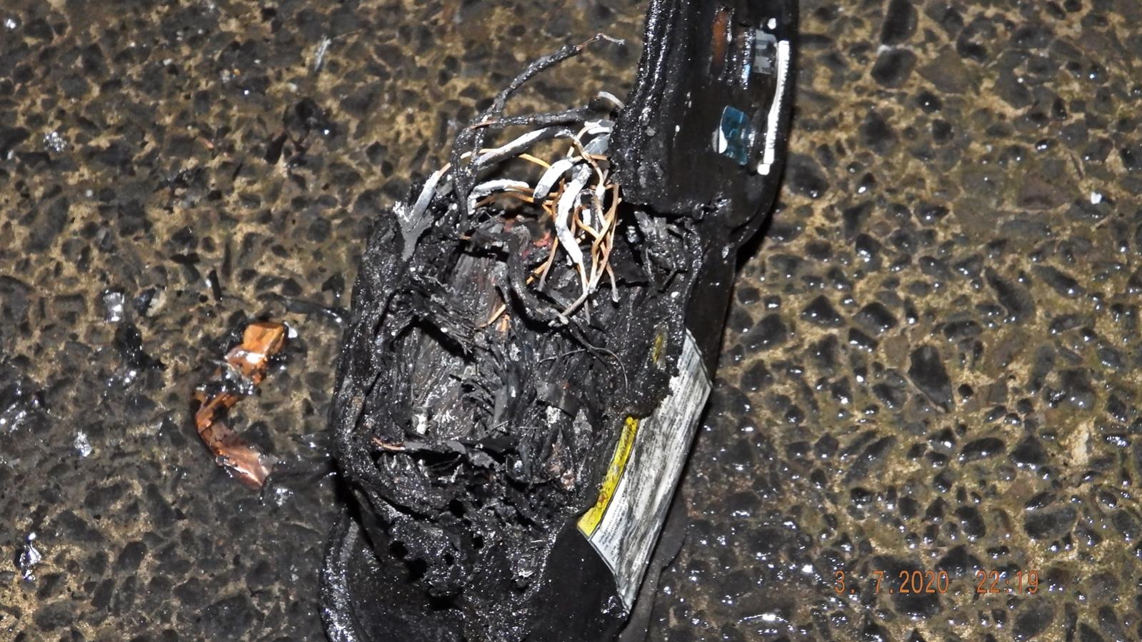

          i would but the battery did not come with it's original charger. also the battery blow up. the battery had been modified by the previous owner. i had been having trouble trying to get the battery to work all the time. i was provided with a imax B6AC charger for charging it. but two nights ago when i was trying to charge it again. i checked on the battery after it had been charging for a couple of hours and i noticed that the battery wasn't looking right some how. when i checked it over it was swollen at the sides. i then heard it starting to hiss and thought that sounds like it is going to leak or something. i went to take it out of the living room.
          i got just out off the living room door with it and i saw smoke starting to come out of the battery. so i quickly opened the front door and it was starting to smoke more. i quickly put it on the path in front of the out side door. i stud up and the battery blow up in to flames. my god what a flame it was as well. huge it was like a rocket going off. it actually blow up twice with masses of black smoke. scared the life out of me. if i had been holding it for a second or two more i would of been really badly burnt. or the house would of been on fire. it took ages for the thing to stop burning/smoking. i was throwing large dish after dish of water on it.
          i can not stop thinking. if i had left it for a minute longer to charge and because of the way the battery blow up. i would of lost the hole house. there was no way i could of done anything with the huge flames that was bursting out of that thing.
          here is some photos i took of it after i got it to stop smoking.
          P.S. i have bought a new battery from off line. i just need the charger to go with it now.
            Very impressive! This is why airlines are so nervous about lithium batteries. When they go, it's pretty spectacular.
            For a 14.4-14.8V battery pack you probably want an 16-18V charger @ 0.5 - 1 amp. The battery pack should have a charging circuit built into it to regulate and monitor each battery cell.

              In 30 years, some treasure hunter will find the remnants of your battery and trigger suspicions of an UFO drone landing.

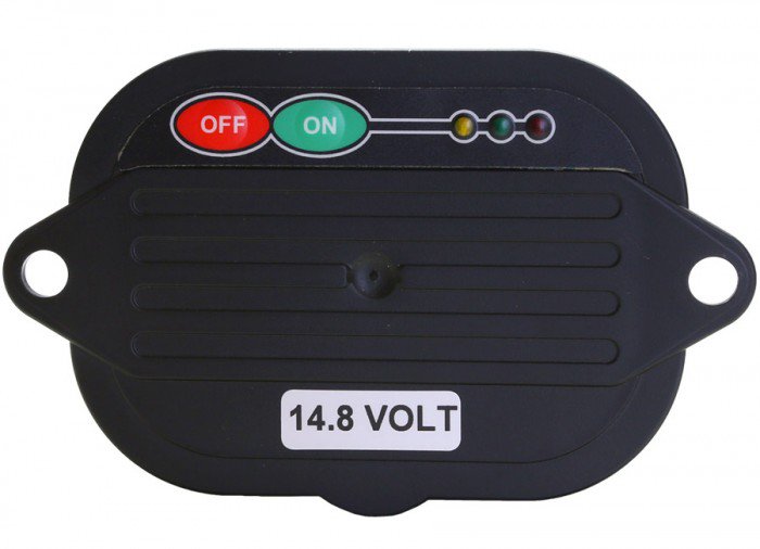

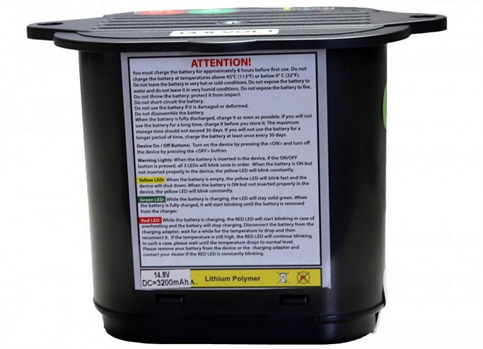

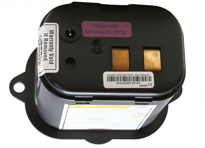

                      here is some pics of the battery from off the website.
                        It looks like the battery is rated at 14.8v 3200mah. It would take a little over three hours to charge at 1amp. I was wrong in the last post the Tenergy charger(2nd link) is 1amp. Same as the Nokta. The no name in my first link is 500ma with a six hour charge time. Either would work.
