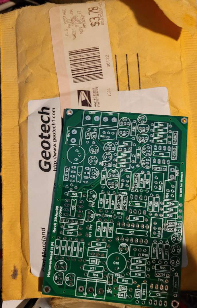

                  Found it Carl !Click image for larger version
                    Wow, that goes way back.
                      is there any data on it... where would I look ? it your address on it lol well PO box
                        Originally posted by David_1 View Post
                        Found it Carl ![ATTACH]56820[/ATTACH]
                        Hammerhead details are here (from Rev C upwards) ->
                        Older revisions are here (from Rev B1) ->
                        Your PCB is Rev A, but this still might be useful.
