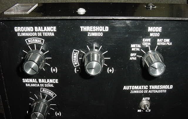

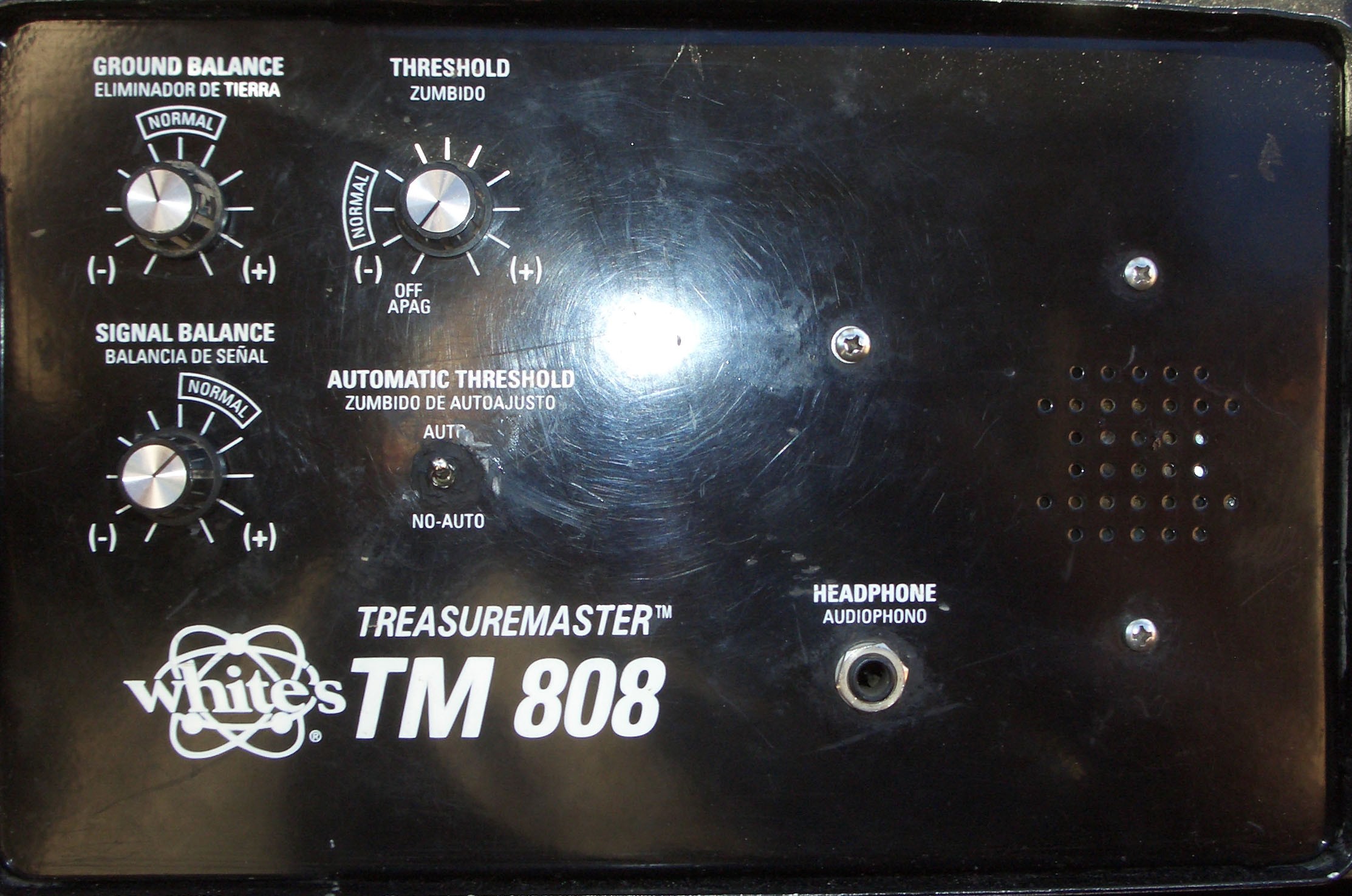

also, i have to add. there are 'earlier' TM-808 and 'last' TM-808. in last one Whites deleted CAVE mode (the switch) from the housing. so if you are seeking with CAVE mode you have to know the fact.
i put pics.

The White's TM has a confusing history. I believe the TM600 was made by Karbowski (his company name was "3D Electronics") for White's. Then Karbowski licensed the design to Discovery who made the TM800 for White's. Then White's decided to do the manufacturing themself and created the TM808, which was identical to the TM800/TF900, including the TR Cave mode. Discovery complained about White's using their design, so White's redesigned the TM808 to use a CM6000 circuit and dropped the cave mode. So there are 2 different TM808 models, with and without cave mode. If you get the one with cave mode, you are getting a copy of the TF900.
sorry, not. So there are 2 different TM808 models, with and without cave mode. If you get the one with cave mode, you are getting a copy of the TM-808 that has CM6000 circuit's Disc mode.
also, TM-800 is TF900, circuit is same.
Yes...I know that, KT. The one I had included cave mode. Without Cave mode, a TM-808 doesn't help me much over the TF units I have, for what I'm doing. That iron Discrimination, in cave mode on the TM-808, really helps in what I'm doing. I bought a 6000 XL Pro (waiting on arrival) and am going to do some experimenting with that unit. It Also runs at 6.59khz, but has all the features the TM-808 lacks. I/m going to see if I can put separate Trans/Rec coils on it. Might be interesting. I'm going to need help from you engineers for that project. I thought I might use the coils (antennae) from an 808 , or TF unit.Originally posted by kt315 View Postalso, i have to add. there are 'earlier' TM-808 and 'last' TM-808. in last one Whites deleted CAVE mode (the switch) from the housing. so if you are seeking with CAVE mode you have to know the fact.
