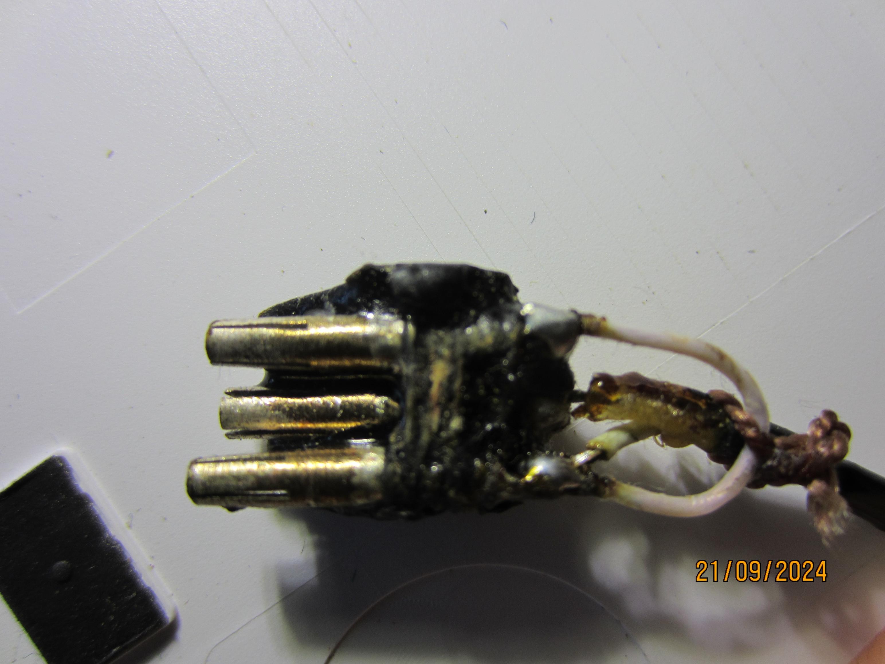

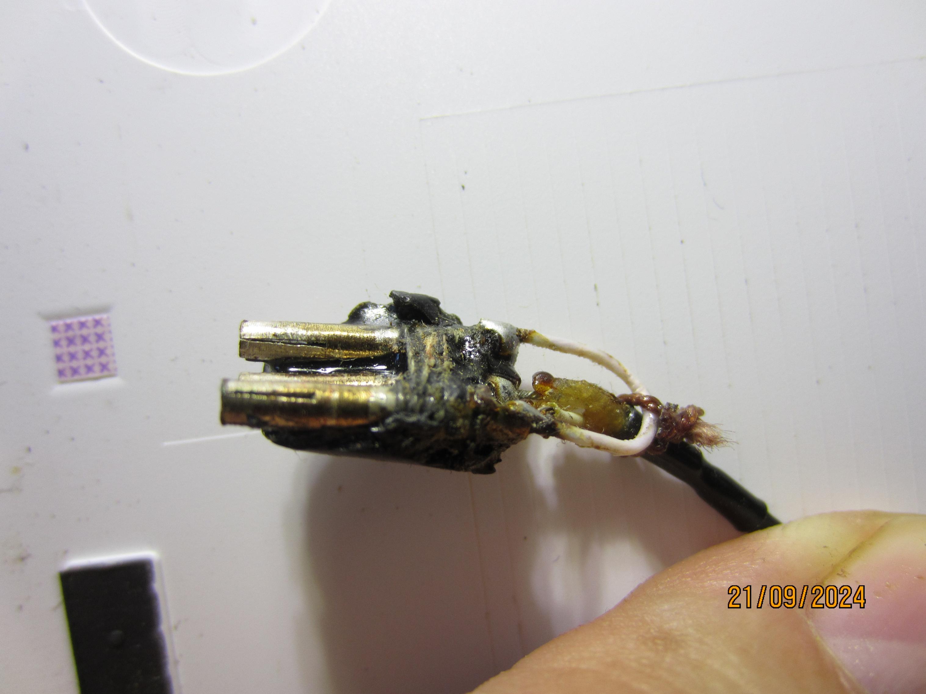

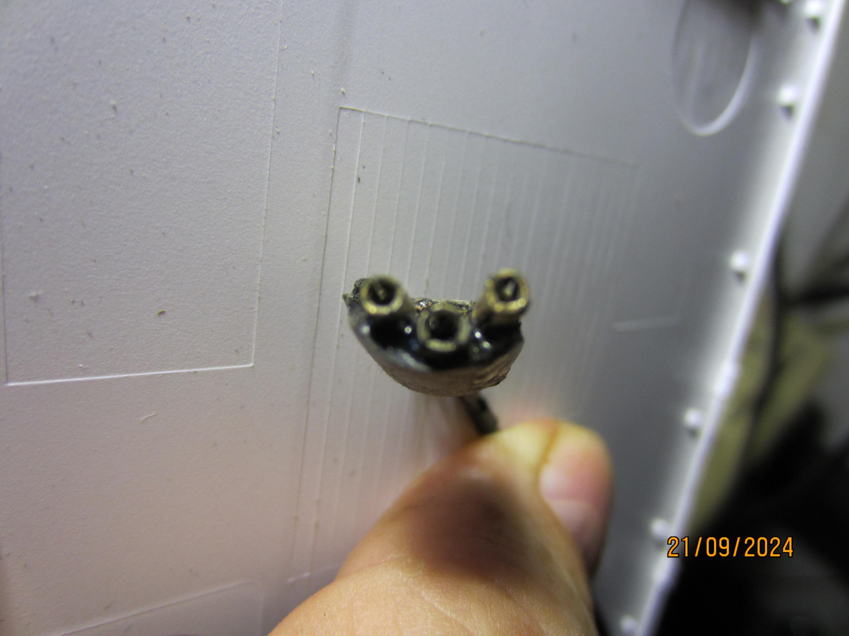

                  Guys, Amigos...
                  Do not ask me about Pulse Star. I got it one time in a repair and had not a time to research it long. WITHOUT COILS,
                  i did erzatc socket female to connect mine made small coil. epoxy qlued. I do not know the type of sockets in the detector. not be agenda for me then was.
                  yes, there must be a jumper, Ivconic answered me on the matter.
                  pleasure
