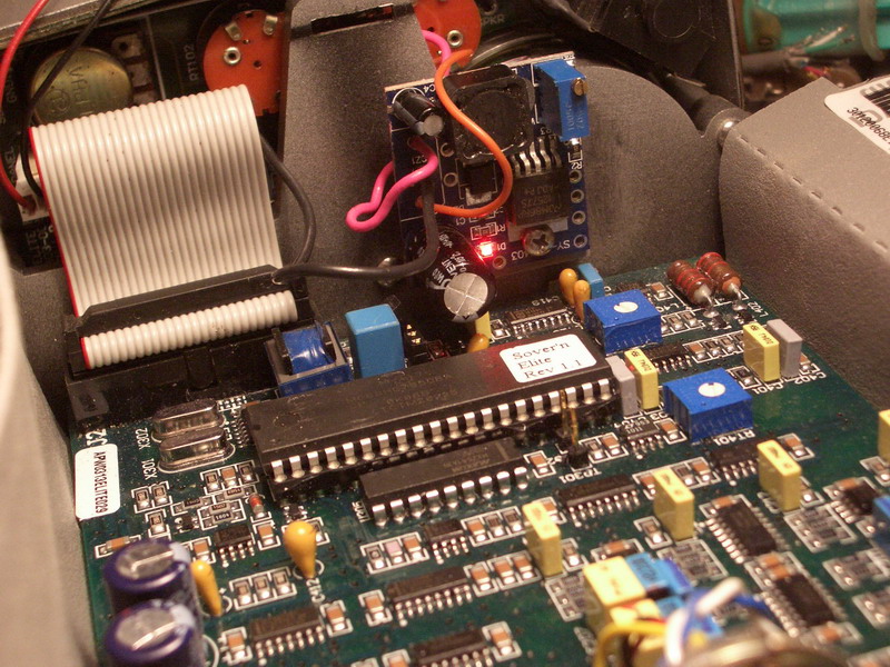

    Hi all Geotechers,

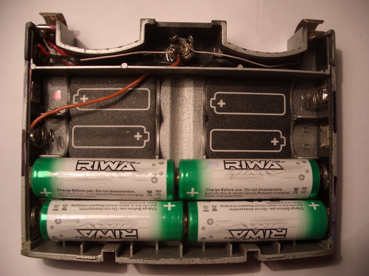

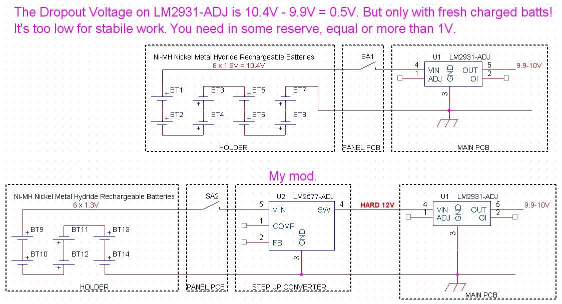

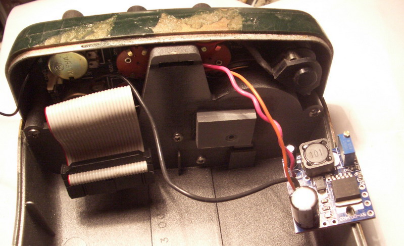

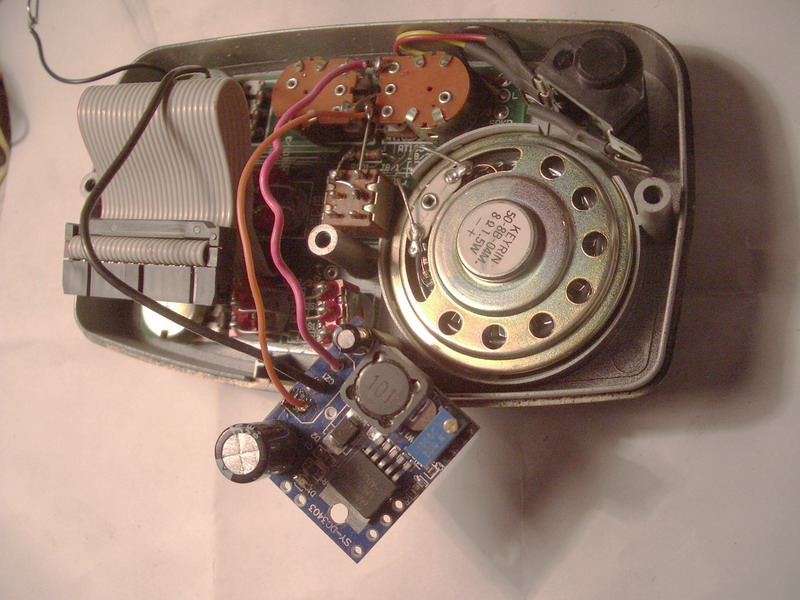

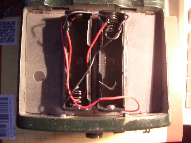

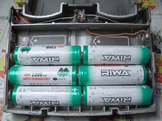

    you will get a mod you see at photos. with the mod your sov will work to be stable with 4, 6 or 8 AA or another tipe of sells from now. you will not be needed necessarily to use original necade battery pack. I stand additional connector for charging on batt pack and additional power switch at box too.
    best regards,
    Anatolij
    tested all day. on 6 pcs AA. their was too stabile and I did not touch THRESHOLD every ten minutes.
      the holder with 4 pcs AA batt. I was working all field day on it.
      have a nice day there

          the mod

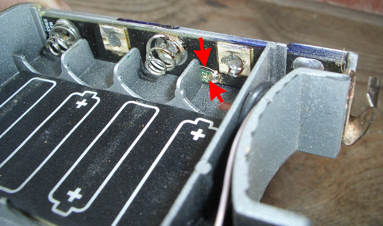

              if you did set a connector in the batt compartment for a charge and are charging by the way, there is still one important thing I have to tell about. you can notice smt fuse resistor on a side PCB (look at photo). it is greatly limiting the charging current. simply connect it by wire jumper.
              best regards

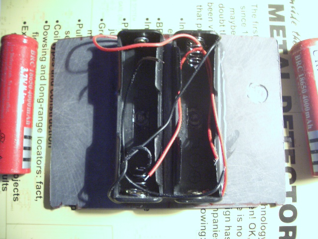

                            a housing I do for 18650 Li-ion cells.
