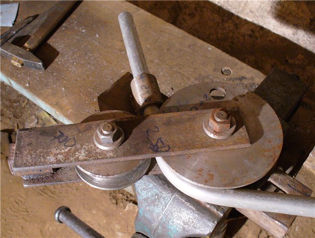

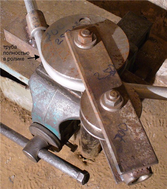

          I think round tube is better too, you can bend it easily with plumbing pipe benders and there is more choice in diameters to fit one tube into another.

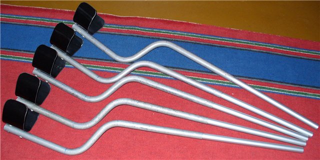

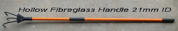

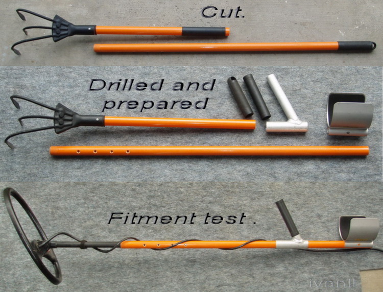

          A three piece stick is good, arm cup and battery holder at the top for balance and the electronics fixed just after the S bend, another tube adjustable in length which goes down to a none metalic section (about 50-60cms) at the bottom, carbon fiber or fiber glass fishing rod tubes are not bad
            a stem from TREITI
            http://www.treiti.times.lv/master/stanga.zip
              simple technology from ULF
                straight shaft from somebody of findmall forum

                      i took this pix from findmall forum.
