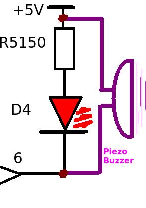

    I also took the oppotunity to add a piezo buzzer (+5V type from Murata) across D4/R5 to provide a quite loud audio response when a metal target is detected.

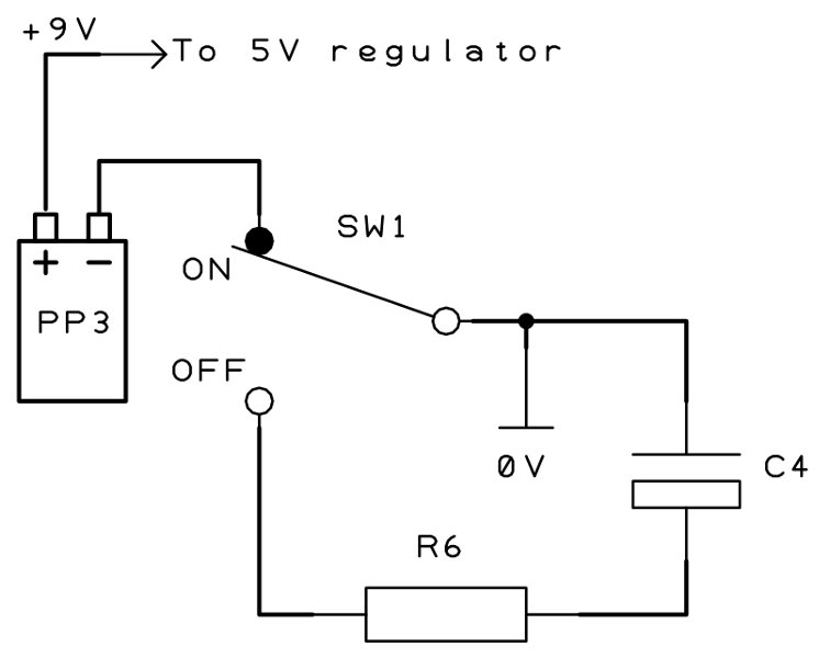

    One final modification I made, in this second unit, was to replace the original DPDT switch with an SPST type. In this case the -ve supply from the battery is switched, and the center pin is connected to 0V. This then allows C4 to be discharged via R6 when the unit is turned off, thus resetting the threshold. Please see schematic below.

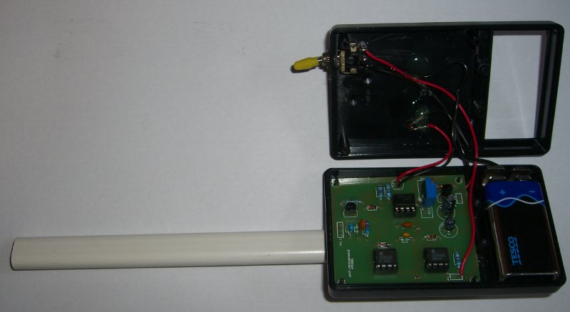

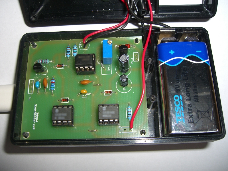

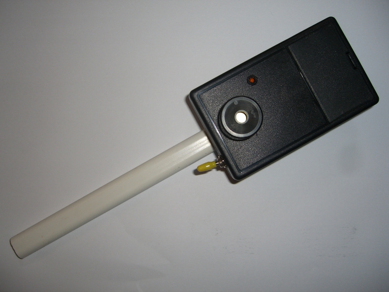

    Here are few photos of the completed unit.
Name:	SPST switch.jpg

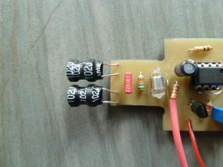

          I also bought the very interesting book. (My compliments to the authors!). And I built the pinprobe (p. 33) Unfortunately, the small device does not work. Too bad. I suspect that the coils do not work. How can I check that? (I'm electronics novice). Thanks for a tip!

              Hi Qiaozhi
              Thank you for the quick reply! Yes, I'll replace R1. I have 2x RF Choke 1mH used as described in the book. I have all a question: Is it allowed a picture of my PCB to show here? I have developed an own PCB according to the plan on page 38th With the "Sprint Layout". Thus, the PCP is smaller. And fits better in an ABS case. I can send you a picture of the layout of the plan (p.3?
              Thank you for your patience.
              Dirk

                  Yes, no problem. Please post the PCB layout.
                  By the way, if you place both coils close together then make sure they're in anti-phase, otherwise the oscillator will fail to start.
                    You mean this (?):

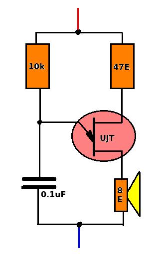

                    Can you suggest simple way of how to connect piezo transducers instead of buzzer?
                      You mean this (?):
                      Yes, that's correct. It gives a good loud audio signal.
                      It must be the type that beeps when you connect it to a battery, and not the piezo speaker type that justs
                      clicks.
                        clicks.
                        Thanks.

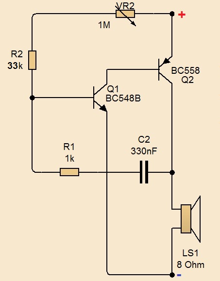

                        In fact I am asking you for simple sulution that can be replacement for self-beeping buzzer and allow us to use beside piezo speaker or piezo transducer, crystal earpice too.
                        Something like this for dinamic speaker:
                          Thanks.
                          Obviously you will need some form of audio oscillator, such as a 555, and then gate the timer output from the comparator.
                          Have you tried the solution in your circuit diagram?
                            I am trying to go as simple as possible, preferably one transistor solution, but using piezo transducer or crystal earpiece, cause of low consumption. 555 is one solution, bot not the most elegant.
                            I didn't check circuit posted above it is as example of simplicity. This is what I checked as working, but 2 TR and dynamic speaker:

                              Something just occurred to me. As you're using your own PCB, I assume you've seen the errata list?
                              There is a small error in the schematic for the probe, as follows:
                              Page 38 – Fig. 4-5 – Off-resonance probe has incorrect pin numbers on IC3. These should be VDD=8, VEE=4, INV=3, NINV=2 and OUT=7. The PCB layout is correct.
