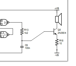

    Hi Ray,
    based on your explanation then the correct connection should look like this:
Name:	corrected connection.png
    versus how it was:
    If that is right then how would I go about jumping or fixing the board I have made (based on the pcb shown above in other post)?
    the 1.2k should go right to base of the 3904 but how would I get around the pre fabbed connections for the pot? Thats probably a dumb question but for whatever reason it is not clear in my head..

      Yes as in your diagrams, in my opinion.
      I think you just remove the pot. from the PCB and you have the connections required in your revised diagram.
      Ray

        Thanks ray, thats kinda what I thought but wasnt sure based on the split connection from the pot to the 555.
        I gave it a whirl and still get nothing though so there must be another issue elsewhere. I changed out the 555, 3904 and the 10R resistor as they were smoked but still not working.
        Have power at all points so not sure what or where else to look with this thing.... Dang, was hoping that pot removed and new parts would be the fix...

                  After a cursory glance over the PCB layout, it is fairly obvious that the 5k pot is incorrectly connected. The layout has it connected between R15/C9 junction and +VB.
                  If you remove the 2N3904, 10R resistor, 5k pot and speaker; what does the audio signal at the junction of R15 (1k2) and C9 (100nF) look like on the scope? You should see a VCO style signal at this point which varies when a target is close to the coil.
                  Note that either the headphone circuit or the speaker circuit should be connected to hear the audio output, but not both together.
