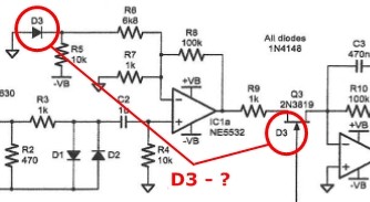

              Diode D3
              Question, on the PI 1 schematic, there is a marking for a diode next to the Q3 2N3819, is this a typo or is the diode missing from the schematic, I noticed there is another place on the schematic where a diode is marked D3 next to R5...
                [ATTACH]35991[/ATTACH]
                If you're referring to the arrow at the gate of the 2N3819 ..... that is part of the FET symbol. It's not a diode.
                I'm not sure what you're asking about D3.
                  If you look at the cropped pic I added in the previous post, it shows a "D3" just to the left of the trace (gate line) to the Q3 2N3819, is the D3 just referencing the gate arrow or is there supposed to be a diode on that trace going to the gate? Reason I ask is there is already a D3 diode on the schematic next to R5 just above to the right of the mosfet.
                  New pic -
                    The "D3" next to the fet on the PI-1 is also present in the 2nd edition, but is removed from the schematics of the PI 2 and 3. Looks like another entry for the errata.
                    Rick
                      New pic -
                      [ATTACH]35992[/ATTACH]
                      OK - thanks - I see what you mean now.
                      Rick
                      Yes, it's some random text that appears to be in both editions.
                      That's the first time anyone has noticed it.
                        Ah, good. was going to add a diode to that trace until I saw there was a D3 elsewhere, so glad to be of assistance....
                        p.s. I'm doing a bit of modifying to this, hopefully it will work out.
                          First time I've noticed it, too.
