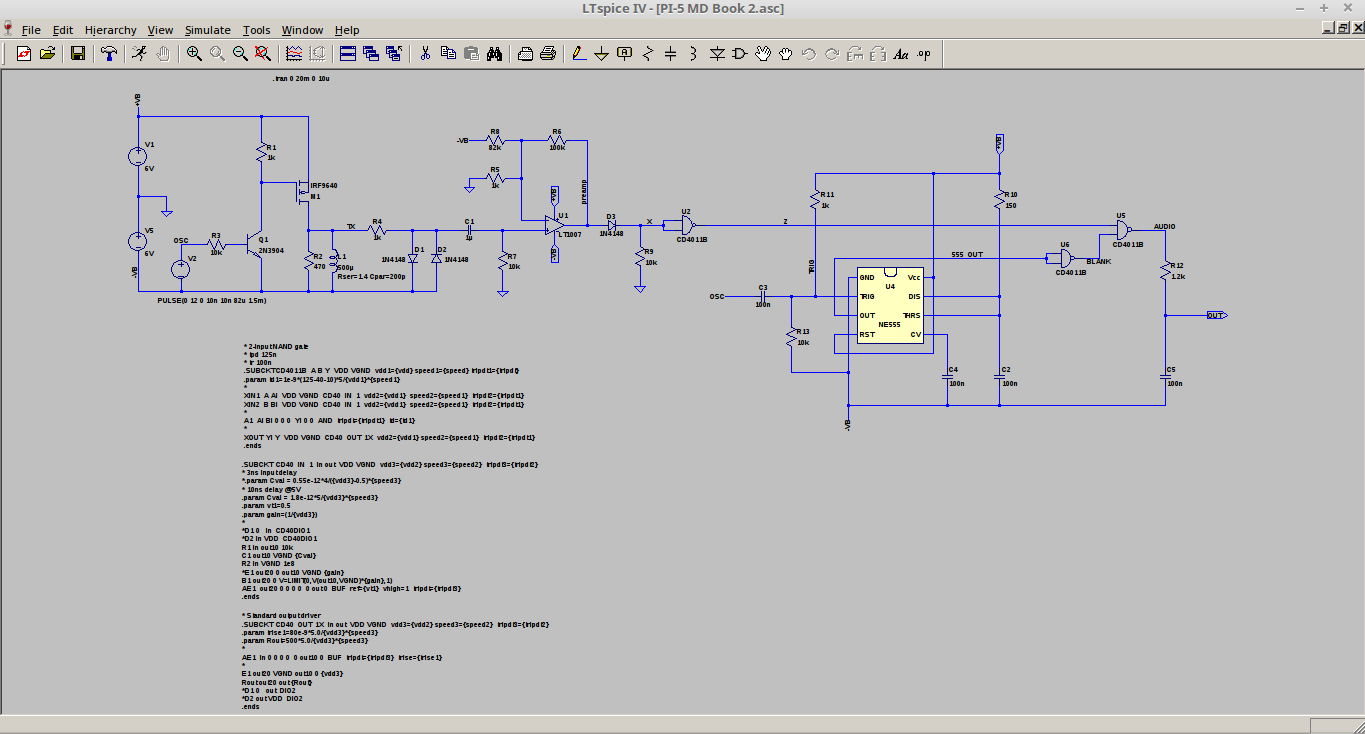

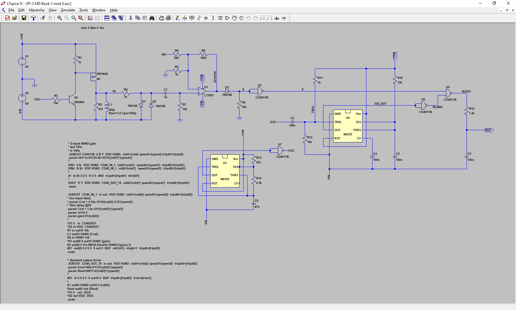

On page 167 (PI-4 design) it was mentioned that sensitivity of that particular design would be lower than the previous ones, because of direct sampling and a low resolution 10 bit ADC. After reading trough PI-5 design I started wondering, what if PI-5 design would be implemented using MCU and we would measure decay time using it's comparator instead of ADC(same as PICKINIV4), would sensitivity be greater than that of PI-4 design?
