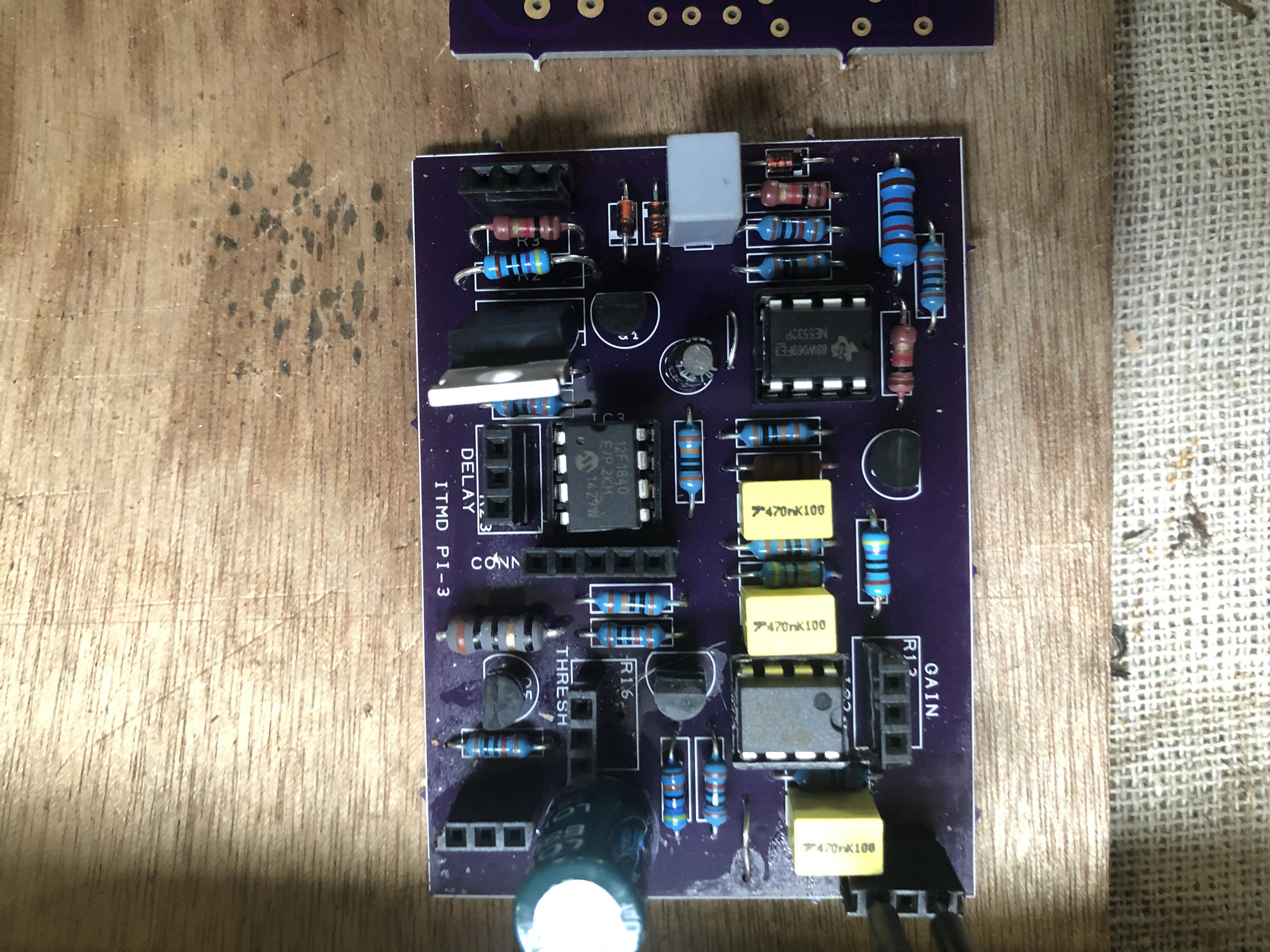

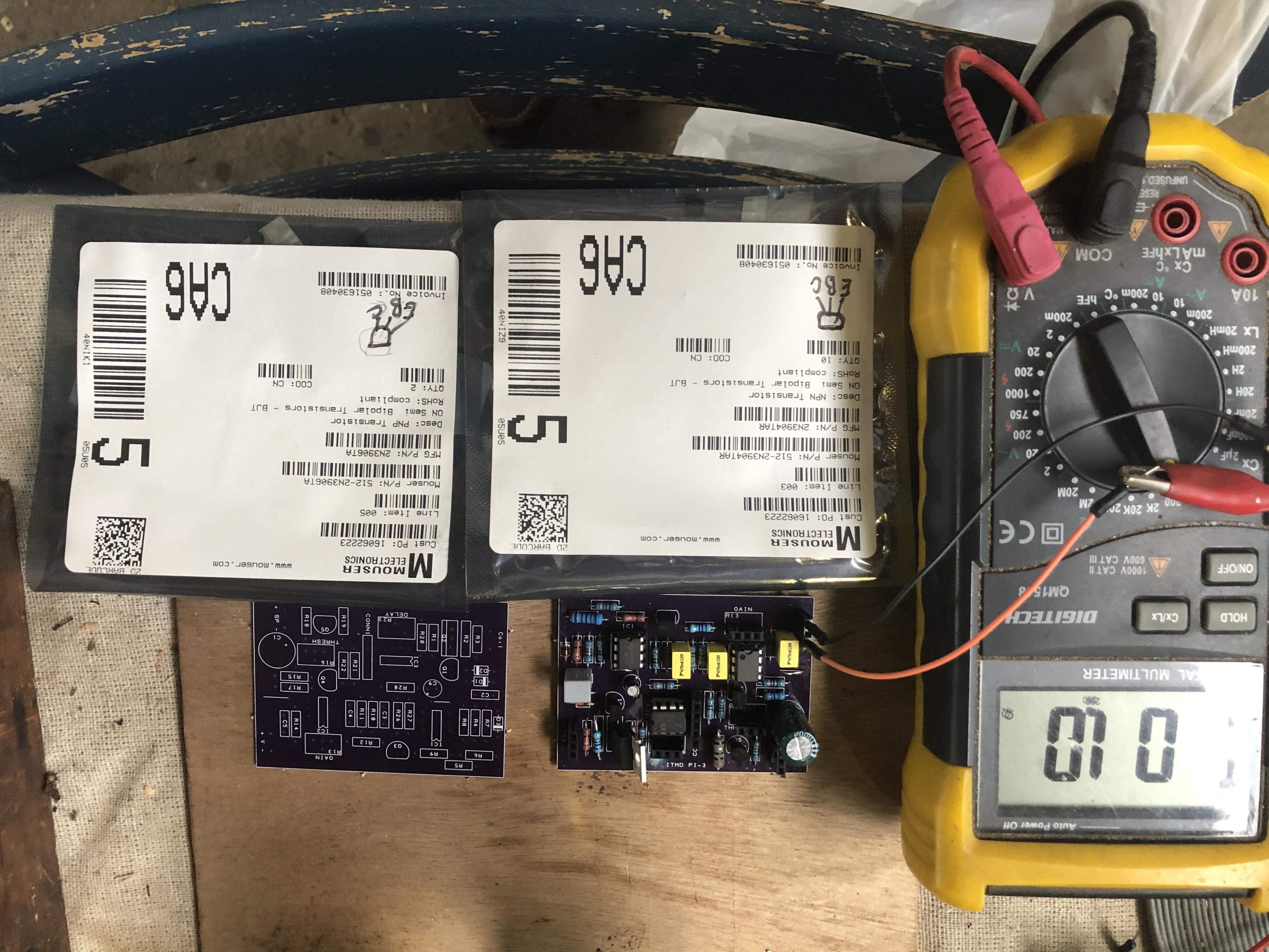

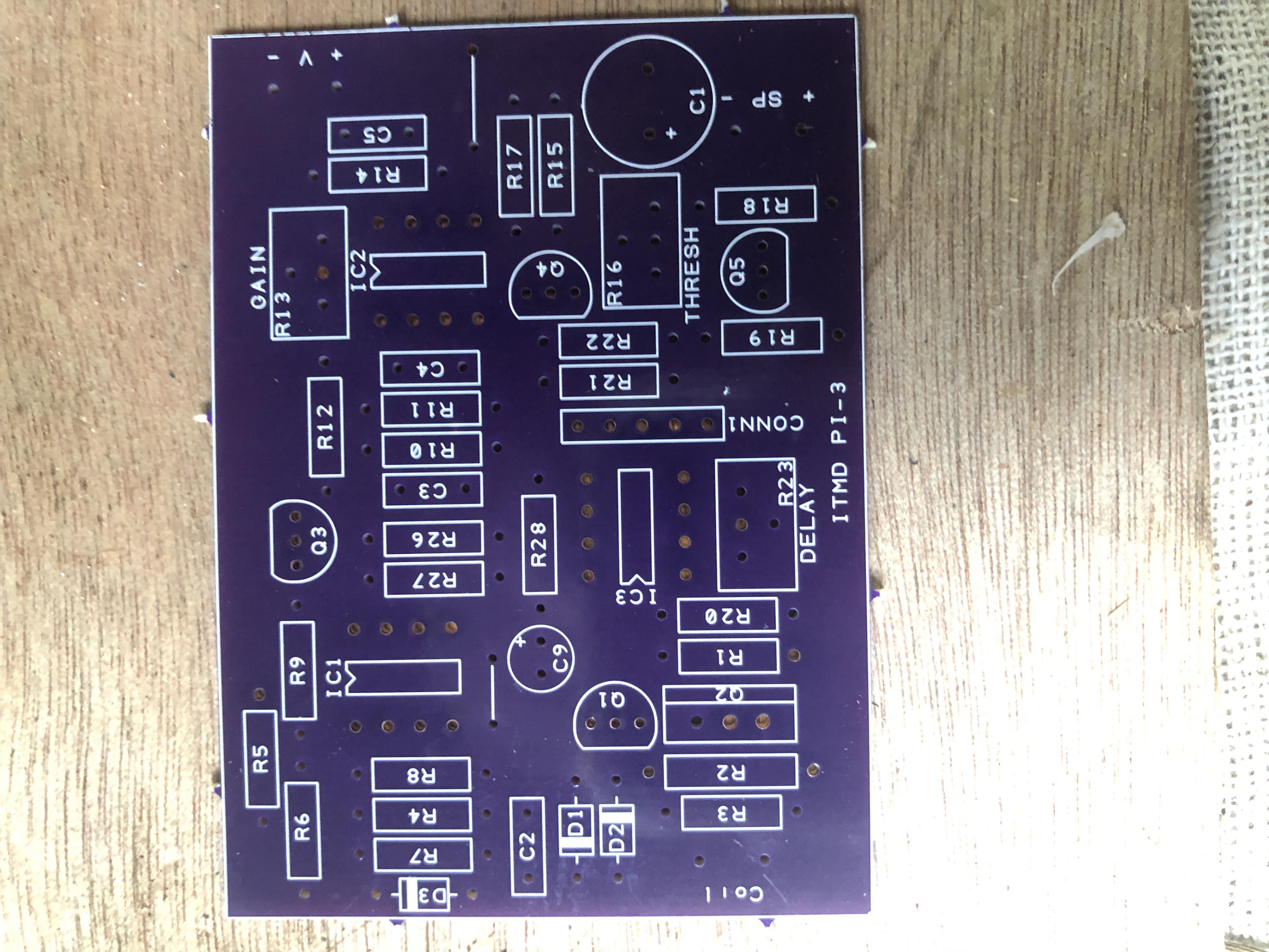

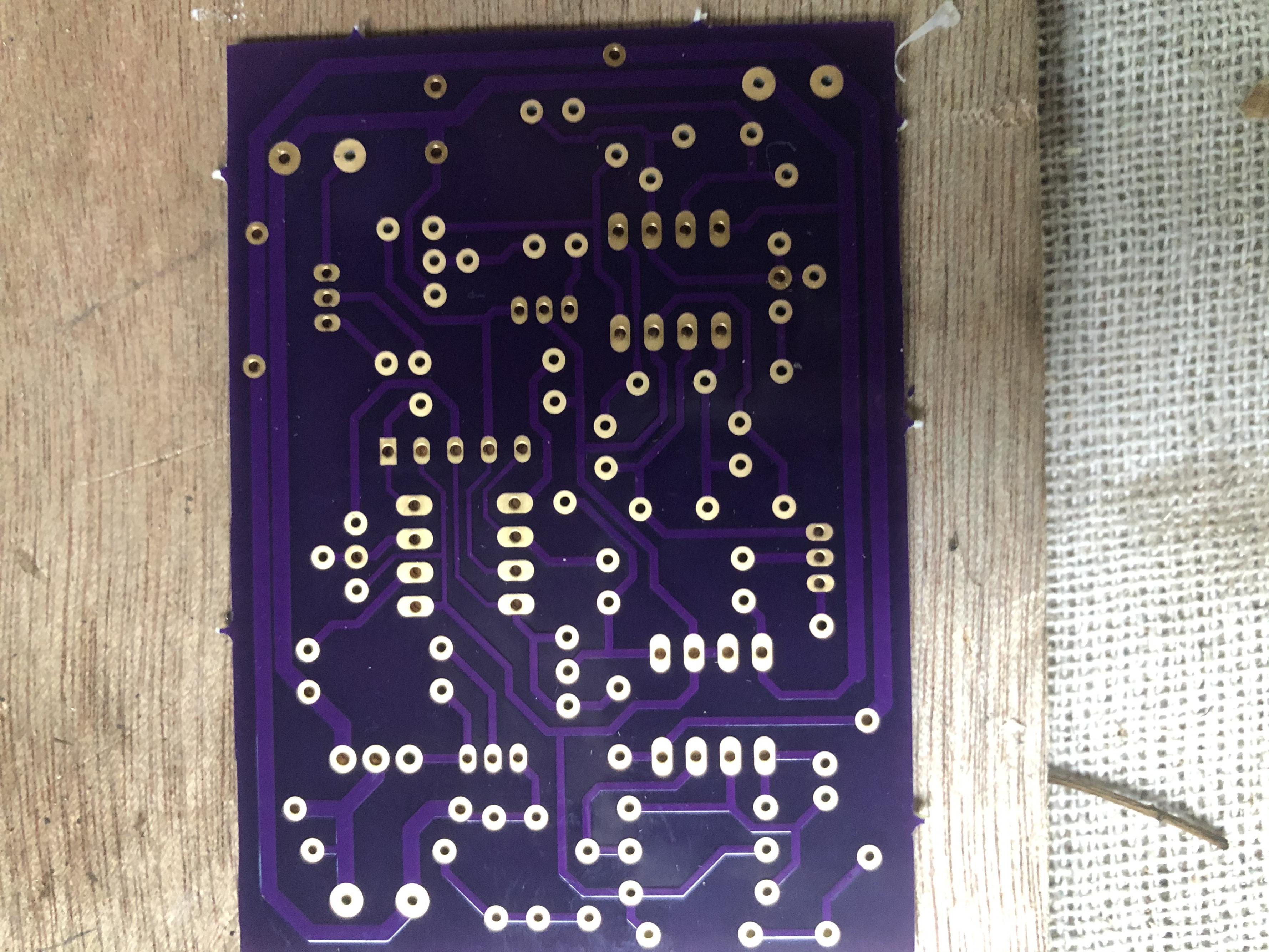

        As I hope the attached photos show, 1 ohm with nothing attached. The pins are EBC from data sheet for the 2N3904 NPN and 2N3906 PNP and GDS for the IRF9630. I can't find the purchase info for the 2N3819 to check.
        Any leads welcome for build no.3.
        Cheers
        JohnClick image for larger version

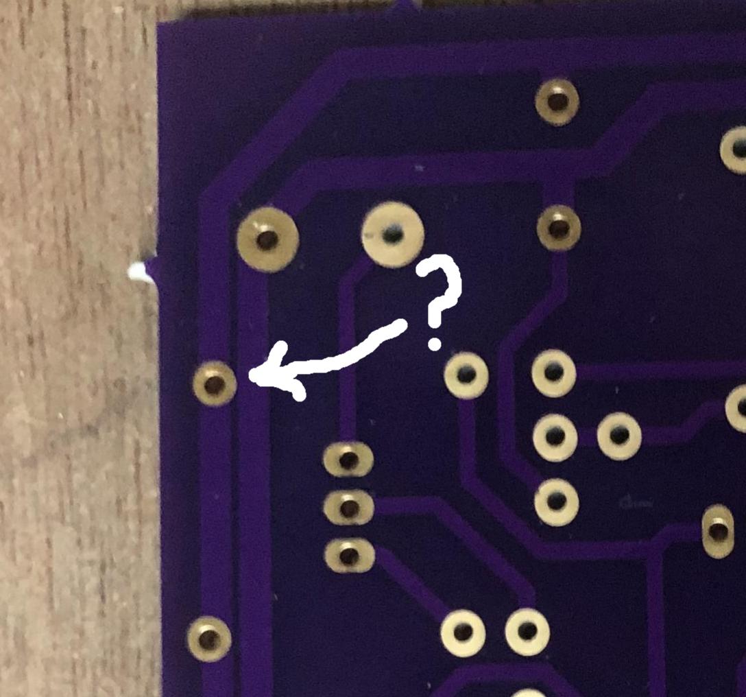

          See attachment.
            Yes, I think that's a potential short.
              Good catch. Looks like my fault on the layout.
                Wow, well spotted
                Thanks guys, i'll have a go at cutting it and report back
                Cheers
                John
                  If you examine the Gerber bottom copper, the pad is not actually shorted to the track, but it almost certainly violates the design rules. Due to manufacturing tolerances in the PCB process, this is likely to result in a short-circuit, as appears to have happened here.
                  I've had this happen before with PCBs, even when the layout has successfully passed DRC.
