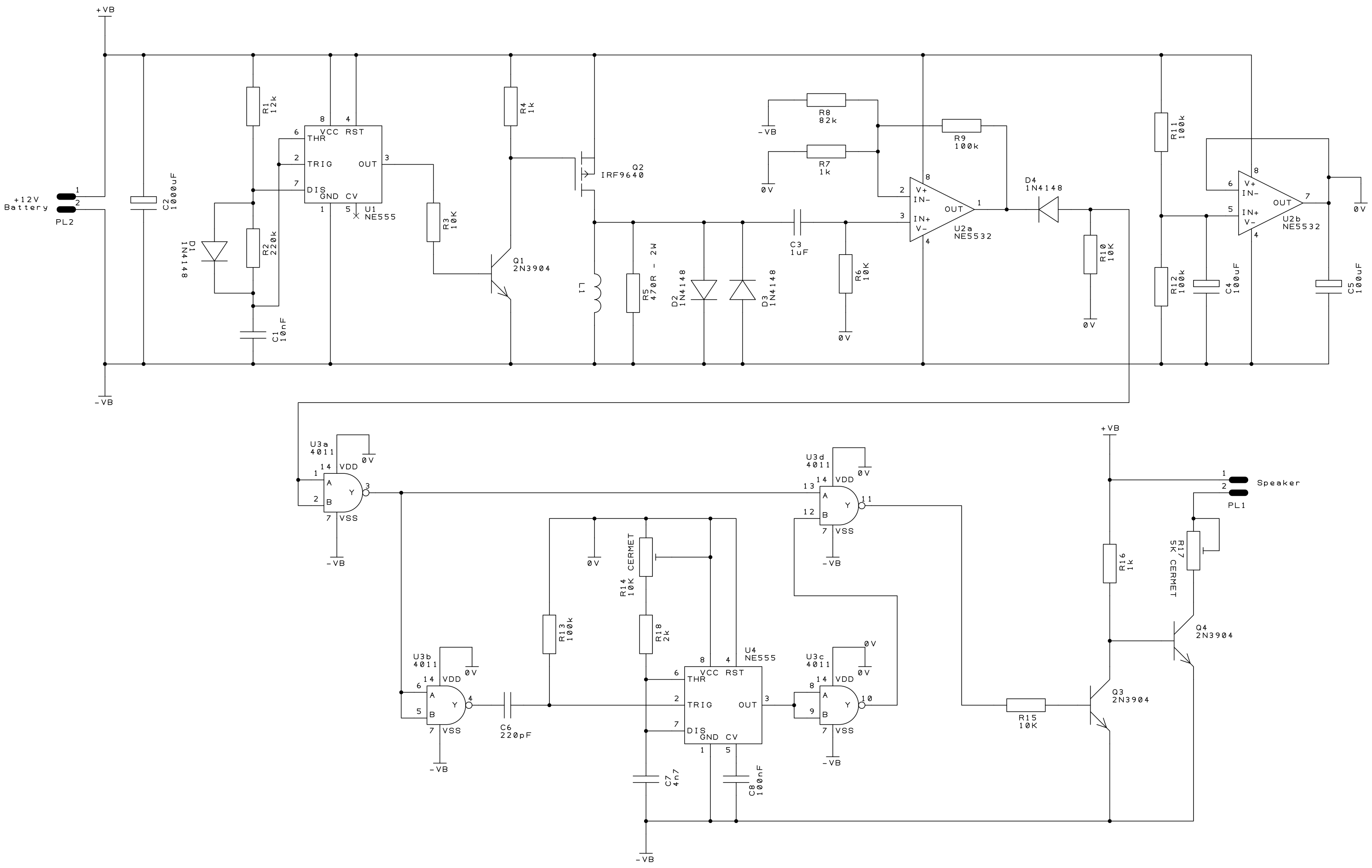

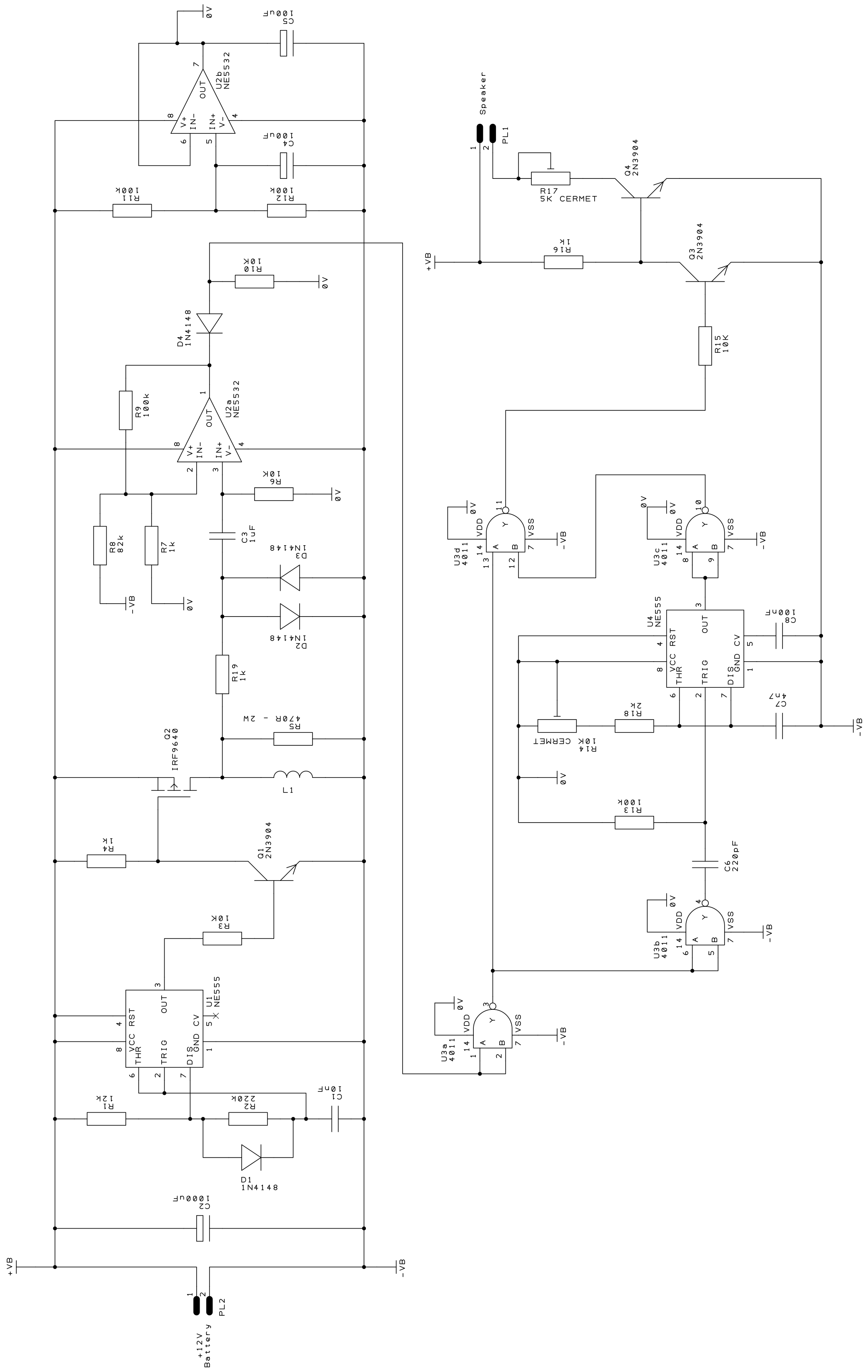

    As promised (quite some time ago) here is a working version of PI-5:
    Please see the attached PDF file for all the details.
    I've also included the schematic as a separate image, and an audio file so that you hear what it sounds like.
    Enjoy!
    Edit: Please ignore the attachments below and use the ones in post #4.
    I have left these here to maintain continuity with the discussion.
    Last edited by Qiaozhi; 10-06-2020, 11:05 AM. Reason: Updated attachments in post #4.

      Nice audio, well done, so a series resistor is no longer required between the coil and diodes ?
        Well spotted. :examine
        Of course there is a series resistor there, as you can see on the solderless breadboard image. I've updated the schematic with the correction.
        Thanks. If you spot any other errors then please do not hesitate to point these out, as it's very difficult to check your own work.

              The circuit diagram shows connections with 0V
              Where are they connected ?
                They are connected to pin 7 of U2b. This point is the half voltage reference created by operational Amp. U2b
                There are 6 volts from 0 V point to +VB point, and - 6 volts from 0 V point to -VB point
                  Correct. The ground (0V) is the virtual ground referred to in the PDF document.
                    Ah, now i undertstand- thenk you
