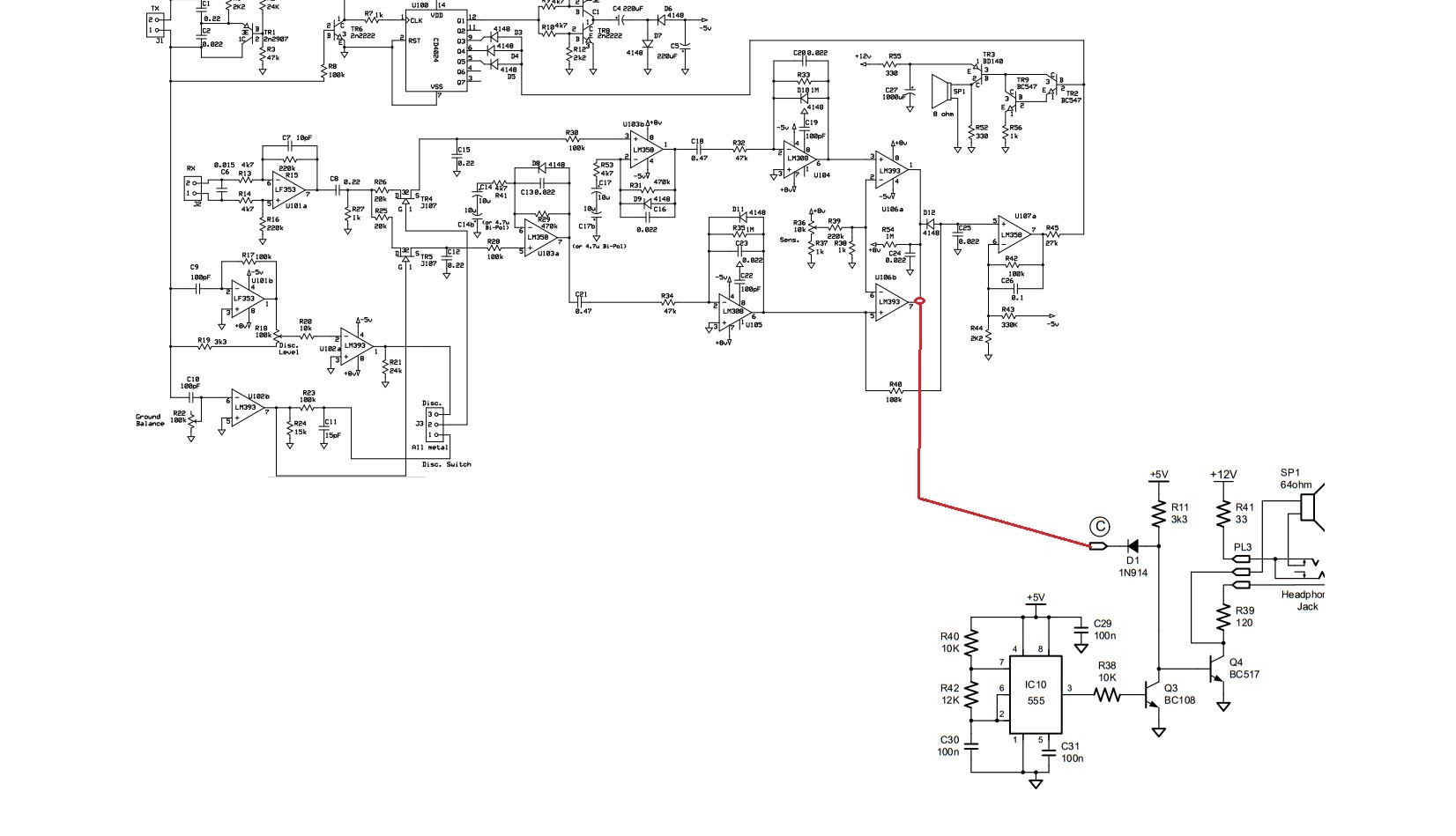

        Is it possible to see attached and tell me your opinion?

          I attached TGSL schematic, is it possible to suggest me some point for palying it?
          In TGSL schematic, i increased both 470K to 1.5M. My sensitivity increased but not such Relic. I also tested it with two 2.2M, but its stability was very very bad.

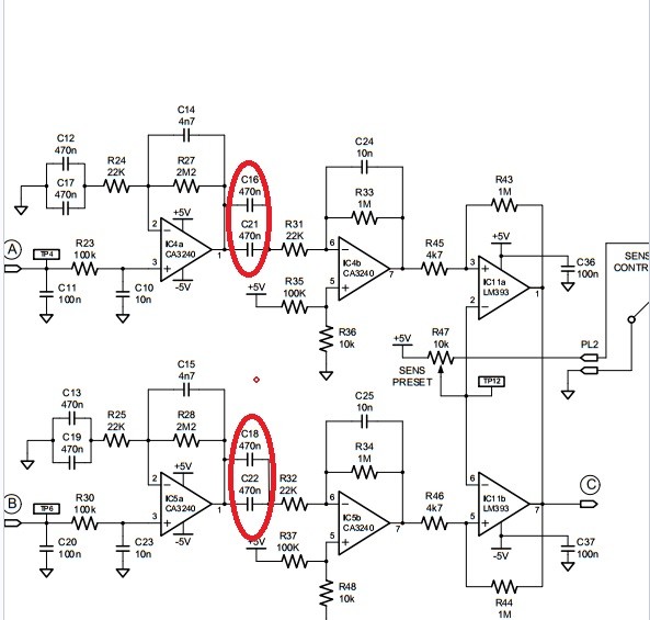

                Reactivity or recovery time.
                  Recovery speed depends on the BW of the circuitry AFTER the demod switches. For example, the differentiators in Raptor have a roll-off at 10-11 Hz. Try speeding these up by reducing the caps. However, this can reduce depth and make the detector noisier.
                    thank you.
                    Is the cap that you mentioned?
                      C14,15,24,25

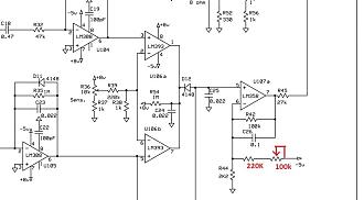

                        I have a request, Is it possible to guide me how to add a threshold Audio pot in TGSL schematic?
                        I think it should be near R43/R44, but i do not know how add it.
                        Thank you.
                          C14,15,24,25

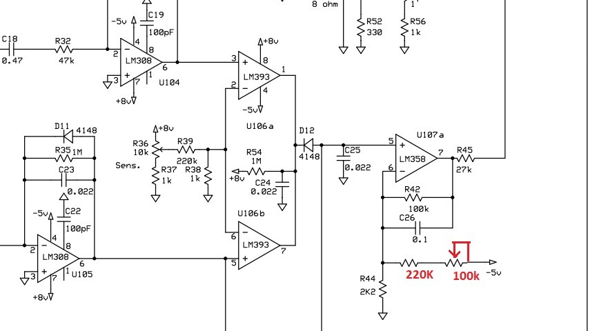

                          I added Threshold pot (attached), do you think it is correct?
                            That will work but I think it will only add a fake threshold level and will not help with sensitivity. TGSL is designed for silent-search disc-only, there is no all-metal channel to drive the audio which is what you need for adding an effective threshold. The Bandido II circuit is a good example. If you have ITMD3, then the VLF-Disc design also shows how to do this, and it also shows a way to do 2-tone audio.
