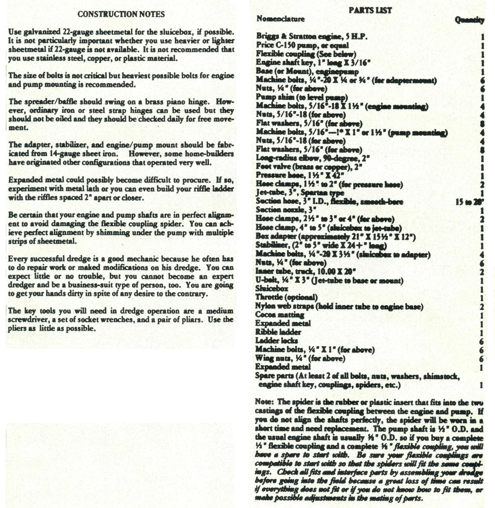

    First, the above, are some posts of guys who bought the information, or the actual Spartan dredge. Now I used it, it was too heavy to carry for a one man operation, as far as my own thoughts go. But for a strong nearby river, it would suffice. I like light weight gold equipment myself. It was rugged, and heavy to carry. So I tried it, and then sold it. I liked the Compass Electronics dredge units.Here below is the technical material to build it yourself... MELBETA
Name:	Bill of Materials_001.jpg

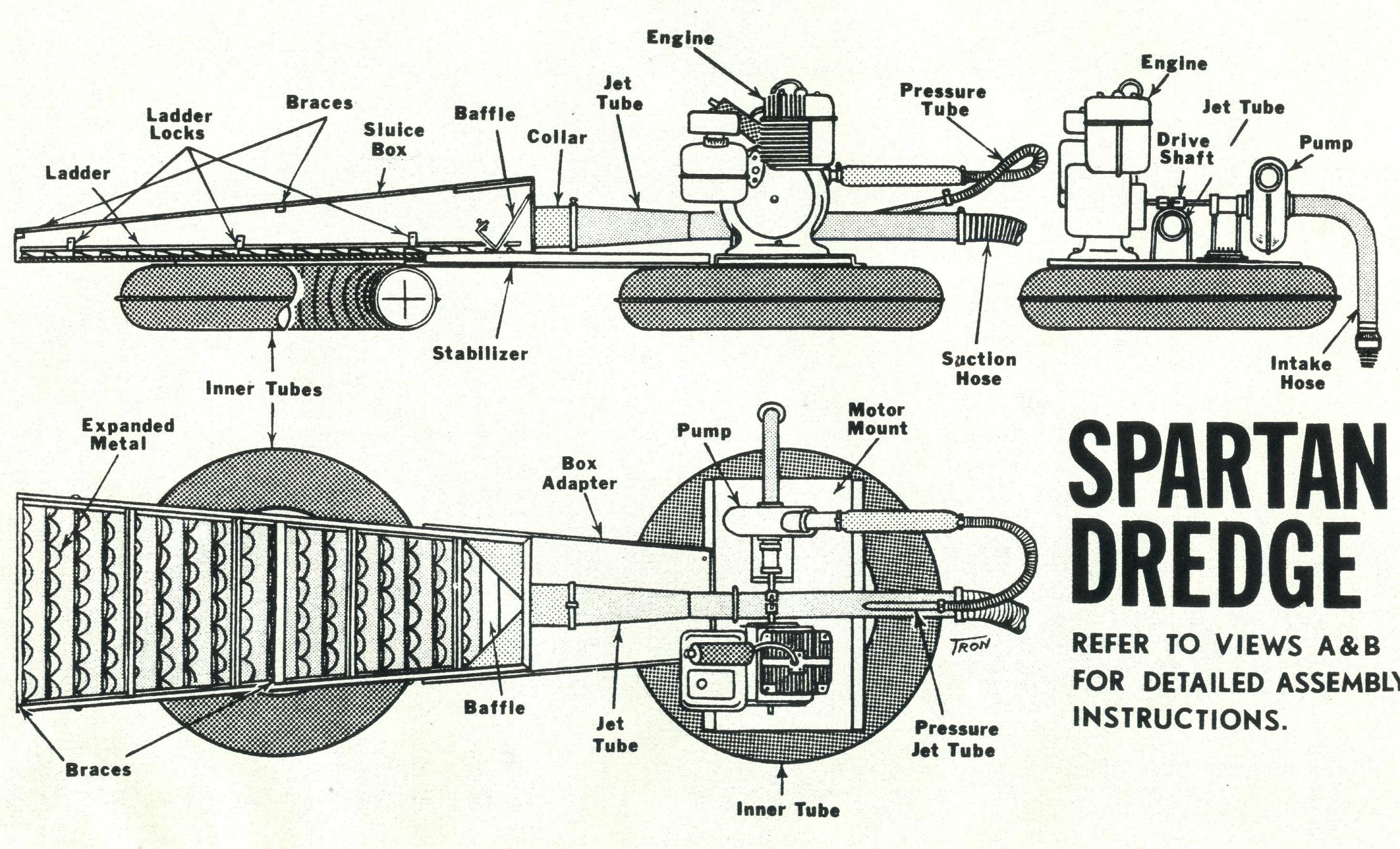

ID:	420620 Here is a photo of what the Spartan Dredge looks like, with its varied parts... Click on the thumb nail, and make it the size you want to view... I liked Medium myself.

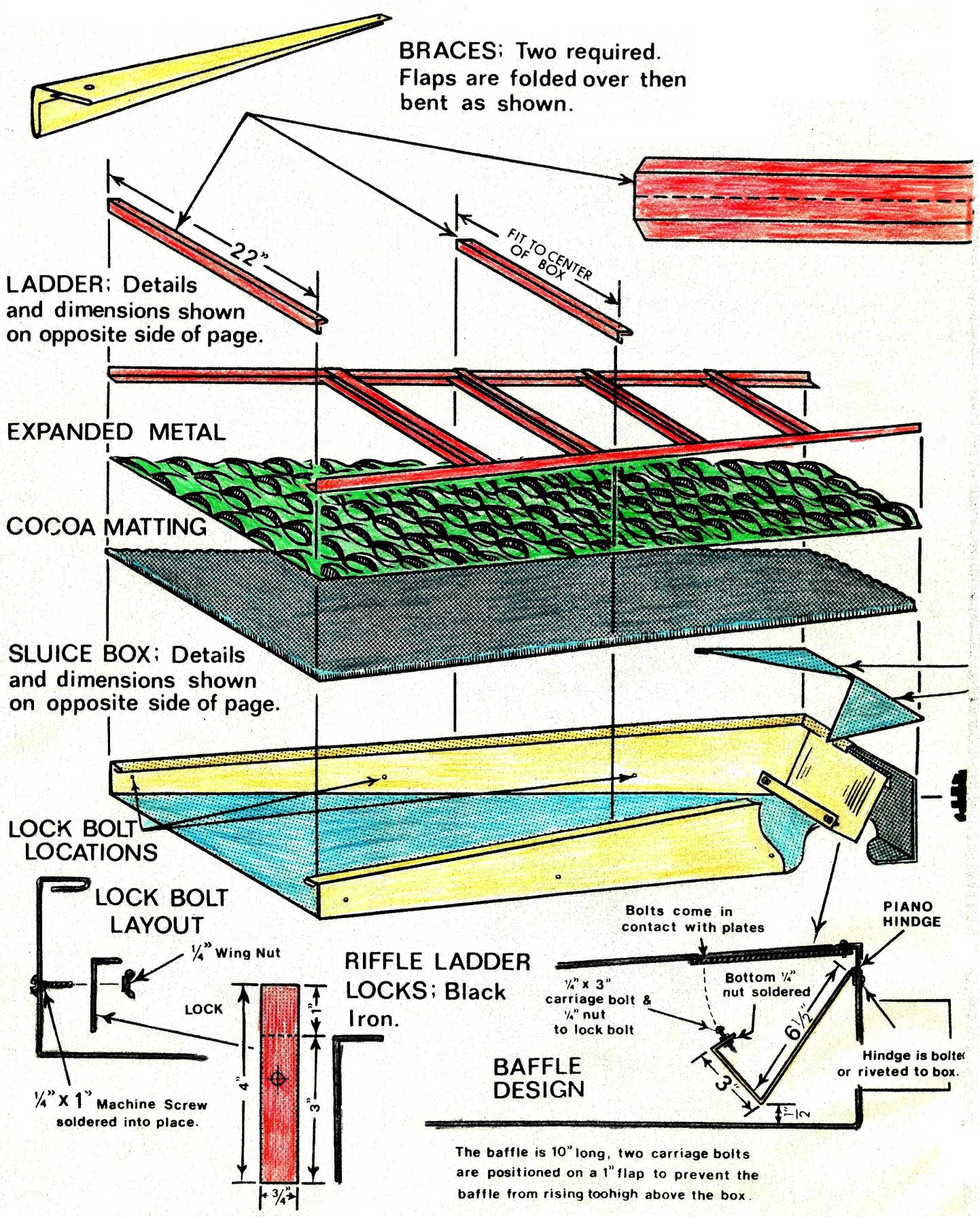

      Here is an piece look at the construction of the SLUICE BOX by itself...... Had to put in another thumb nail, as it could not handle the larger size for upload...I colored it for fun!

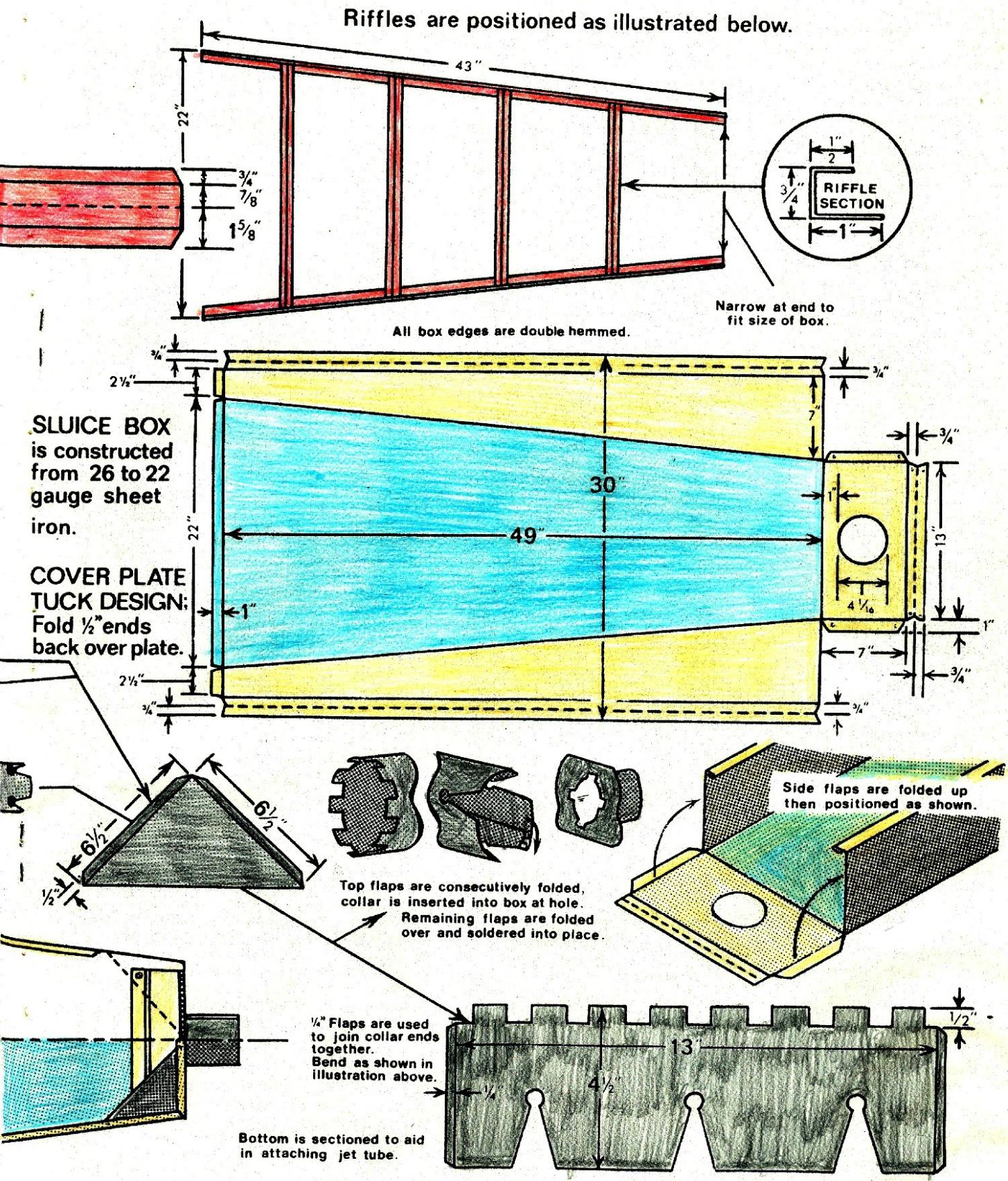

        And another view, from the top side of the sluice box, for more information and details........ And again, a size thumb nail for convenience.......

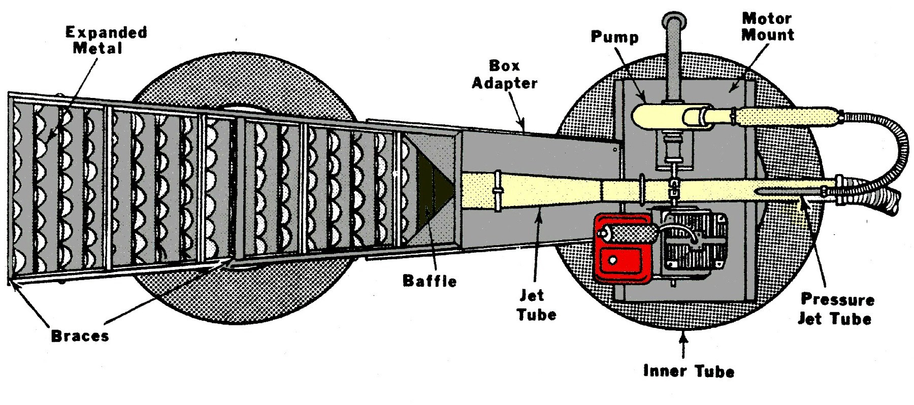

          A top view, of the entire SLUICE BOX UNIT, for clarity and layout.......I suggest building it light weight myself in case you have to carry it to the stream area...

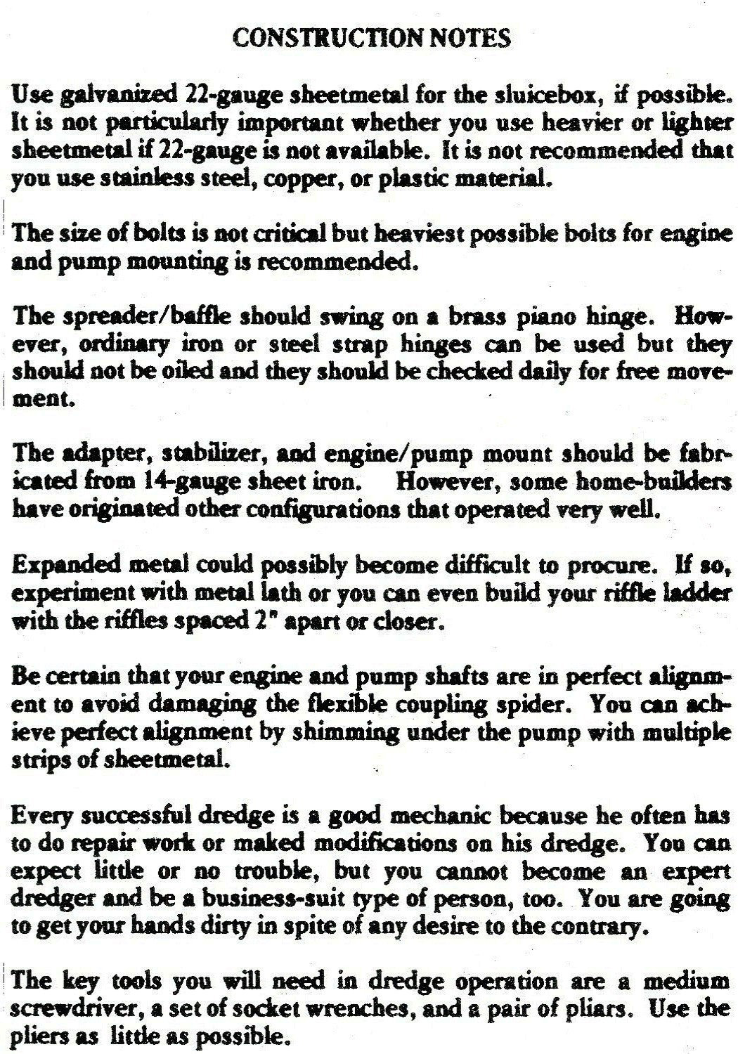

            And here are the Spartan CONSTRUCTION NOTES, for an detail instructional revelation of the information....... Beyond this, send me an email if you have questions to [email protected]
