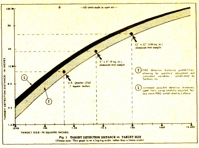

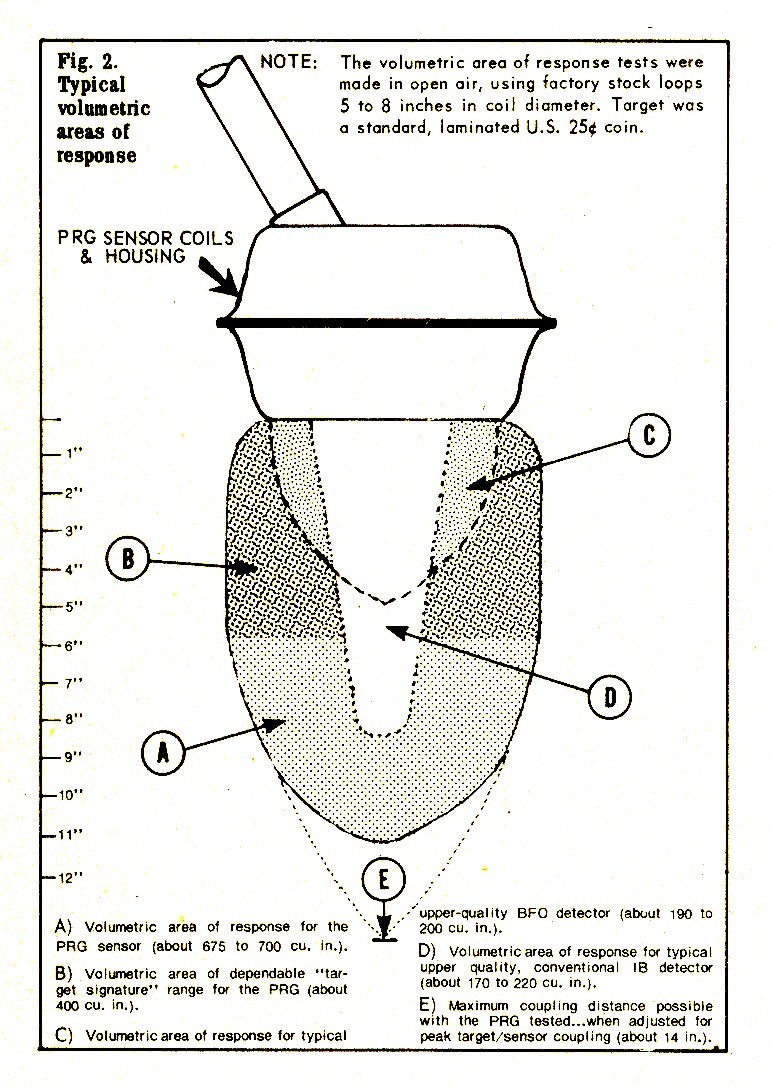

    Rocky LeGaye got one, tested it, wrote a story about the test and about the unit, and it is right below these words. There you go, you got the basics!!!
    [ATTACH]n432762[/ATTACH]a couple of photos of an actual unit. Not the greatest photos of it, but at least I enhanced the photo to make it a bit better!!!!! Here is the first photo, and it
    is called Distance and Distance and Size, etc... Right below it is.......
Name:	001 Distance & Size.jpg

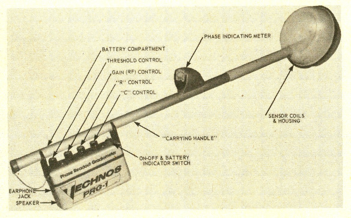

Name:	002 Features.jpg
    Next above, is an enhanced photo titled FEATURES, and it speaks for itself..........The photo below, is COIL DATA, so that you can build the coil as well.......

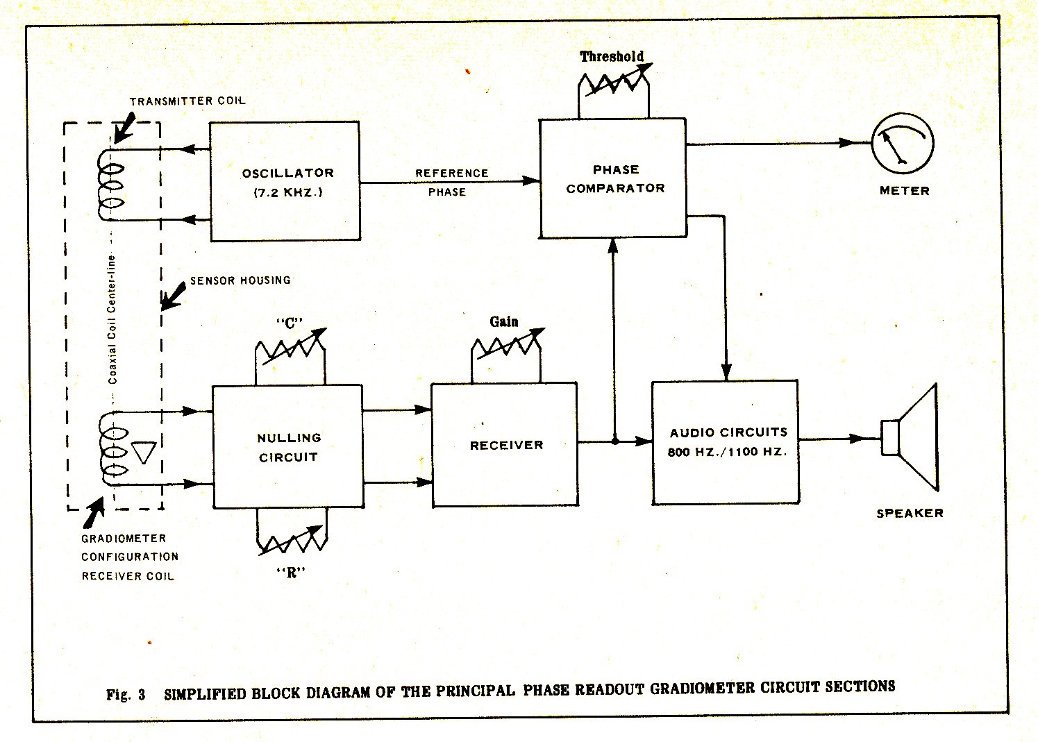

Name:	004 Block Diagram.jpg

    Block diagram of IBR (Induction Balanced Regenerator)
    Block diagram (shown above in posting # 16) is similar to a blocking generator - a wideband amplifier with regenerative feedback via mutual inductance. Without tuned circuits, it will generate pulses as multivibrator. To generate as a sine wave Meissner (Armstrong) oscillator, needs a tuned circuit, ie to one of the coils to be connected capacitor to obtain the required phase shift. The mutual inductance M between coils L1 and L2 shoud be minimal to increase the modulation index of target signal. This means induction balance or minimal K (coefficient of coupling).
    The feedback loop is closed in two ways:
    - The upper signal path is through mutual parameters M, L, R, C between L1 and L2. The change of TX current in L1 induces voltage in RX coil L2 by mutual inductance M. The phase of mutual induced signal is independent on frequency. It remains always in quadrature, ie in phase lead 90 deg to excitating TX current. This voltage is shown in complex plane below as a signal AIR. Each frequency represented by a point in streight line 1. When frequency increases, the point moves upward.
    NOTE: We can close feedback loop by adding an additional network or mutual parameters L, R, C. Thus the phase of AIR signal can be made frequency dependent. This is done by C7 and R5 in circuit diagram (shown above in posting #5). The additional closure is not shown in the above block diagram.
    - The lower signal path is through block TARGET. The phase characteristic of TGT signal can be extracted from curved line 3 for ferrous metal. When TX frequency changes from zero to infinity, his point on the curve moves in shown direction. Thus, at ferrous target, the signal can have any phase in the range from +90 deg in 1st quadrant to minus 90 deg in 4th quadrant. At nonferrous target (shown with curved line 4), the phase may be in 4th quadrant only. The signal can have any phase in the range from 0 deg to minus 90 deg. Note that ferrous and nonferrous conductors have a cuttoff frequency at which phase lag is 90 deg, but only ferrous target has a resonance frequency, at which visual phase lag is zero. This is quasi-resonance because phase lag is 360 deg.
    The system may oscillate if it has 2 conditions are met:
    1. Phase delay must be 360 deg or a multiple of 360 deg for some frequency . For a given target, this condition can be set in block PHASE SHIFT, which contains a PHASE control.
    2. The gain of closed feedback loop must be greater than one at the some frequency. For this purpose anywhere in the feedback loop must be connected a potentiometer (attenuator) GAIN control. This is R9 in above circuit diagram. If the gain of closed loop is greater than one for more frequencies, the circuit will generate as multivibrator.
    The sensing network in above block diagram can not serve for visual analysis because is too simplified. We should connect a comprehensive block diagram of sensing network containing ground with target buried in it and two RX coils. The TGT signal undergoes changes due to double pass the energy through the ground.
