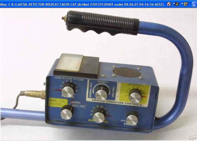

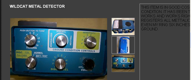

    Hello,
    here are some pictures of the control panel. How should I use these buttons for the best performance?
    Thanks.
    Miguel

        Miguel, Sorry for the late response but I've had some family problems to deal with! You had some red marks that seem to be in the wrong spots. Place the detector on your bench or kitchen table away from all metal! Turn on detector, move volume dial to the 7 or 10 mark! If this makes the unit erratic, turn it back to 7 or 8! Detector Mode use the Discrimination- Foil setting. Discrimination dial put on about 4. Here in the States I would say to make sure that it will accept the U. S. Nickel, but in Germany? Not sure where I would set it? Sensitivity set on the 7 to 8 mark, very seldom would you set it on the 10 mark as this would make the detector very erratic! While holding the push-button down on the end of the handle, Turn the tuning control until you get the threshold sound! The Threshold sound is the lowest sound that you can comfortable hear. Also this Threshold point can be lowered if you use headphones. Release the push button! Lower the searchcoil to a metal free patch of ground, if the sound stays the same - take off and hunt! If the sound increases or decreases retune the detector by pushing and releasing the push-button again! Take off and hunt, if the threshold fades out or increases just push and release the push-button switch again! Also keep the coil approximately 1 inch off the ground or you can scrub the ground !Now all of this is in the Discrimination Mode. If you want to Relic Hunt switch to the Normal mode! Now this is a All-Metals mode with no discrimination! If you are interested in the Normal Mode, I can go into more details on another day! Right now My teenage daugher is harrassing me for her computer time! So if interested, I can discuss this latter this week! Hope that some of this will help...................Joe
          Hi Joe,
          Thanks man for the instructions.The first picture I posted is from another C&G Wilcat detector that someone offered in internet.
          Unfortunatelly my detector hasn't arrived yet.But it is already somewhere here in Germany,perhaps it stays at the Frankfurt Post stuck
          I hope within this week I will have it. As soon as it arrives I will let you know
          how it reacts to these tests.
          These old maschines I'm sure are so much sensitive as the new digital ones.

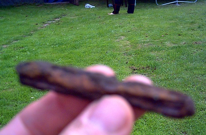

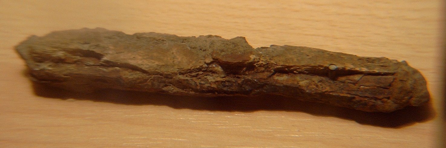

                  Hello,
                  I tested this detector in our garden.Among a plenty of rusty nails,screws,bolts etc.
                  I found this old pocket knife in aprox. 0,10 cm depht.
                  It seems to work better on "All Metall Modus" as on "Disc".
                  Freundliche Grüsse aus Deutschland
                  Miguel
