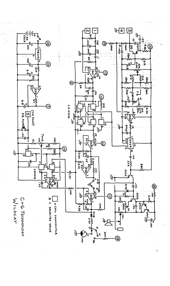

    Hello all, I have acquired a basket case Wildcat and need some minor information before I can even see if it works. The detector is all there except the batty compartment door. It is missing the battery packs and I just need to know what voltage the two circuits work on. I can fabricate the battery packs. Thanks in advance for any information.
    It takes 2 nine volt batteries

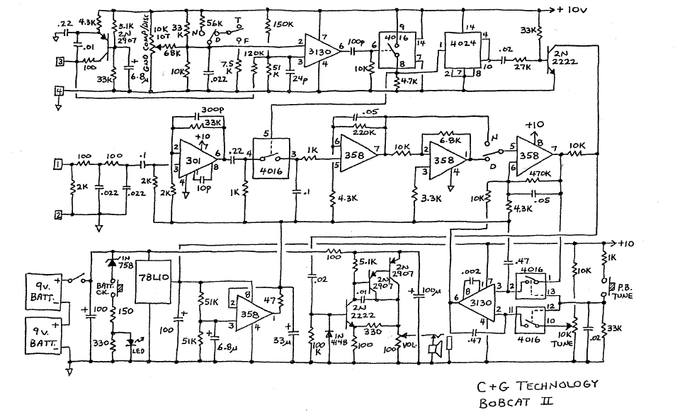

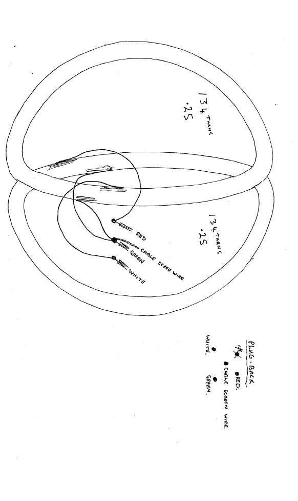

      Hello , Here is the schematic and the "possible" search coil information ??........These should help You !!!....................Eugene
        The Wildcat used a stacked coaxial coil.
          C&G Technology "Wildcat" Need Help Please
          Sorry , I posted the wrong Search-coil , so here is another C&G schematic , that way I am 100% Forgiven..Eugene
            Only 99% forgiven!
            Bill Lahr really likes to reverse-engineer detectors, eh?
              The Wildcat Does NOT run on two 9 volt battery's. It runs on 12 AA battery's. Here's a video of mine showing the original battery packs and detector for anyone interested.
                Never seen the "Super Stalker" coil label before.
                  https://youtu.be/GYK-ZtXoCv4
                  12 x 1,5V = 2 x 9V =18V
