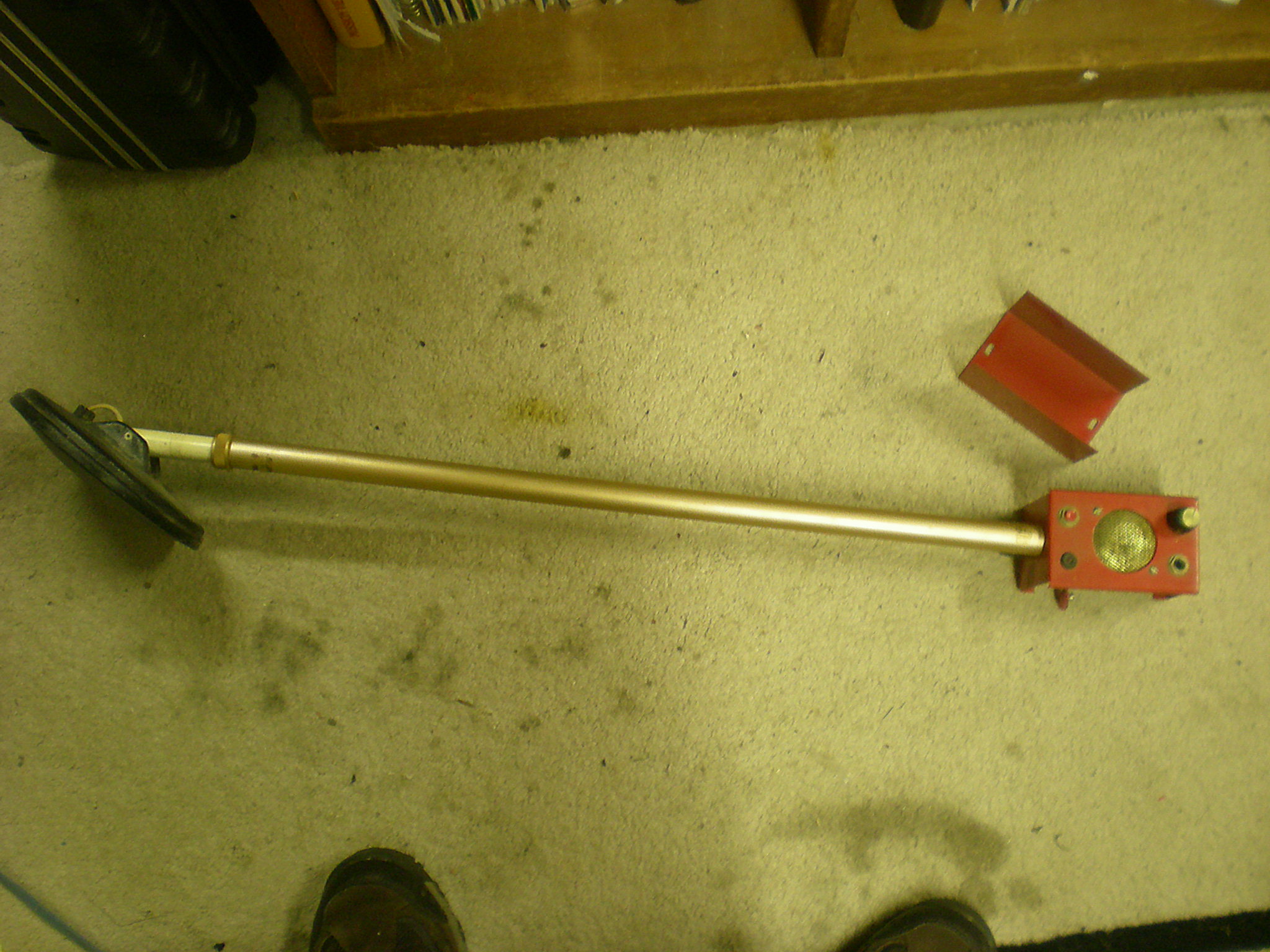

    I got this from a guy at work. Looks like a project from 1964 Popular Electronics or whatever... What do you think it is? Has a control in front for zeroeing the sound and another for volume. Makes noise but doesn't work in my metal engrossing garage. serial number is: 76MMSD486! Jeez, must be thousands of em out there!

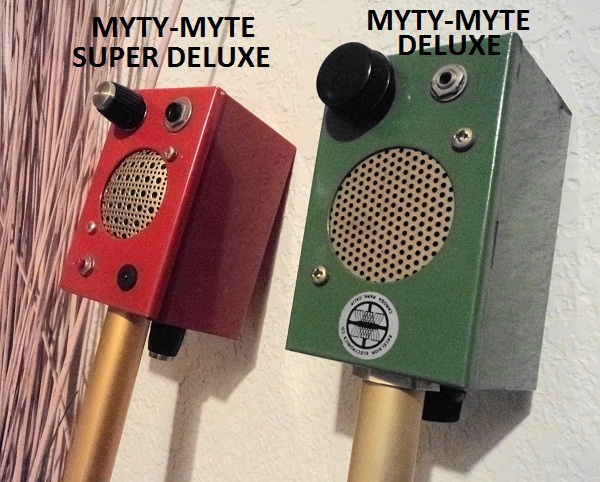

    I'm not sure, but it might be a Compass Coin Hustler, or similar BFO detector.
      Excelsior Electronics unit called Myte-Myte
      The red one is the Myte-Myte Super Deluxe version...
        That's definitely it! Now Googling it seems like there are fond memories of it by many.

          Mispelled the name slightly....
          It will probably end up on ebay as I have too many detectors already...
          Barry

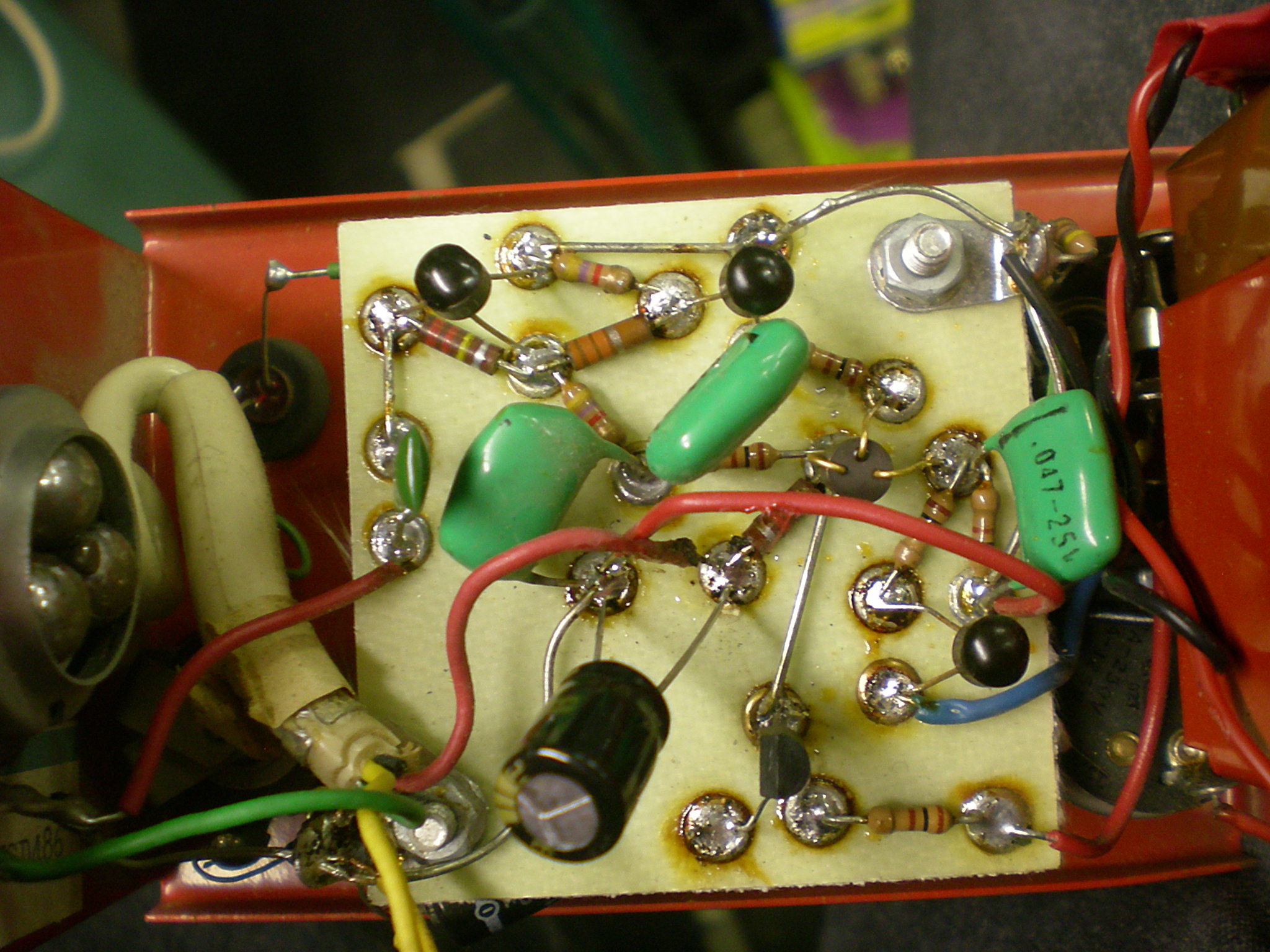

          Just noticed I spelled the name wrong, is Myty Myte, not Myte Myte. Here is a shot that someone posted in past.

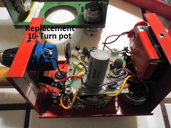

            I took mine to a park and it doesn't work. There is a point where it goes quiet somewhere in the middle of the adjustment range - but it doesn't respond to a metal/coin presence. Battery check lights the LED.
              Clean the tuner with TV tuner cleaner...
              Sounds to me like you had audio sound, then it went away, so it appears to me that the 10 turn tuner might be dirty inside or defective. The Myty Mite is famous for having bad tuners.
              Spray the inside (with the battery unhooked) with TV tuner cleaner spray, let it dry a bit, then try it again.
              You had the lid off the unit, so you can tell it is a very very simple TR detector, having a large 500 uF 15V electrolytic, a couple of transistors, a vertical pot, some caps and some resistors. Not much there to repair.
              At least the battery check works and lights the LED. Sounds more to me like the tuner is dirty or defective...
              Make sure the speaker works. Sometimes when someone plugs earphones in, it shorts out the speaker. But you must have heard some kind of audio sound, before it disappeared?
              But the coil might be bad too.... And someone might have noticed it did not work, and fooled with that adjustment trimmer pot inside also... I am not sure on that trimmer pot, it may adjust the null of the coils Tx/Rx. I would say, repair everything around that pot before you play with it, if you play with it. It just might be a parts unit now...

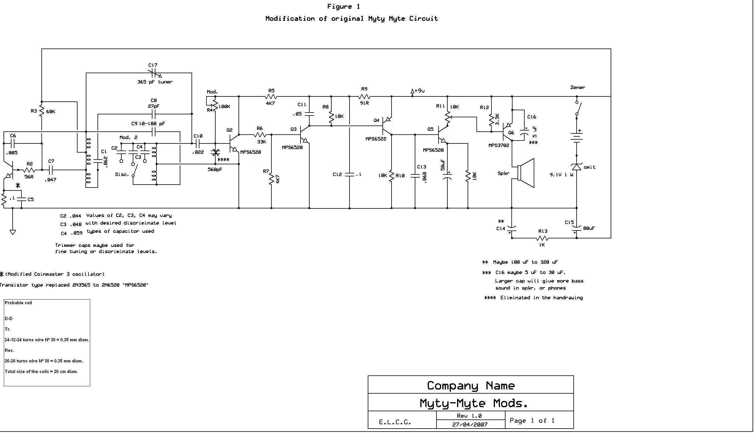

                      Myty-Myte Schematic
                      I found this in my archive.

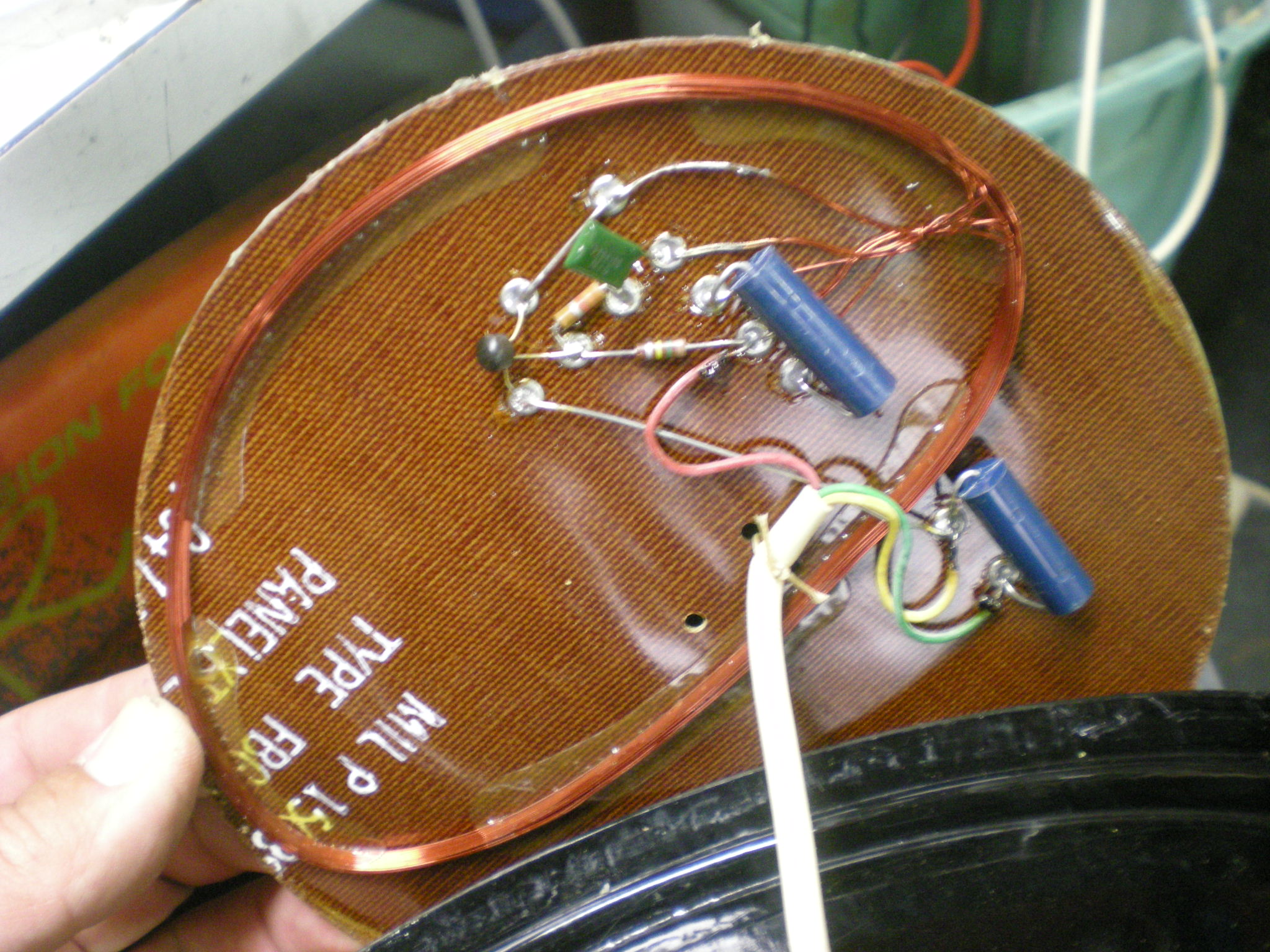

                        So would everything on the schematic left of Q2 be inside the coil housing? I'd expect to see a relatively fixed amplitude RX signal that would get larger in amplitude as the target gets closer to the coil.
                        So, given I have a bunch of better detectors, eventually I will sell this one. Should I do whatever is necessary to try and fix it or do collectors want it original and I shouldn't spend the time?
                          I tested both electrolytics with a LC-102 and replaced one just because.
                          I removed all transistors and tested them with my M3 tester.
                          No issues.

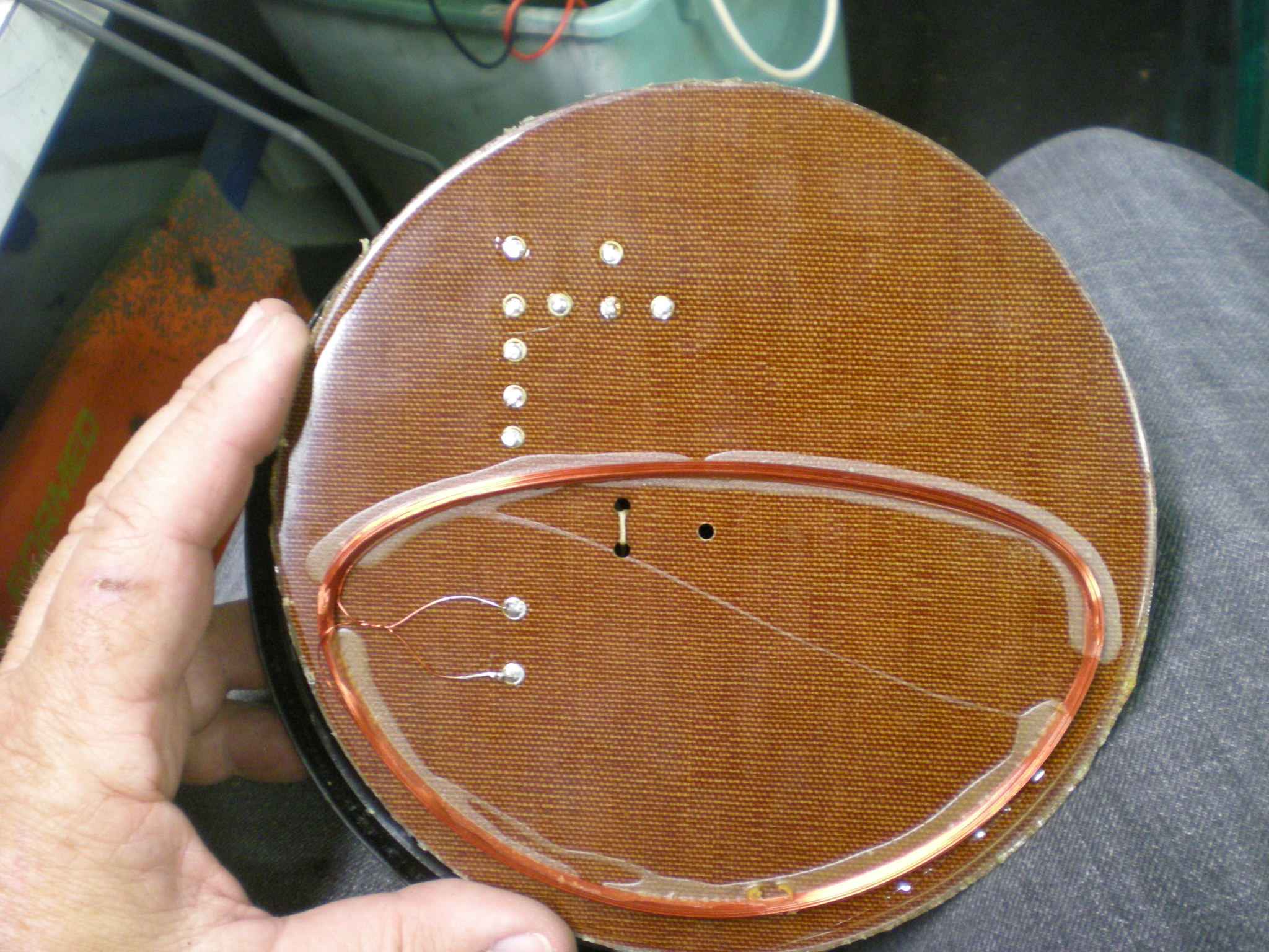

                          So I opened the coil up - and found nothing obvious wrong.
                          I tested the transistor and it was good too.
                          So I'm at a loss on this one... no clue.

                            ...BKLEIN...there is a good possibility that you just have it tuned wrong....but Not being there it is very hard to say...since you have little interest in it...I would Not repair it just offer it on Ebay as a Parts Detector......you should get at least $20.00 or more for it.....also offer it on the Compass Detector Forum and the Vintage Detector Forum for Sale...those members are more likely to respond than the average Metal Detector Forum.....Merry Christmas Joe
