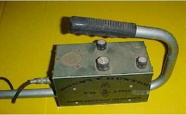

    Hi all, here is small contribution to the vintage section.
    This series is still hot for me, especially in heavily mineralized soils.
    I started to make a sort of compendium about everything around the detectors, but noticed that I may have to pass through the forum first to make it really complete (and understandable).
    So the first part will be a presention of the series itself, with original advertising stuff in found on the web.
    Next parts are already in work if not finished, I’ll start them if there is enough feedback showing that there is some interest:
    part 2: discussion in the schematic section for the back engineered PCB
    part 3: discussion in the coil section for eventually improving the coil
    part 4: discussion about maybe modifications
    back to part 1:
    I – Units
    The IB series from Bounty Hunter – formerly PNI (Pacific Northwest Instruments) are all based upon the same PCB.
    The basic differences between the units consist on additional trim pots, switches, vu-meter or jack.
    All the coils have the same specs.
    I won’t add more comments about description as the following original advertisement is really complete and the claims revealed to be true as far as I can say. (Although the claim concerning space technology maybe outdated.)

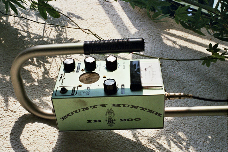

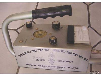

    IB-100
    The very basic version:
    (picture 2)
    (picture 3)
