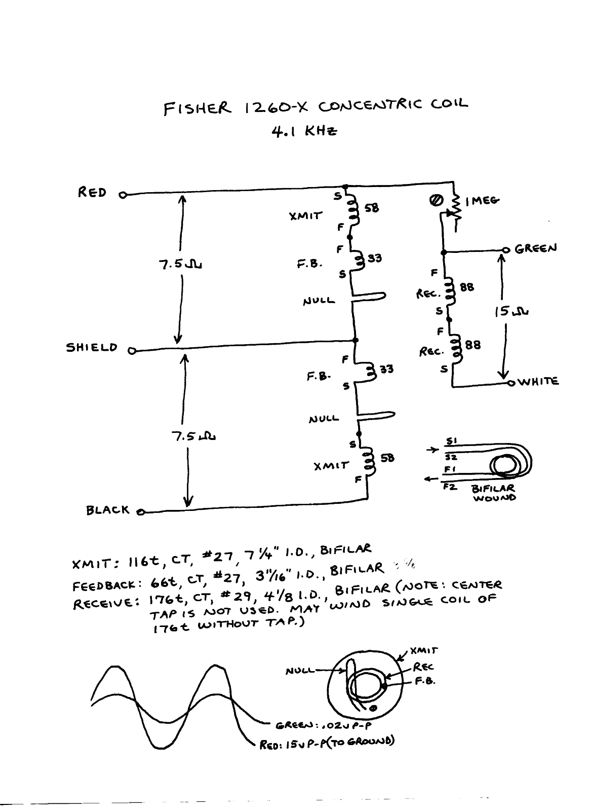

      See attached, I believe it's a WL drawing!
        A better copy
          Thanks Altra , i already have those for long time.
          Yesteraday i analyzed schematic for few hours and compared it with present device.
          Seems schematic is accurate, except the poted part that i can't compare.
          My 1260 is with LM317 at charging input.
          Also there is not 47k resistor between pins 2 and 3 at 3080 (as sugested on schematic).
          What would i achieve if i add 47k there? Nothing! Because i checked that already!
          Working frequency is 4.2kHz.
          I am thinking to replace LM324 at channel with ... let's say LF347 and maybe gain some quality there?

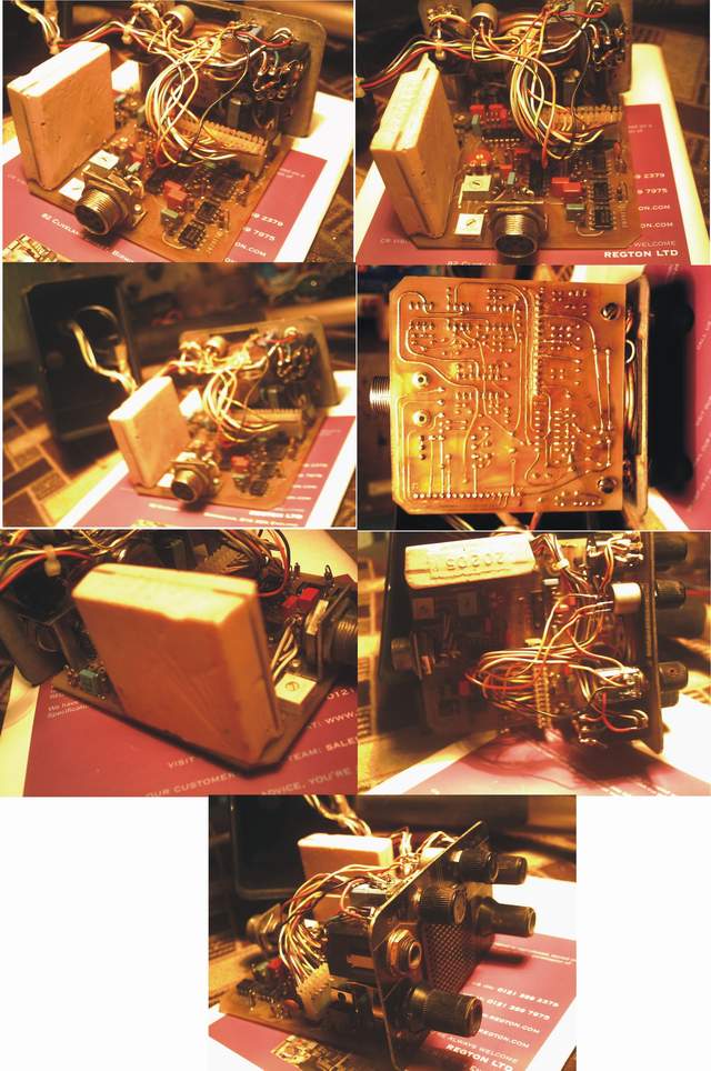

                Most recent photos:
                  Coil was surprise for me!
                  seems a coil is not 'fisher 1200 type'. more oldie, may be for LF990 553 555 series.
                  if you open any Polish forum you will see ALL-1 project.... know - it is what you want to find a data on your coil.
                  http://www.poszukiwanieskarbow.com/F...p?f=46&t=79250
                  thinking because it is clear the 555.
                    Yes that's makes sense!
                      Bifilar wire.

                        Thanks for the photos
                          Thanks Patrick!
