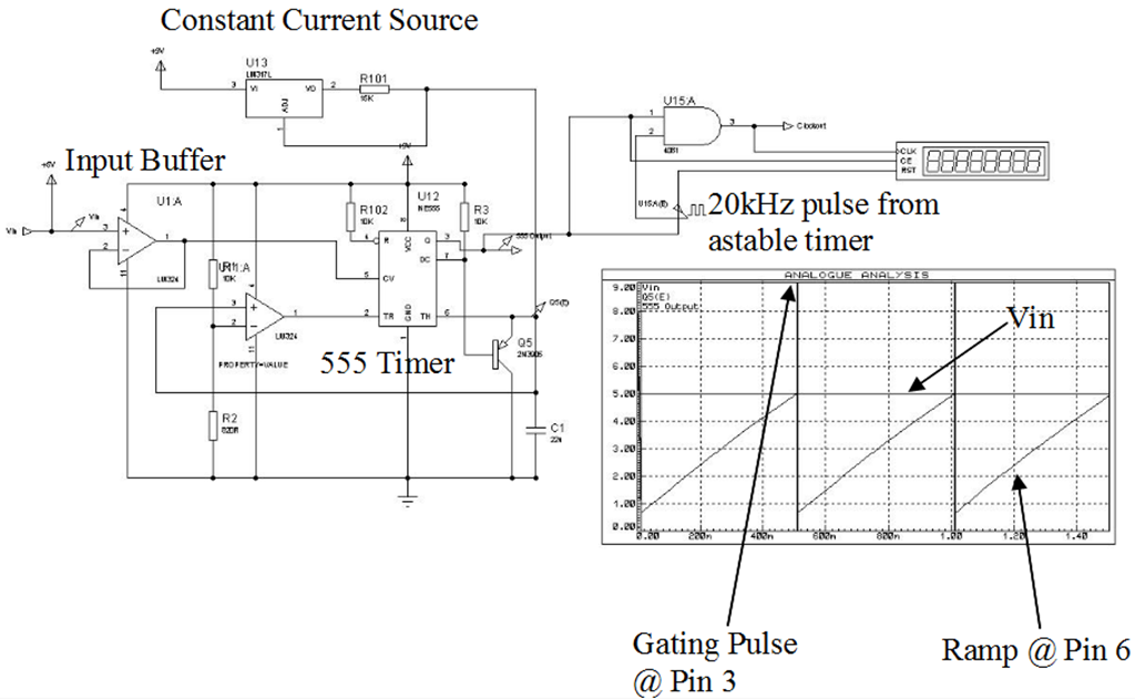

            .. well the design architecture will need to cater for a high degree of flexibility ( functional blocks and modularity ) because there is sure to be someone out there who wants to use a 555 to do the ADC function. ( I am not joking )
                    Click image for larger version  Name:	555ADC.png Views:	8 Size:	219.6 KB ID:	409049
                    I don't take it as a joke, but as an interesting option!
                    I would like to see a detailed elaboration on a separate topic!
                    I've always been drawn to knowledge before the mass advent of cheap processors.
                    I believe that many would opt for that option, if we developed it as an option here.
                    In not being able to keep up with other people here, in terms of easy sourcing of components; this can become a very serious option.

                            For the discussion about what and possible methodology, let me throw into the mix the TLV320ADC5120... 768ksps, cheaper than those so far mentioned ($2.38 @LCSC), and available. I am currently using in conjunction with a PIC32Mk0512MCJ064 (also with PIC18F57/47Q43 but with less time to do other processing) with the TLV320 configured in master mode and using the LRCK (from the TLV320) as the time base to generate all MD timing signals.
                              Answer me briefly and clearly just this, what do you think: how many ADC channels do we realistically need?
                              (Keep in mind; this is about nugget hunter, we don't want Disc here).
                              Why do you say that? I think discrimination should be on the table as it can be critical in some places. Most of the places I hunt are littered with iron flecks from old rotted cans. To a PI without discrimination they sound just like a nugget. In Africa some of the places they hunt are littered with iron-age artifacts such as arrow heads. While you & I might think they are cool, the Africans don't want to dig a 1 meter hole to pull out a spear point.
                              Without discrimination, you probably want 2 channels per TX pulse width: one for target and one for ground. So for 2 pulse widths you need 4 channels. But when running even just 2 pulse widths there may be other samples you want to take. This is why I favor direct sampling initially, it removes constraints. If I were to start with analog demods I would automatically assume 8 channels, because I would want to do some R&D.
