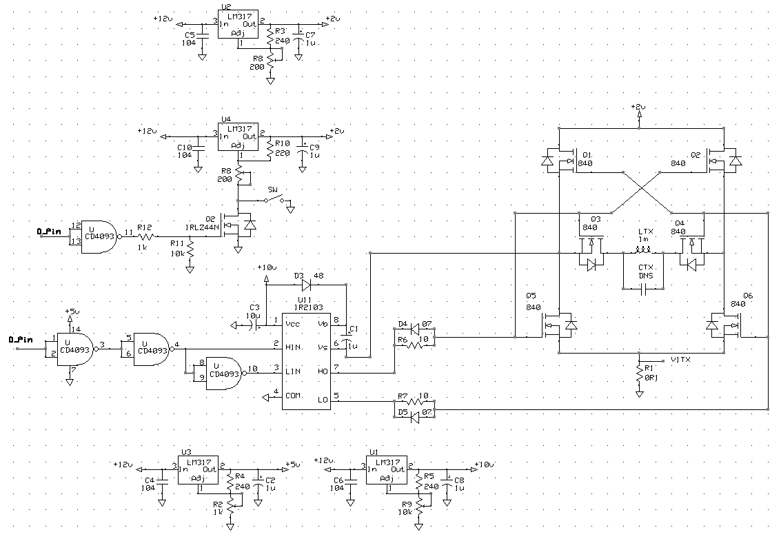

  • In meantime , LM317T (1.5A) that regulates voltage for TX supply; can be controlled by the mcu too.
    • Since the CD4093 has 4 nand circuits; it's stupid not to use them all.
      So one will serve for Off/On voltage of 2v for TX power supply, if necessary.
      And the other 3 nands can be cleverly used to square the signal coming from the Atmega; further straighten and shape into an ideal square signal.
      Because the Atmega does not give an ideal square signal, it is a bit irregular.
      Crossing through nand it becomes perfect square.

        Variety of choices relating to power supply
        The "SW" is only for testing purposes.
        • WRONG!
          Sometimes simulator may confuse unexperienced user...

                • Hi ivconic,
                  I'll try to provide some answers to your questions as per my knowledge and understanding of this TX circuit.​
                  Given that I do not have more detailed previous knowledge on these topics; I've been reading a lot about it in the last few days.
                  A dead time of 1-5% of this time would correspond to a range of 400 to 2000 nanoseconds.
                  I must admit that I am somewhat surprised with these values, all the time I thought it will be in range of few tens of nS.
                  Or this "rule" does not applies to specific design we have here?
                  The dead time should be as short as possible to minimize losses but not shorter to cause shoot-through. During the dead time all FET switches are off and any energy stored in the coil gets dissipated. So you need this period short to save time and power required to re-charge the coil on the next cycle. How short exactly I assume will depend on your FET driver capabilities and the speed of the FET switches.
                  Does the pulse width plays any role in this particular design with H bridge?
                  I think it was already mentioned that the duty cycle is always 50%, so your pulse width is always 1/2 of the period. You can only change the period (frequency). Does the frequency matter? Yes, I believe it does. A higher frequency allows more samples to be integrated and increase the signal-to-noise (SNR) ratio. A higher frequency might hinder sensitivity of slowly decaying targets because current polarity is switched while the slow target has not fully decayed yet. Fast targets remain unaffected. Carl has posted a very good and detailed explanation of that in a thread called Optimizing target responses. A higher frequency will cause a higher power consumption as well. It's also possible to combine two different frequencies and process the RX signal separately for each frequency.
                  What is the situation at this particular project?
                  Do we benefit from the constant current source or not?
                  Yes, there's benefit. Using a constant current TX circuit the current in the coil rises and falls rapidly, like a square wave. The sharp current edges create higher eddy currents in the targets, hence they should provide a stronger signal to detect by the RX circuitry. Also the energy in the coil is not wasted (compared to the traditional PI), only its direction is changed between the cycles. Of course, there are some small losses and these produce the "tilt" that is to be compensated.

                  • I don't know the answer to the dead time question. So far, Paul has seen no need for any dead time at all, but I don't know how far he's explored this circuit. I plan to go up to 1200-1500V on the flyback, which is exceptionally fast and useful for small gold. But I also want to look at very slow transitions, such as might be used for a 100 amp/100ms tow-sled version for Atocha bars, the same as Eric Foster did for Mel Fisher. I have no idea what dead time might (or might not) be needed, but that's why I'm using 2 timer pins with dead time adjustment. I want the option.
                    Pulse width plays the similar role here as with a normal PI. A short pulse width is sufficient for low conductors while a wide pulse width is needed for high conductors. The difference here is that each pulse settles to a flat-top current almost instantaneously. In a traditional PI, the current exponentially rises. That's probably why you see an increase in sensitivity when you increase the pulse width: the coil current increases. In CCPI, a 20us-wide pulse is sufficient for a 5us target (sub-gram nuggets) and increasing the pulse width will not increase current or depth, and will in fact reduce depth by reducing the integration rate.
                    Constant current is the key to this whole concept. But there are 2 ways to achieve CC. One is to create a high-impedance CC source, apply it to a circuit, and get whatever voltage is developed. The other way is to use a voltage source with current monitoring and use feedback to servo the voltage to achieve the current you want. I'm using the latter method as it's simple and more power efficient. The use of CC is fundamental to the basic operation of being able to see a target response while the coil is still energized, not because of noise or power loss. However, better power efficiency (than a traditional PI) is a fortuitous fallout of the operation.
                    A white paper describing the theory of operation would help a lot, and if I ever get some spare time (!) I will try to write something up.
                    • Originally posted by lucifer View Post
                      A nice benefit of CCPI is that power consumption is practically constant for any frequency. Transition losses (the cause of tilt) increases with frequency but they are a very small percentage. Somewhere I posted the 2-frequency TX waveform I'm considering:

                      • Thank you both; Lucifer and Carl, on additional clarifications.
                        I will focus only on the essential issues.
                        So the dead time is still something to be determined.
                        What we know for sure so far is that it will be in the range of few tens of nS to possibly a few hundred nS.
                        Using two pins to separately switch the positive and negative sides has therefore a visible advantage over my attempt to do everything with one pin.
                        Because in the case of two pins, each pin can be individually timed in the code and this gives a wider range of settings.
                        While my attempt lacks in that, because then the dead time is defined by the delay in the circuit that inverts the signal from the pin.
                        Whether it is a dedicated inverter circuit (4069 and similar) or a NAND circuit (4093).
                        Both involve a delay of a few tens of nS. I haven't checked the datasheet but I'm pretty sure it's pretty close to accurate.
                        Maybe in practice it will be quite enough and maybe that approach is good enough. But it may not be good with every choice of mosfet.
                        So the two pin selection is still a big advantage.
                        My idea was to practice a "poor man's solution" approach. And I'm not dissatisfied with what I saw in the simulator.
                        Duty cycle... pulse width... Generally 50:50% is the right solution.
                        But in this case, reading Carl's arguments; I think for the purposes of this project, Carl is right.
                        So let's accept that 20uS is the pulse width.
                        Should it remain constant or leave the possibility of additional settings in the code?
                        I think the choice of mosfet will also play a role.
                        We need to see how the "regular" IRF740/840 type behave.
                        Paul has already done a significant amount of work on that, so it's no mistake to assume that the IRF740/840 will be doing a good job there.
                        Constant current. I assumed it was of great importance. But I had to ask and get confirmation.
                        On one of the schematics I posted, you can see a logic level mosfet IRLZ44N with a BC337, in which the mosfet plays the role of a variable active resistance,
                        and the source resistor limits the maximum current.
                        By simply calculating that resistor, you can calculate the constant current that will flow between the drain and the source.
                        If the gate is pulled up high, then there is no regulation. Maximal constant current, defined by source resistor will flow between drain and source.
                        But if PWM is applied to the gate; then the current can be additionally regulated within the range defined by the source resistor.
                        It is an interesting solution because it is possible to fine-tune the constant current level.
                        If the maximum current allowed for the assembly is, say, 500mA... and fluctuations occur during operation;
                        the fast PWM control can immediately react and compensate for the current drop due to these fluctuations.
                        Now that I'm writing this, I realize that in that case, there should be room for compensation, so for a consumption of 500mA,
                        maybe a circuit should be dimensioned that will be able to deliver something more than that.
                          Click image for larger version  Name:	image.png Views:	0 Size:	4.6 KB ID:	411609​
                          Me: "...So let's accept that 20uS is the pulse width..."
                          In the case of 25kHz yes.
                          In the case of 5kHz? 100uS?
                          Obviously the tilts will occur less at 5Khz and more at 25kHz, in overal timings scheme.
                          So the "dynamic" compensation is needed.
                          But that should not be the problem, right?
                          Actually; tilts will be more "visible" at lower freq.
                          And almost insignificant at higher freq.
                          • Now about the "tilts"...
                            So, Carl, how did you envision solving the tilt compensation problem? I guess snubber network is not a good solution?
                            "Tilts" or spikes are common in the waveform during transitions and are caused by parasitic capacitances and inductances.
                            Can be compensated by adding a snubber network.
                            Now... I wonder (I ask you) if adding a snubber will affect the RX signal?
                            It shouldn't (directly) if the searchhead has two separate coils, one for TX and one for RX, right?
                            But; the snubber network can affect the current in the coil (and RX indirectly).
                            The snubber network is connected in parallel with the mosfets, and it can create a path for the current to flow through
                            during the switching transitions. This can affect the current in the coil and the voltage across the mosfets.
                            Therefore, it's important to carefully choose the values of the snubber components to balance the tradeoff between reducing
                            voltage spikes and ringing and minimizing the additional losses in the circuit.
                            I honestly didn't even know about this solution until a couple of years ago, when Davor pointed me to it and gave me some solutions.
                            But it wasn't a project anything like this one. It was a "slow" H-Bridge solution with very high currents, 14-30A.
                            I don't see how you're going to solve that problem...unless you use a very special "switch" circuit to power the TX stage.
                            I haven't looked at the datasheet so I don't know if the solution from your schematic includes such a possibility?
                            In a few simple sentences; can you explain your solution?​
