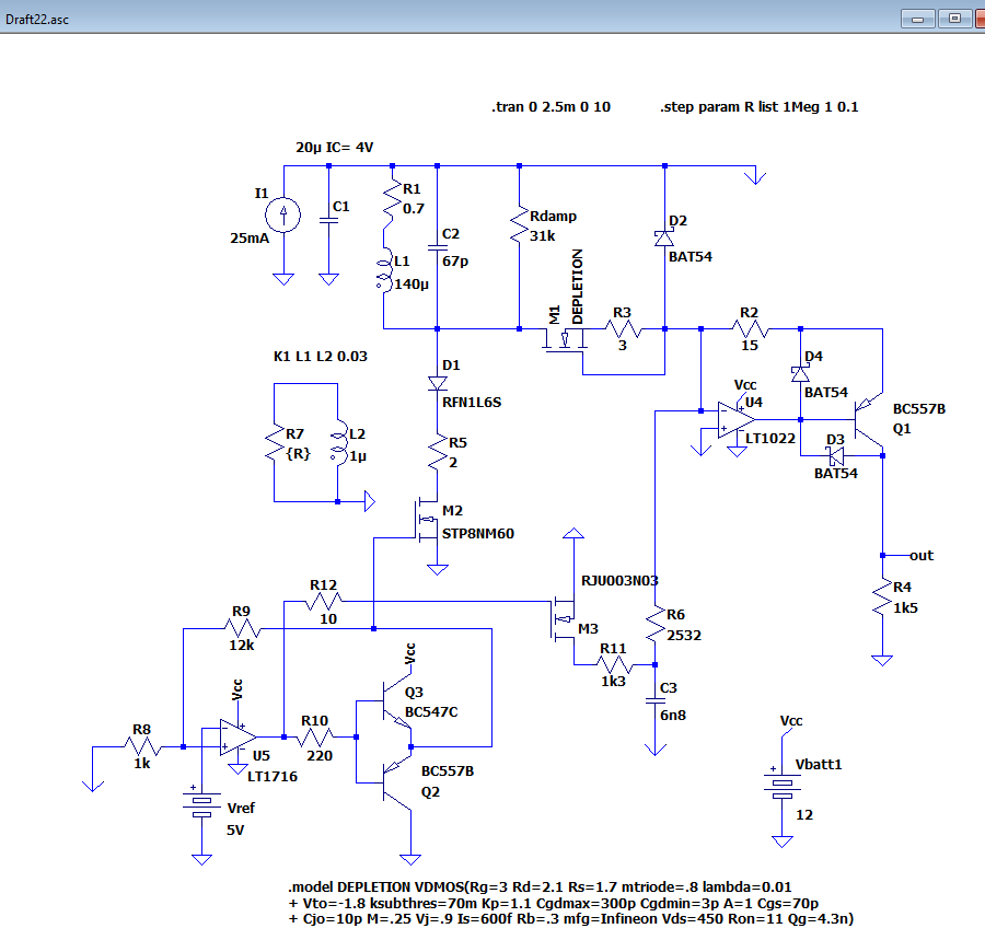

            • #67
              I agree, in a current mode coil the current is
              In other words, the current is exactly the same waveform as the incoming B-field. You simply lose the derivative. I've built a Magnetic Field Probe using this concept and it works exactly as the math suggests. I don't see any targets getting stretched out in time.
              Because you need to dissipate the energy of the B-field before shorting the coil (in a monocoil) or balance it out in a Tx/Rx combo. In other words, the coil has to be shorted when the current approaches zero. Only then the target energy becomes visible.
              Here's a concept circuit. Rdamp in parallel with the depletion mosfet (at high Rds with Vgs < 0 due to the current in R3) dissipate all the energy, then as I(L1) approaches zero the depletion mosfet is at Vgs ~ 0 and the coi sees a resistance (R1 + Rdson + R3) ~ 15 ohm.
              The blue trace is the response to a 1us taget, the green trace is a 10us target, the red trace is no target. The responses are extended far beyond the time constant of the targets.
              Click image for larger version  Name:	Schermopname (258).png Views:	0 Size:	42.0 KB ID:	409447
              Click image for larger version  Name:	Schermopname (257).png Views:	0 Size:	34.2 KB ID:	409448
              Draft22.zip
              • #68
                Draft22.zip
                Interesting use of the depletion FET ... this scheme has some similarities to my ZP damping scheme.

                  • #70
                    Interesting use of the depletion FET ... this scheme has some to my ZP damping scheme.
                    Yes it's similar, however it has elements that make the adjustment less critical:
                    - constant energy to drive the coil (fixed charge in C1 independent of Vcc)
                    - Rdamp to preadjust the discharge (speed not a concern because of the spreading in time of the shorted coil's response)
                    - a source resistance to bias the depletion mosfet according to the discharge current (soft transitions)
                    - coil ends up connected to a virtual ground.
                    A feedback loop only has to slightly vary the energy in C1 (by changing Vref) in order to compensate for ground effects and/or temperature variations.
                    And if desired, a decaying signal with time constant (R1 + Rdson + R3) / L, generated by an RC circuit synchronized to the TX pulse, can be subtracted at the preamp to refer the target signals to a zero baseline.
                    • #71
                      Here is the LTSPICE sim for the previous post ... ZPDAMPER.zip
                      moodz.
                      • #72
                        Have you built a real circuit ? ... I put in some extra features to control the TX energy and what was noticed in practice is that this caused muting of target sensitivity.
                        moodz.
                        • #73
                          moodz.
                          I haven't built anything because these ideas were triggered by Carl's post #52 from two days ago.
                          I expect that the TX energy would need to vary by a tiny fraction since the point of equilbrium is so sensitive. I might be wrong though. Too early to say but I'm certainly planning on building this.
                          Here's an example:
                          Click image for larger version  Name:	Schermopname (259).png Views:	0 Size:	39.8 KB ID:	409460 Click image for larger version  Name:	Schermopname (258).png Views:	0 Size:	35.8 KB ID:	409461
                          Draft22.1.zip
                          • #74
