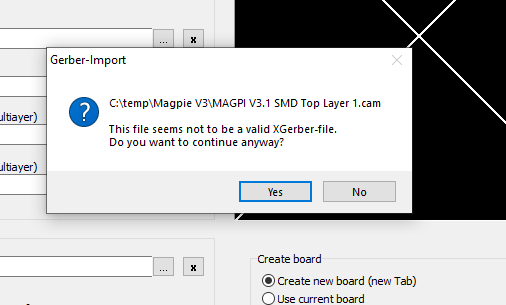

                  I wanted to look at your work, but not one of the several online services I use, nor the Sprint Layout 6 software; can't open your gerber files?
                  Whereas, say, I can open Carl's gerber files in any of those.

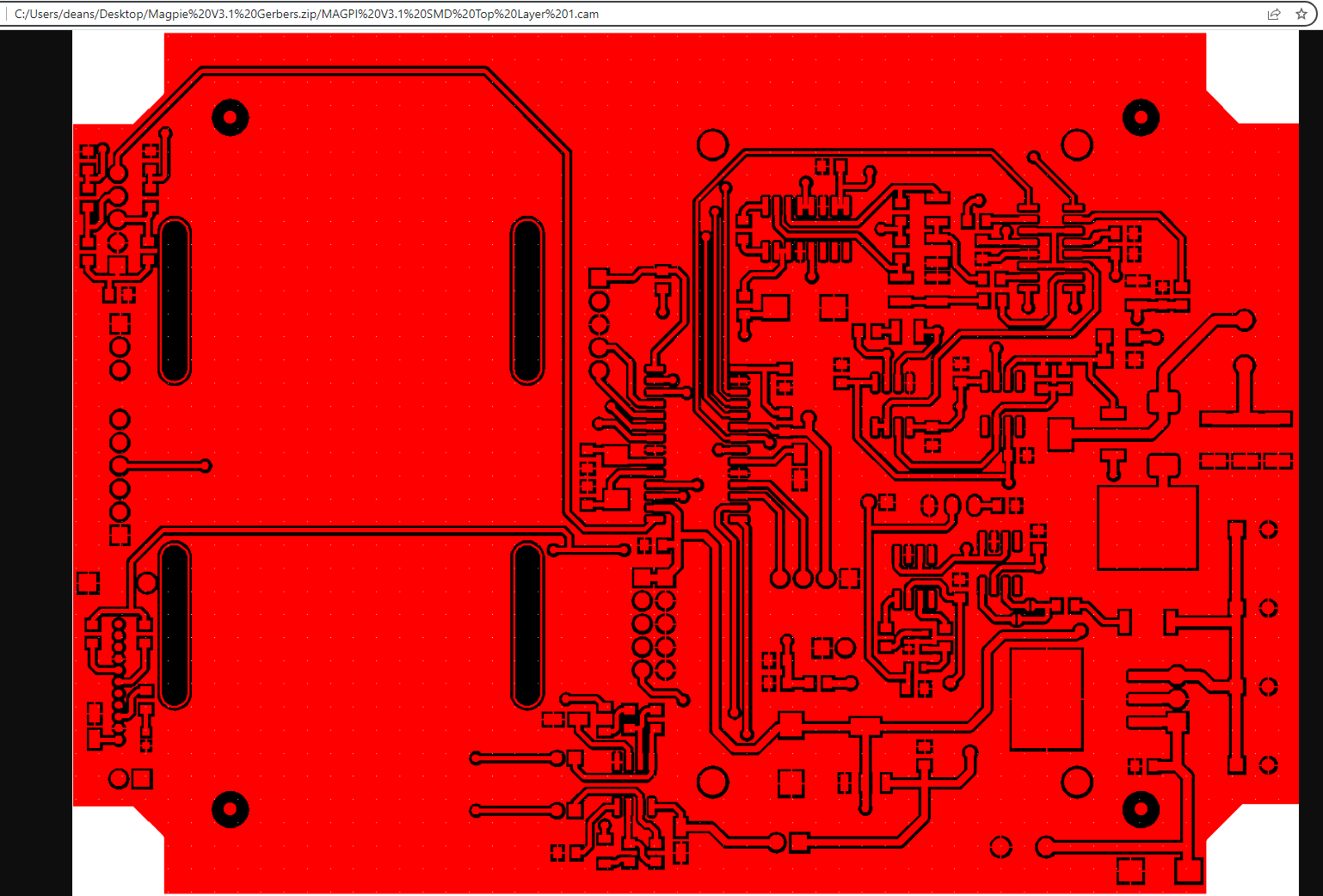

                    Try these CAM files, let me know if you have any issues.

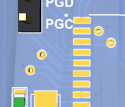

                      I see the gerbers do not show the ground vias very well so have added a 3D pdf to the dropbox link and when you zoom into the PCB near the MCU for example you can see the GND retrun vias little blue dots next to the signal vias.

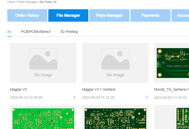

                      • #41
                        No, again:
                        Sprint Layout 6
                        JLPCB:
                        • #42
                          I just dragged the CAM file onto the google browser desktop and it opened the file.
                          Suggest to give this a go and if you have any issues I will try to convert them to PDF.
                              Click image for larger version  Name:	image.png Views:	0 Size:	186.2 KB ID:	411779​
                              Pictures like that may help, to be imported as background in Sprint Layout and than redrawn.
                              Usual method I practice when have not any other way to do it.

                                I guess this is one of "those" days when nothing works for me.
                                In meantime I tried few other online gerber viewers and also cam viewers... NONE can open the zipped folder or any file alone??
