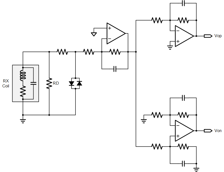

    I am in stage of re-drawing your schematic in different software. So I want perfectly accurate schematic according to which I will draw my pcb.
    And I want to pick best option. In your schematic you put all together, all the options. And it is confusing.
    Why would I want to remove IC2? What are the pros&contras of that.
    Is the coil same at both options? Single coil or coil with center tap?
    At Tinkerer's schematic R1-4 are with values and at your schematic with zero values. If zero values then why those exist on schematic? Placeholders?
    Also at Tinkerer's schematic there is significantly higher amplification than on your schematic; I guess it is due loss because of the R1-4 resitors.
    We will agree that R1-4 will introduce more noise in signal path, so imho is better to omit them and use lower gain at opamps, as you did.
    But than I should omit even the placeholders or not?
    Can you (if not asking much) separate both options in two separate schematics and explain in short both options, pros and cons for each one.
    This way is little bit confusing. I don't want both option on my pcb, I want clear one option and to avoid placeholders for componentes I will probably not use in option i picked.
    I am sorry if I ask too much. But two separate option as schematic of RX will reduce any further confusion.

          • #65
            Here is the voltage mode preamp, based on Tony's original schematic:
            You set the gain with resistors and it has more stable gain vs coil resistance.
            Here is the same schematic but in current mode:
            The only difference is the input resistors = 0 and coil resistance determines gain. Will have lower thermal noise.
            Here is the single-ended version operating in voltage mode:
            This should have slightly lower noise than the differential voltage mode above. Replace the input resistors with 0 ohms to make it a single-ended current mode preamp with even lower noise.
            • #66
              Olly and KingJL there is no need for you to "defend" Carl from me, because I consider him a very good friend and hence my freedom when I address him.
              And believe me, I am addressing these and similar questions and "inquiries" to Carl only and only for educational reasons.
              And I'm a "slow learner" and often have need for further explainations.
              I could have contacted him via email and I'm 101% sure I would have gotten the same answers.
              But I deliberately do it on the forum, publicly, to leave a trace, for the next generations of enthusiasts and those who want to learn something.
              I think that Carl understands my behavior very well and that I don't need to make any special excuses.
              And of course; my main motive is to learn something new but also something old that I didn't fully understand.
              Thanks Carl, clear and understandable as always!
              So now I get it. All three options are equally good, it seems to me.
              Choice will be conditioned with opamp&coil specs, in short.
              And now I am tempted to draw pcb with all the option included!!!
              And to switch between the options with jumpers.

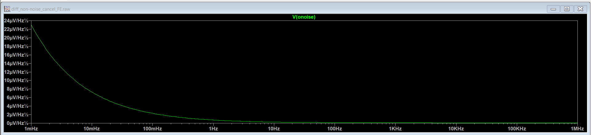

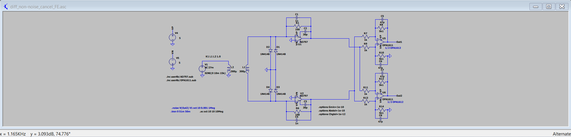

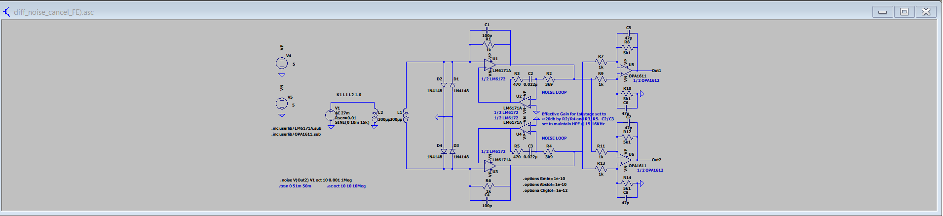

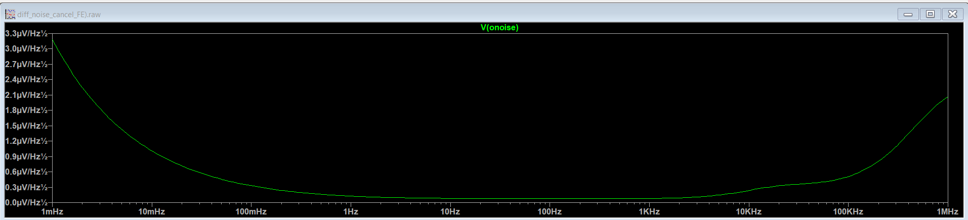

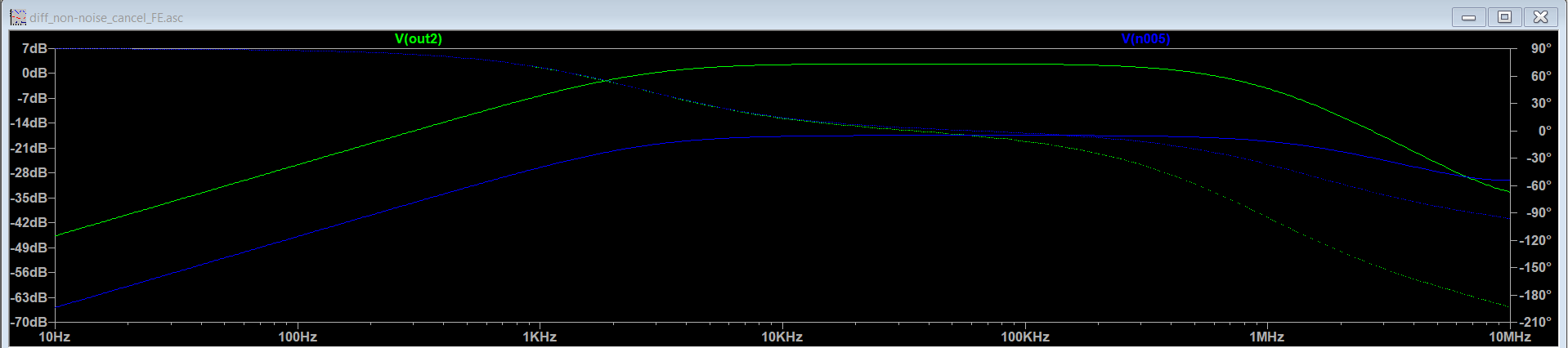

                          Carl,
                          I once worked with a very successful project manager who would say "In every project, there comes a time that we need to shoot the engineers and produce a product!"

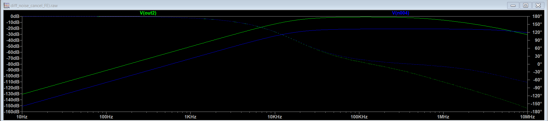

                          That being said, I have been playing around with the addition of a noise cancelling loop to the first stage of the differential FE. I believe there are significant improvements overall noise performance of the FE with these loop(s). Also there is significant improvement of the suppression of the power mains interference (50, 60, & 400 Hz) area.
                          Providing screen shots of both noise loop and non-noise loop circuits for comparison:
                          AMX FE non-noise cancel circuit and simulation outputs (same as published in AMX V1.1):
Name:	Diff non-noise-cancel.png
Name:	Diff non-noise-cancel noise.png
Name:	Diff non-noise-cancel AC analysis.png
                          AMX FE with noise cancel circuit and simulation outputs:
Name:	Diff with noise-cancel.png
Name:	Diff with noise-cancel noise.png
Name:	Diff with noise-cancel AC analysis.png
                          If interested, I can provide sim(s).
