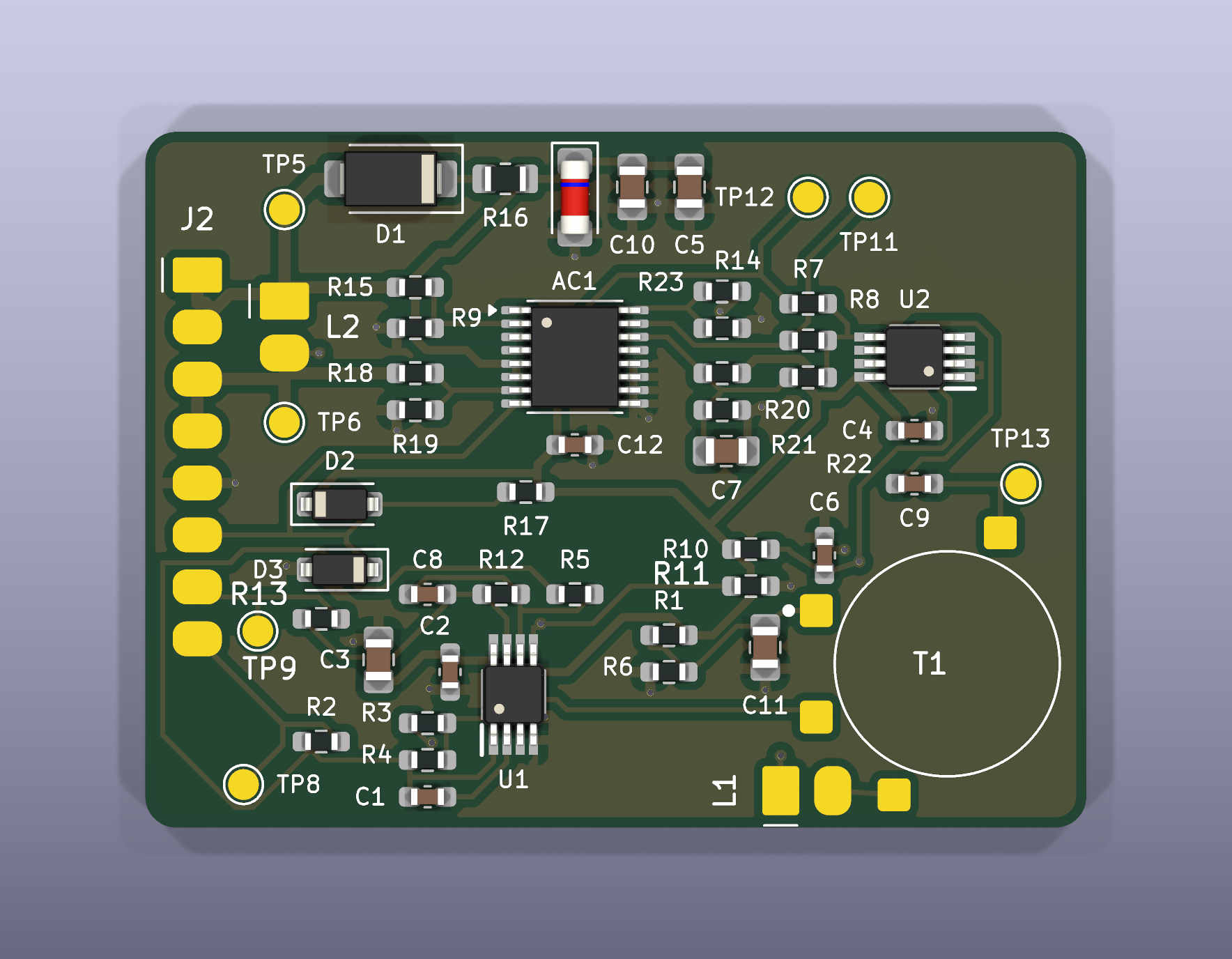

              --- The smart probe lost its microcontroller ---
              Bigger change. The probe was going to have an STM32G0 inside the coil doing 12-bit vector nulling with its own DACs, temperature compensation and a coil ID in flash. It doesn't anymore.
              The probe is now passive: it powers itself off the rectified TX drive, and the two digital pots that do the balancing are clocked by the transmitter waveform itself. The base bit-bangs one data line in sync with the timer, so the cable carries a single digital wire instead of a protocol between two MCUs.
              There's a nice accident in there. My switching pattern has 18 segments per period, which means 9 clock pulses - exactly one I2C byte frame, 8 bits plus ACK. A three-byte transaction fits in four TX periods. I wrote a host test that plays both waveforms tick by tick with an independent protocol monitor watching the line, and the bytes come out clean with 1.2 us of setup margin against a 0.1 us requirement.
              That change deleted a whole microcontroller, its firmware, the base-to-probe protocol, the temperature sensor and the coil ID scheme. Best kind of design decision - the one where the parts count goes down.

              - probe PCB designed, built, schematic reviewed against the netlist

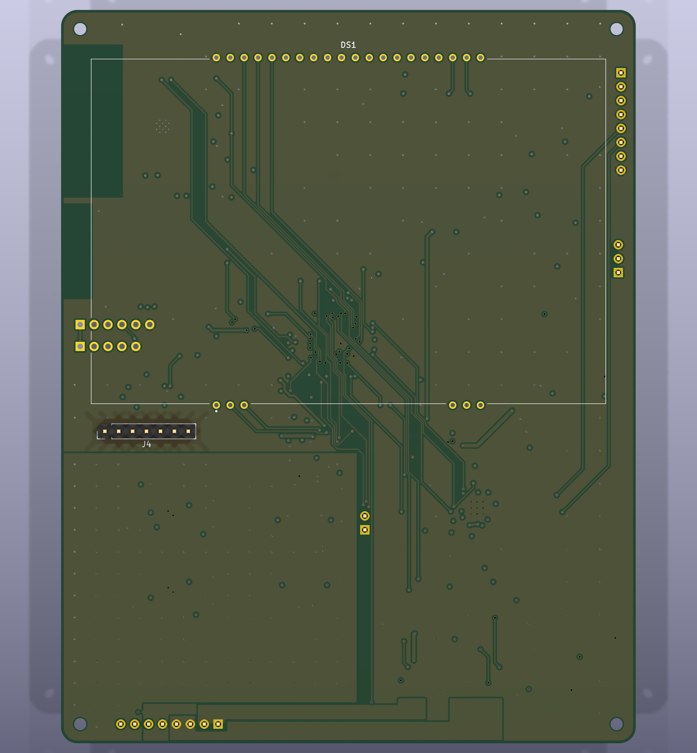

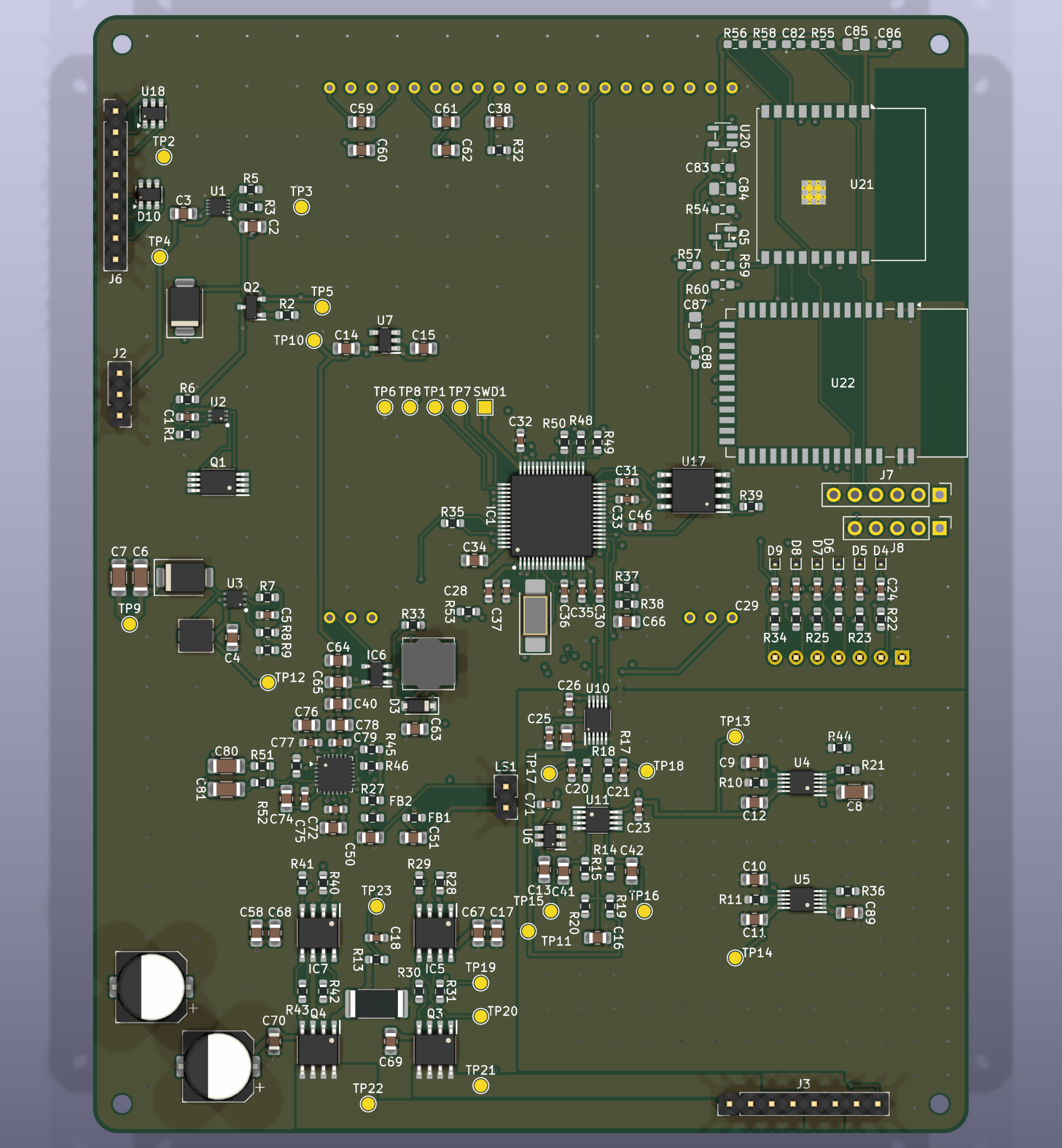

                  Quick progress update: the PCB design for the Spectral-G4 is finished.
                  This time I did it a bit differently. An AI agent did the hands-on work in KiCad with Konnect (placing parts, routing, syncing the schematic to the board). After every change, my own tool, pcb-inspector, checked the board: DRC/ERC, schematic parity, decoupling, grounding, track widths and so on. If it found a problem, the change was fixed and checked again, and the loop ran until the board came out clean. The agent did the repetitive work, but I made every design decision myself. (More details in my other thread, if anyone's interested.)
                  Next I'm assembling the first boards and starting the first bench tests: power rails first, then the analog front-end with the dedicated coil. I'll post results as soon as I have something to show.
                  Series 0 update: 4 of the 10 units are now reserved, so 6 spots remain. Shipping is still planned for January / February 2027. If you'd like to claim one, send me a PM here or get in touch through https://spectral-g4.pl/
                  Thanks again to everyone following the build and to the Series 0 supporters.

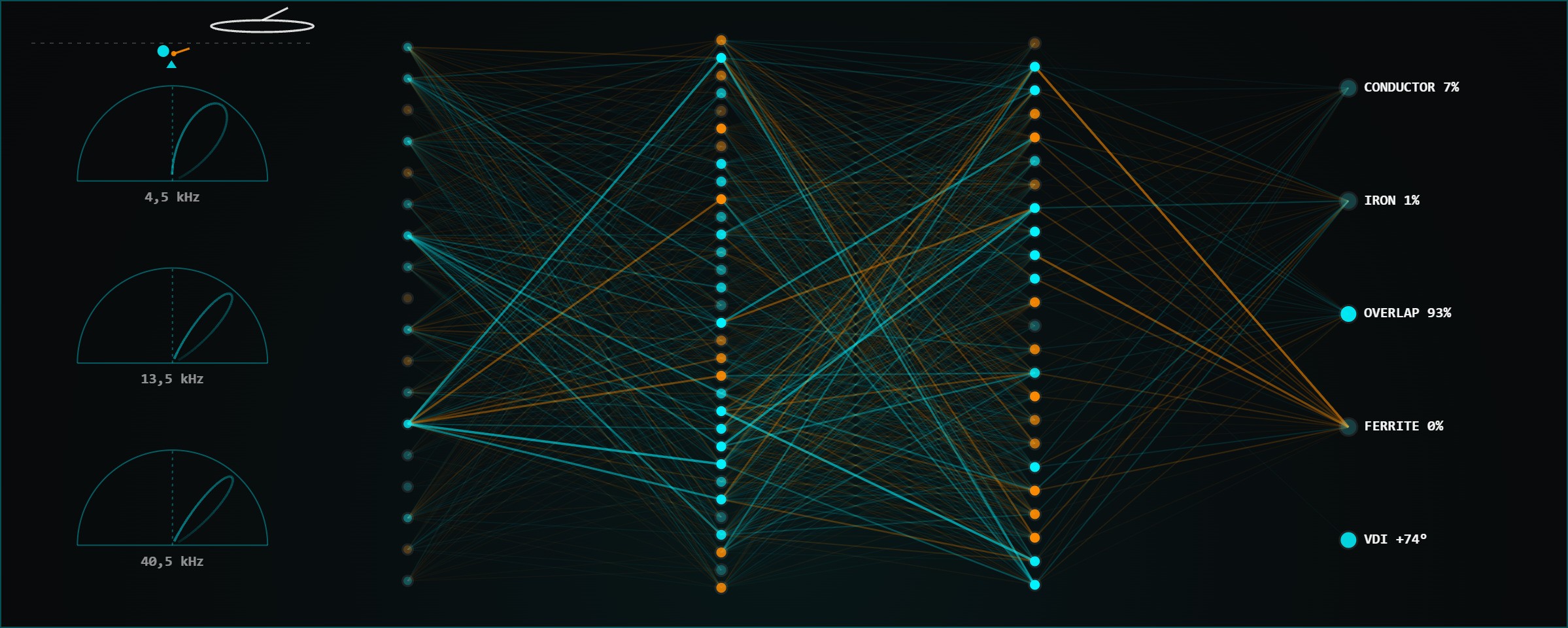

                    Hi all,
                    Back from the break, as promised. Before the boards hit the bench, here's how the finished detector will look - three pictures attached.
                    --- Layout ---
                    The controller sits in line with the grip and mounts to it from below. The thumb side of the grip runs straight into the front panel, so the keys are right under your thumb. The back stays clear for the two M12 sockets, and the coil cable drops in front of the grip, away from the fingers.
                    Six-key membrane keypad, flush with the panel and sized for gloves. Sealed 3D-printed enclosure, 128 x 157 mm.
                    Khaki shaft in three sections with cam locks and a carbon lower section, an adjustment clip under the grip, and a fixed armrest with two legs underneath, so the detector stands on its own when you put it down. 12x9" DD coil.

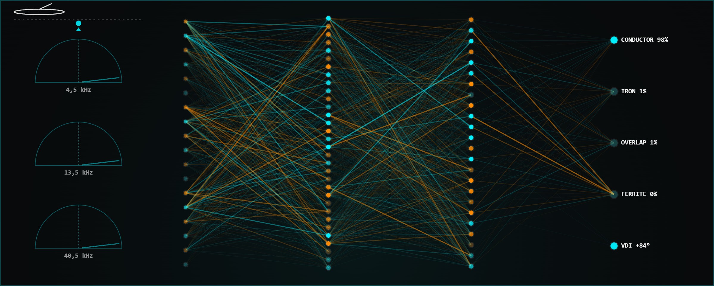

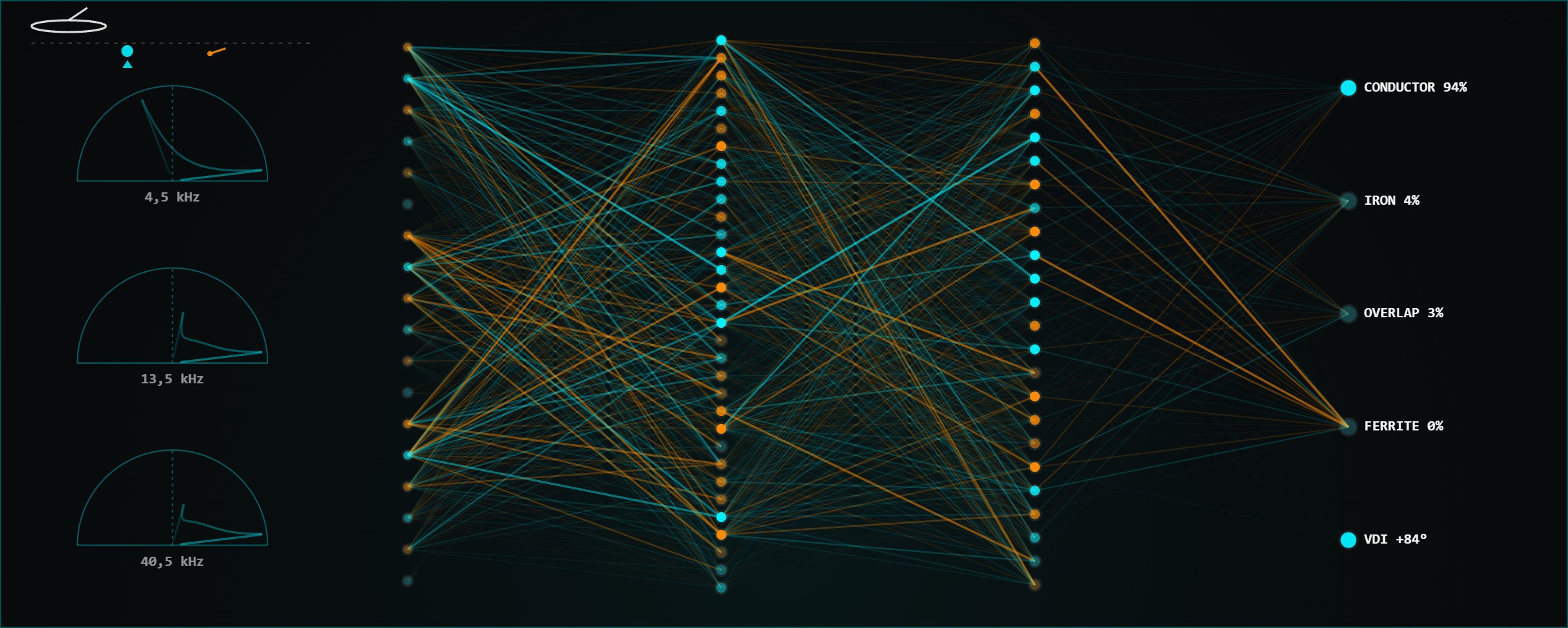

                    --- Screen ---

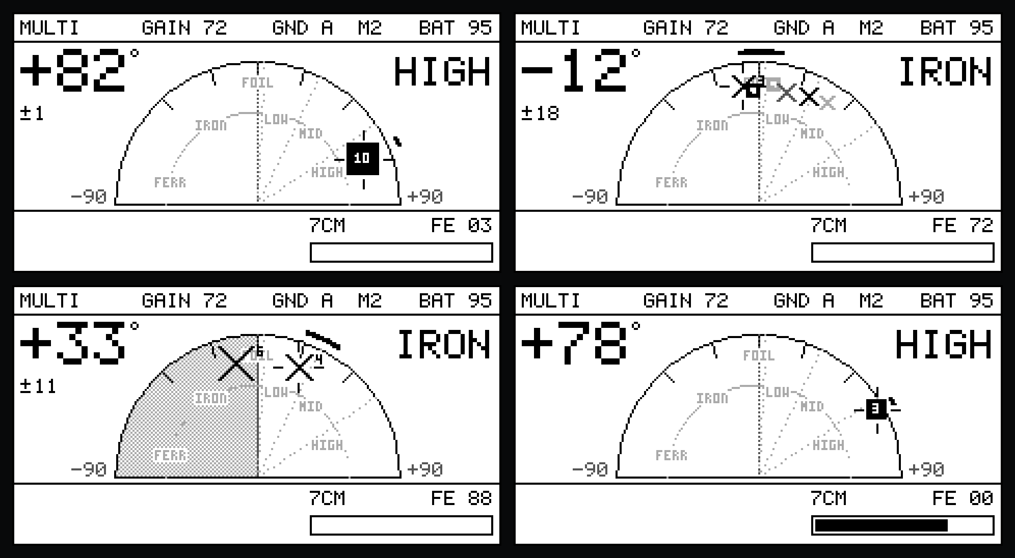

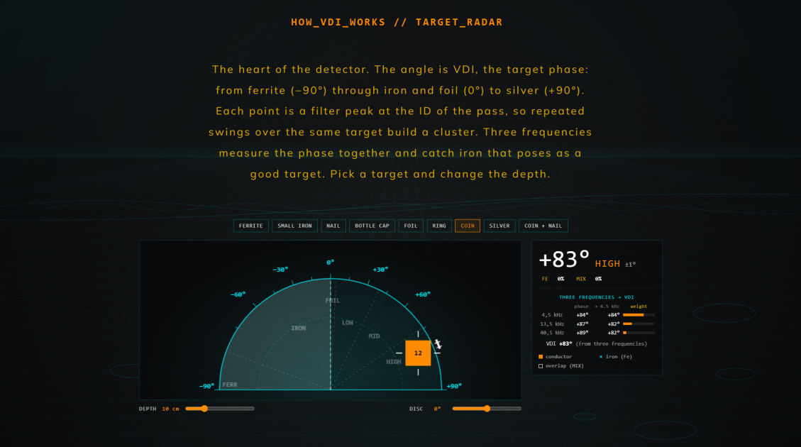

                    Target Radar, carried over from my earlier single-frequency build. VDI is the angle, signal strength is the radius, and the last two seconds of readings stay on screen as a fading cloud. A coin draws a tight spot, junk scatters, iron splits in two.
                    --- Next ---

                        This week went into the VDI and the Target Radar - screenshot attached.
                        --- VDI ---
                        The VDI is the target phase in degrees, the same scale as on my single-frequency build: ferrite at -90, iron between -90 and 0, foil just above 0, and conductivity rising to the right up to silver at +90.
                        With three frequencies each tone is converted to the 4.5 kHz scale and weighted where it reads best: 40.5 kHz carries foil and low conductors, 4.5 kHz carries coins and silver. If the three agree, it's one clean conductor. If the phase climbs with frequency faster than a conductor's would, that's iron. If it climbs slower, that's two targets under the coil.
                        --- Radar ---
                        One point per swing: the peak of the motion filter at the ID of that pass. Repeated swings over the same target land in the same place and merge into one marker that grows and shows the swing count. A coin builds one solid block, a bottle cap scatters, a nail splits in two.
                        The radar is a true semicircle with the scale linear across, so coins and silver don't get squeezed into the corner, and a weak, deep target stays far enough from the centre to read its angle.
                        --- New on the arc ---
                        A short bar just outside the arc shows how well the three frequencies agreed on the last swing. A coin gives a short tick. A nail lying across reads around +30 on one frequency, but its bar spans +29 to +48 and the iron flag picks it up. That's the part a single frequency can't show.
                        The DISC range is shaded on the arc, so you can see straight away whether a target falls in the silenced zone.
                        --- Status ---
                        The screenshot is the same DSP and radar code fed with modelled targets, all covered by tests on the PC. The real check comes when the board is up and the coil goes over real coins and nails. The demo is on the project page, spectral-g4.pl, if you want to play with it.
                        For those who swing multi-frequency machines with a 2D display: does an agreement bar like this tell you something useful, or would you rather read it some other way?

                        • #57
                          Hi all,
                          After the radar, the neural network. Three screenshots attached: a coin on its own, the same coin with a nail lying right next to it, and the coin with the nail further away.
                          --- What it does ---
                          The classic VDI reads the phase at the peak of the signal. The network looks at the whole swing around that peak, on all three frequencies at once. Like the detector itself, it doesn't know where the targets are. It only sees the signal humps, and it gives a verdict for each hump.
                          Over a single target the vector grows and fades as the coil passes, but its angle stays put. When a nail lies a few centimetres from a coin, both are under the coil at the same time and give one signal. The coil reaches one of them a moment before the other, so the vector turns during the swing. A single reading at the peak only sees the mix. The network sees the turn.
                          --- The screenshots ---
                          At the top left, the coil passing over the targets, to scale. Below it, one arrow per frequency (4.5 / 13.5 / 40.5 kHz) with the trail it left during the swing. Every frequency is shown on the same VDI scale as the radar: ferrite -90, foil around 0, silver +90. In the middle, the network itself, lit up for that hump. On the right, the answer: conductor, iron, overlap or ferrite, plus the VDI of the conductor. The small marker under the strip shows which hump the answer belongs to.
                          Coin on its own: the trail is a straight line at +84 on all three frequencies. The network says conductor, VDI +84.
                          Nail about 4 cm from the coin: one signal, and the trail turns into a loop on every frequency. The classic reading at the peak drops to +37, a low conductor. The network calls it an overlap and still puts the coin at +74.
                          Nail about 30 cm away: two separate humps, two separate verdicts. The nail reads iron, the coin reads conductor at +84. Here the classic gets both right as well. The network only earns its keep when both targets are under the coil at once.
                          --- Status ---
                          This one is already implemented: trained, tested and running live in the demo on the project page. It's small and fits on the G474 with plenty of room to spare, no separate AI chip needed.
                          It's trained on the physical target model, the same one behind the radar demo, not on real swings yet. Once the board is up I'll record swings over real targets and retrain on those. Where it still struggles: a weak nail next to a strong coin often comes out as a plain conductor (the VDI is still the coin's), and a nail lying right on top of the coin hardly turns the vector at all. Weak, deep signals are harder too.
                          The classic VDI stays. It's the baseline, it labels the training data, and it's the fallback when the network isn't sure. The plan is a Classic / Network / Both switch, with Both showing where the two disagree.
                          --- More models planned ---
                          This is the first model, not the last. Planned next:
                          - ground: learning the local soil and rejecting hot rocks,
                          - noise: pulling weak signals out of EMI for more depth,
                          - depth and size estimate from the same swing.
                          All of them small, all running on the G474.
                          The demo is on spectral-g4.pl if you want to try it: pick a target and change the depth.
                          For those who hunt trashy sites: which overlapping pairs fool your machine most often? I'd like to have those in the first real dataset.
                          Cheers​
