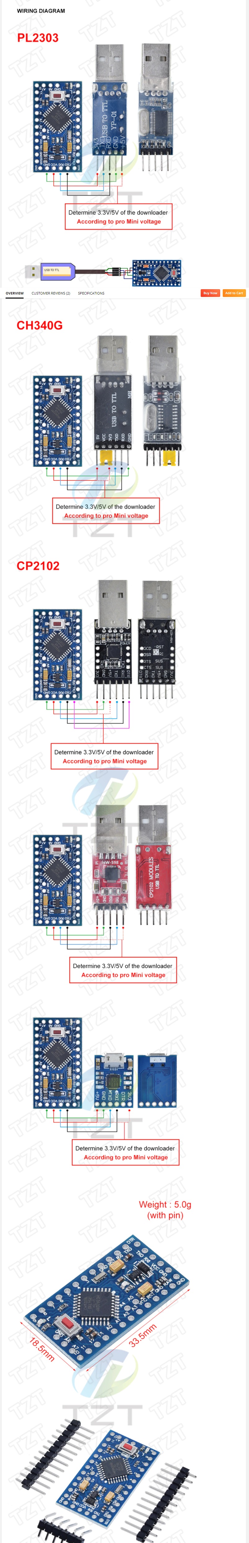

    So I randomly bought the 3v3 version, may not help here but its what I had !
    https://www.aliexpress.com/item/1005...1c444c4dzuNDLc
    just for a test I used this doc to get it to program.
    using the Blink test ino I have confirmed the light flashes at different rates.

    There will be problems trying to use the 3V3 Nano version for the ANPI detector.
    Firstly, the Nano is used to provide +5V for the other ICs, and (obviously) the 3V3 version cannot do this.
    Secondly, the clock is 8MHz instead of 16MHz, although you can change the clock period in the Arduino sketch so that it can calculate the correct timings.

                Arduino Mini Pro is not equivalent to Arduino Nano. It is more convenient, without changing the PCB, at the same price, to order the Nano 5V version. Then, when programming, the USB/RS232TTL module is superfluous, the USB socket sits on the Nano board. Good luck.

                    But honestly it is not very convenient if the sketch requires continuous changes in development, because it needs an external hardware programmer or you can use an Arduino Uno having the precaution of removing the 328 chip otherwise it will be destroyed.
