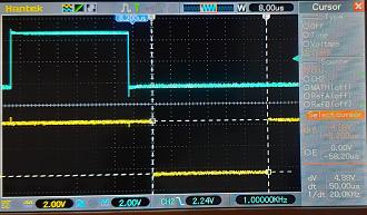

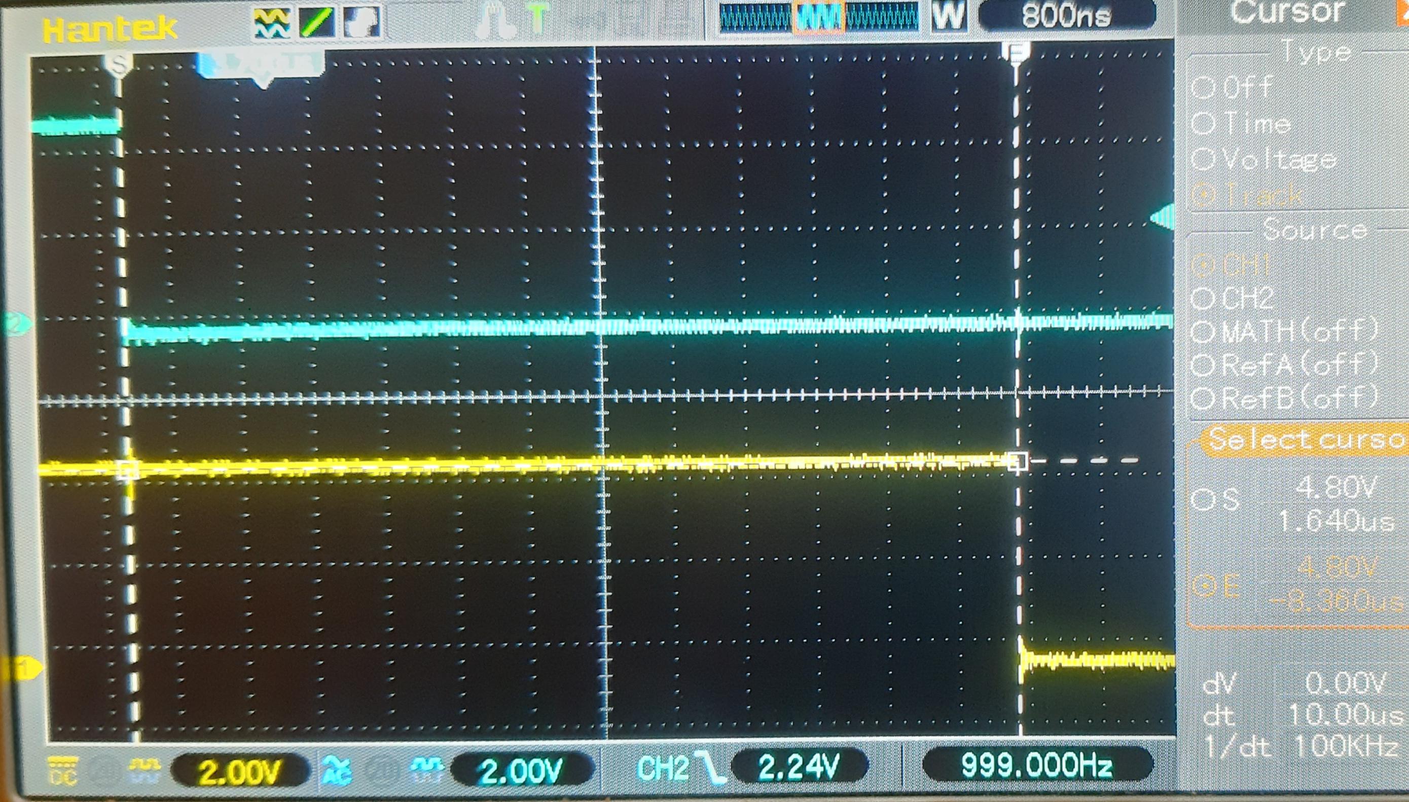

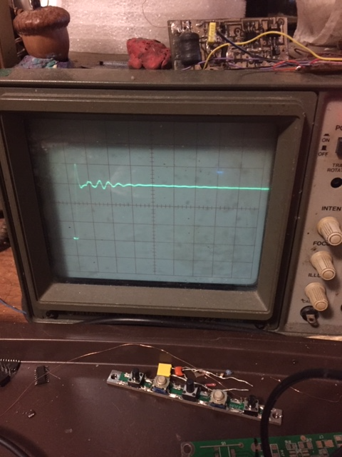

    10us delay between the end of the Tx pulse (blue) and the beginning of the mainSample (yellow)
    Click image for larger version  Name:	20240208_173828.jpg Views:	0 Size:	593.2 KB ID:	420021

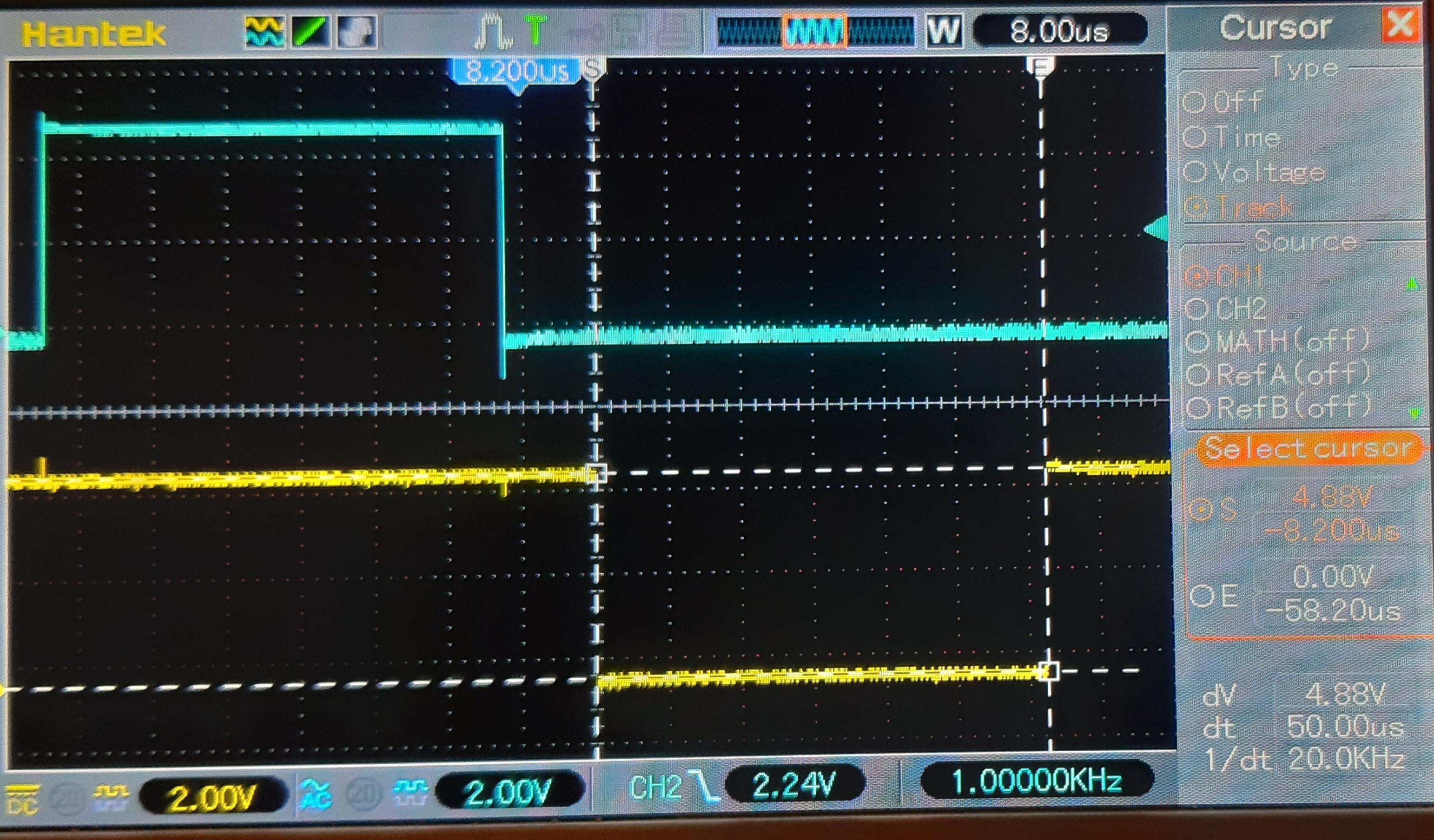

    50us duration of the mainSample (yellow)
    Click image for larger version  Name:	20240208_174107.jpg Views:	0 Size:	597.7 KB ID:	420022

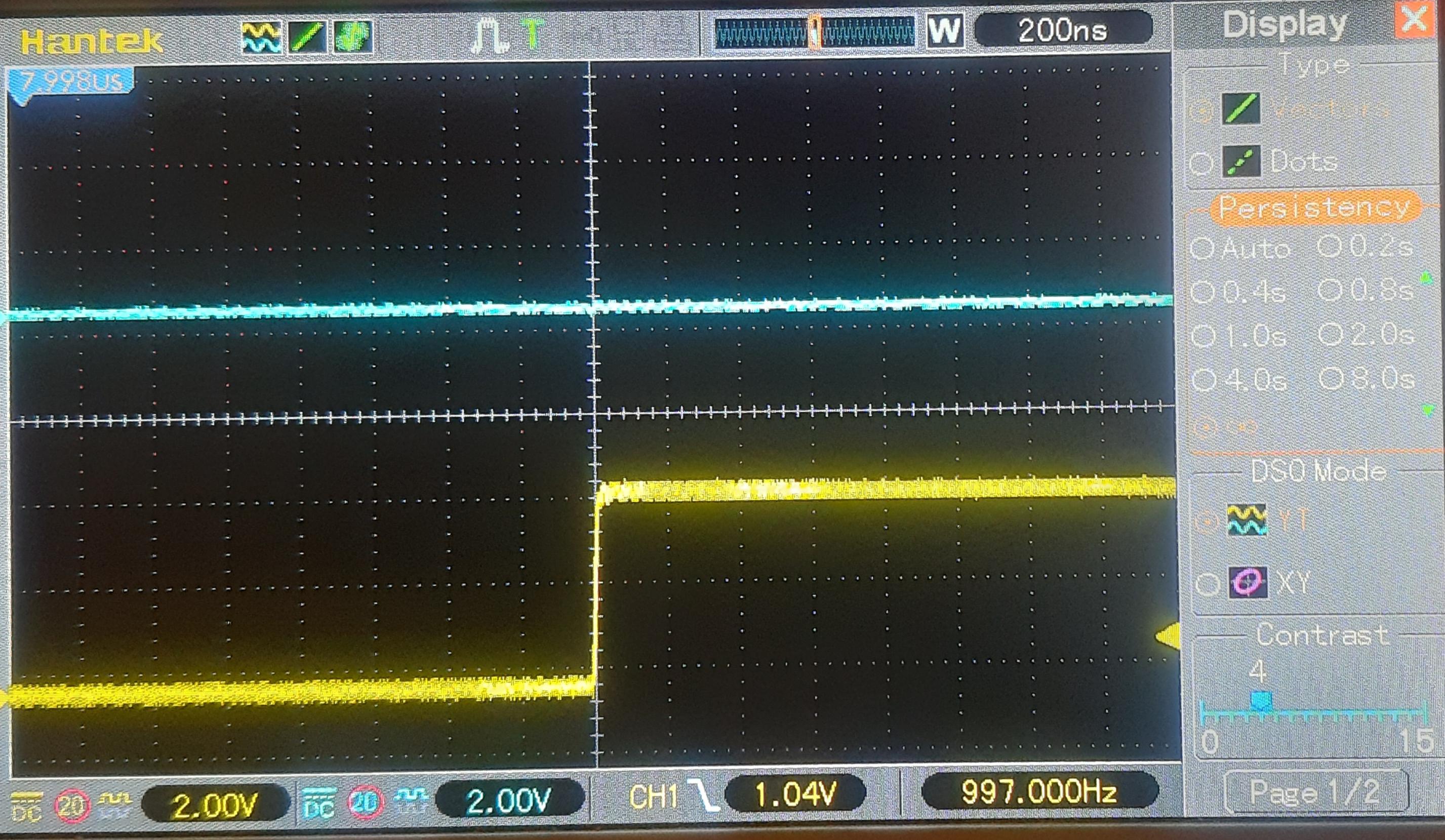

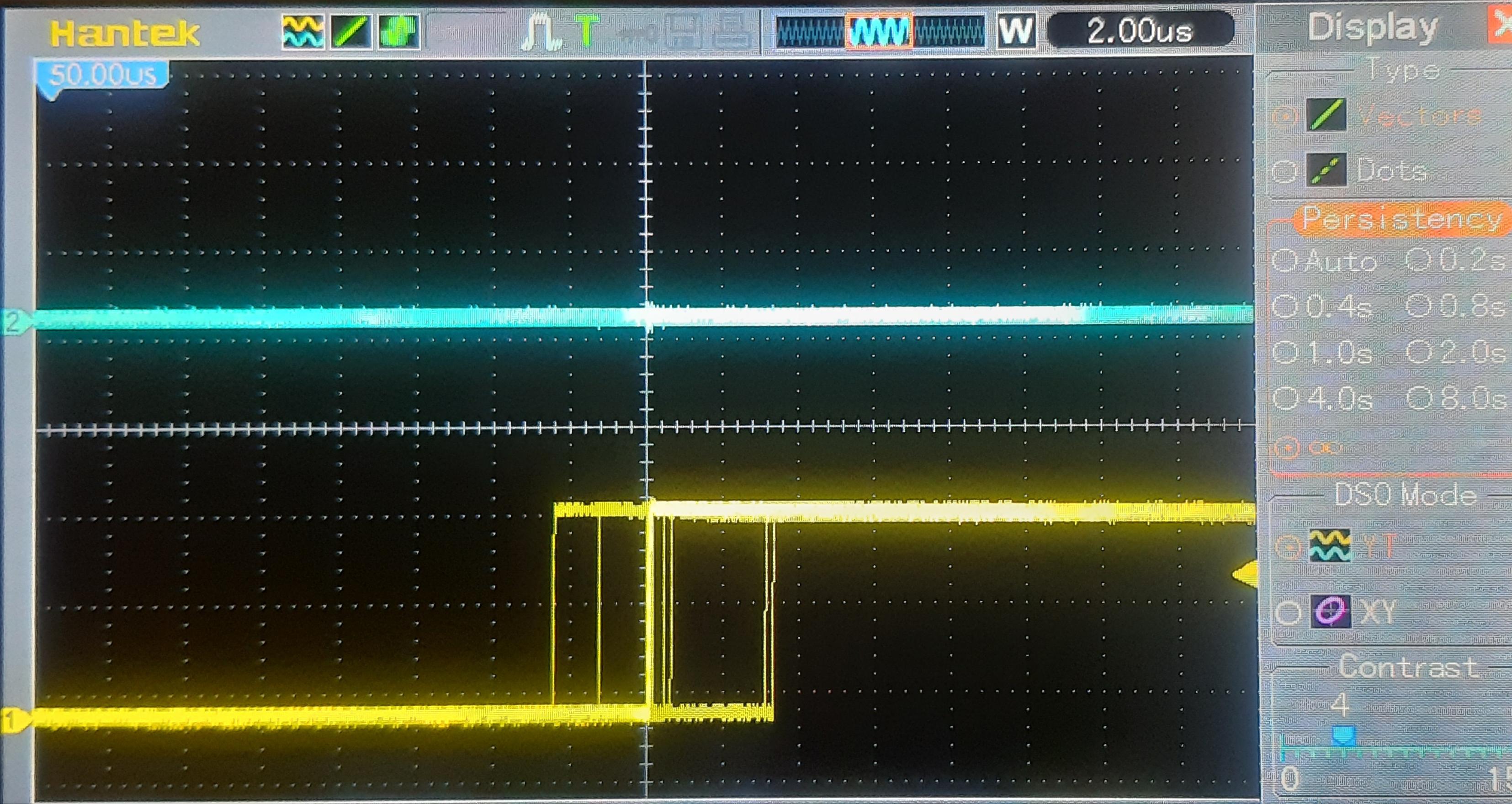

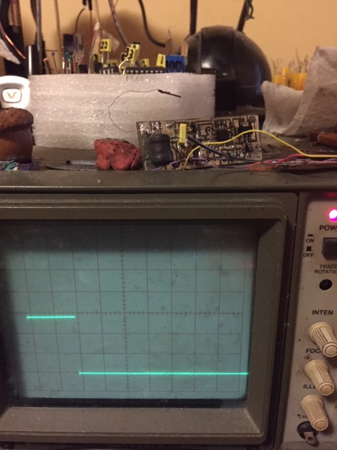

                      These scope captures are made with persistency set to infinity and the trigger set to the falling edge of the pulse (yellow).
                      We see the superposition of a sequence of rising edges and the variability in pulse width.
                      - Pulse driven by digitalWrite(). We see jitter excursions of over +-2us from the average pulse width.
                      Click image for larger version  Name:	20240208_230450.jpg Views:	0 Size:	633.4 KB ID:	420056
                      - pulse driven by Timer1 PWM output using this sketch. Rock steady, constant pulse width with no jitter. Notice that the scale here is 200ns versus 2us above, still no visible jitter.
                      Click image for larger version  Name:	20240208_225431.jpg Views:	0 Size:	642.6 KB ID:	420055

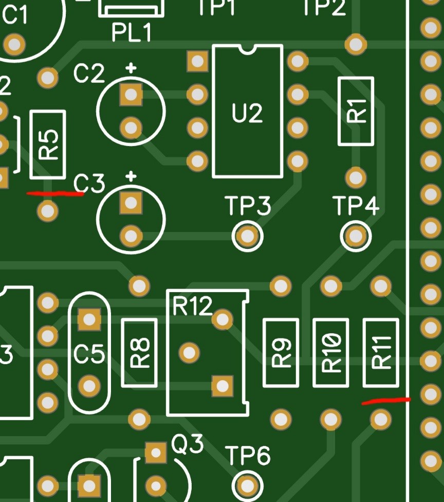

                              Here's how to do the mod on the PCB with minimum impact.
                              Cut the "south' pins of R5 an R11 as close to their pads as possible (so that you can solder them back to undo the mod) and pull their free ends slightly up (~30 degrees) .
                              With a soldering iron and a length of insulated mod wire, connect the free end of R5 to the old pad of R11. Another length of wire and connect the free end of R11 to the old pad of R5. Done!
                              To avoid accidental shorts place some foam/tape between the cut pins and their old pads.
                              The red lines in the figure mark the pins to cut.
                              Test point TP2 is no longer the TX signal but the EFE signal. To see the TX probe the "north" end of R11 instead (the one soldered to its pad).
                              Click image for larger version  Name:	20240209_093420.jpg Views:	0 Size:	156.8 KB ID:	420070
