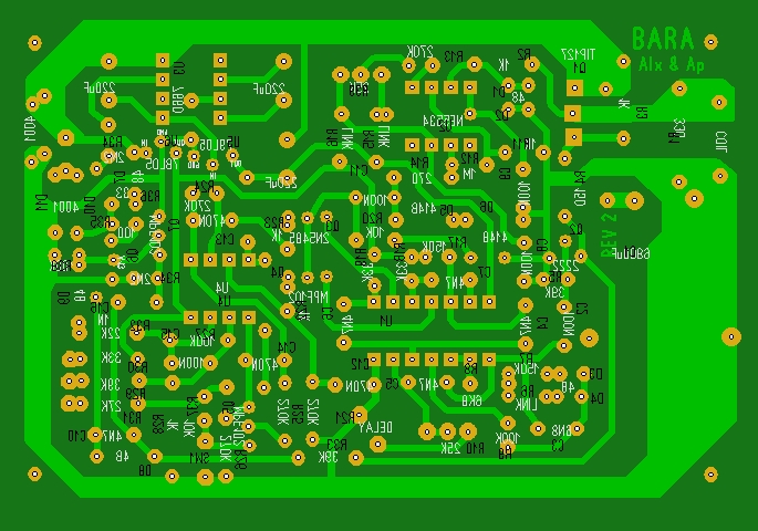

    Hi Sven

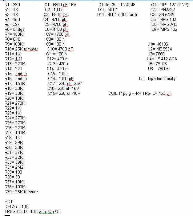

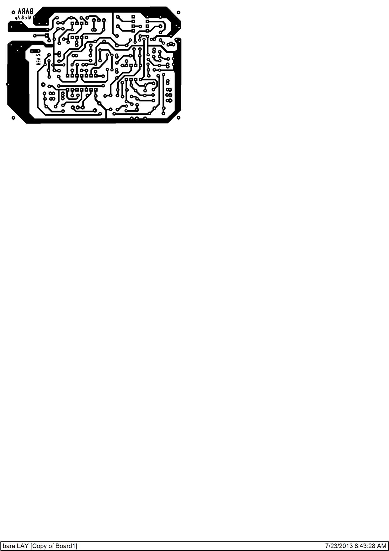

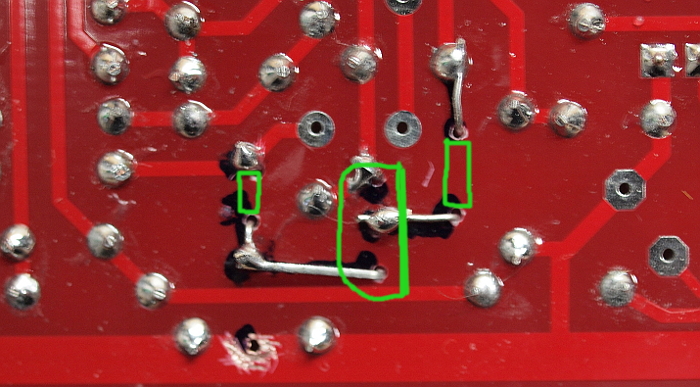

    These are pictures of the PCB taken from the original Barracuda Lay files as promised incl circuit parts list and PCB etching picture.

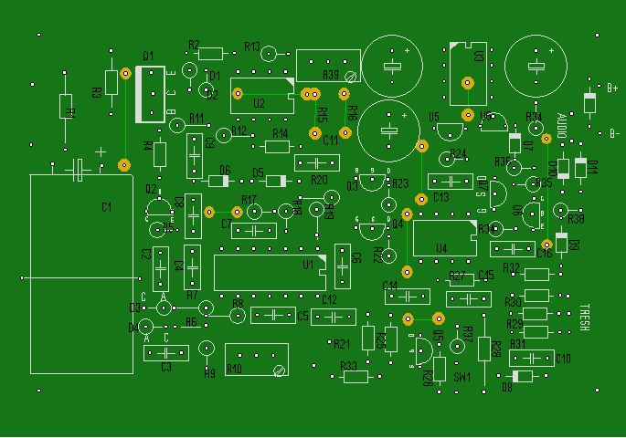

    You bought Silverdog versions so you need to make placements for Q5 and its relevant components R26/R27 etc which are all looking towards bottom right hand corner.
    The link you pointed too which is to the left of Q5 needs to be cut and in place put external delay pot.
    Change Q1 for original Darlington type transistor TP127 , by doing this you also reduce current drain by a significant amount, hence you can get a couple of hours or more just running on a 9V PP3 type battery put in your pocket.
    Far as other components go through them together with the written parts list that I posted on here and do not deviate from it, the part placement numbers and types together with polarity's of components where applicable are accurate to the pictures that are posted taken from the Lay files.
    Don't neglect installing the LED as it is significant with how the threshold works, Its not just for visual but infact required for the Barracuda to work how its supposed too.

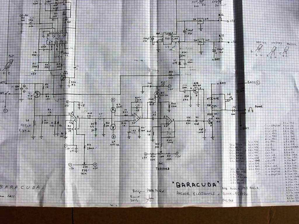

    It still pays to build alongside the circuit diagram for reference as I do and always have done, however in this particular build providing you have done a good job and components are to accurate specification theirs know reason why it wont work on first switch on.
    I forgot to add that with Q6 which is audio output transistor part description MPSA13 is far as my research went no longer available but don't worry at all because the MPSA14 is a direct upgraded replacement which does actually give more clout to the audio.
    I think that's about it, If I think of anything else will post it here.
      Thanks, just noticed your post. I actually had several MPSA13 in my parts box.
      So basically going to put back in the parts that were left out of Silverdogs PCB.
      Since I have some time right now, will drill the holes and add the parts.
        While Its still fresh in my mind there are two R34s on the circuit but not in the parts list one comes from pin7 of the 7760 the other from the gate of MPF102, have written on my copy R34A/R34B but never got round to doing it on here, they are both 2.2megs.
        Also there is a Diode on the placement across the battery which is not on the circuit or parts list so not original, it was probably after thought for wrong polarity protection, if you want to fit it for peace of mind IN4001 will do the job as shown on placement but remember if your going to use high capacity batterys make sure you fuse at around 800ma max.
        I more or less finshed my second build, all transistors apart from audio out and regulators are socket-ed for easy experiments between the original and silverdog version plus there are a few other things up my sleeve Id like to try regarding SW1.
        All the best

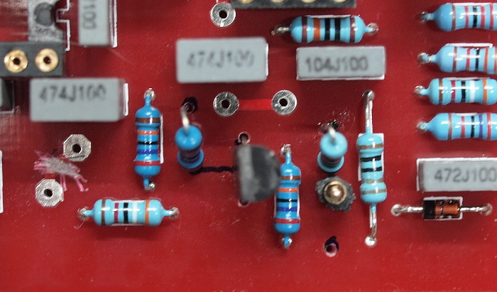

          Added the parts back in.
          Won't be able to do any more until the rest of my parts come in next week sometime.
