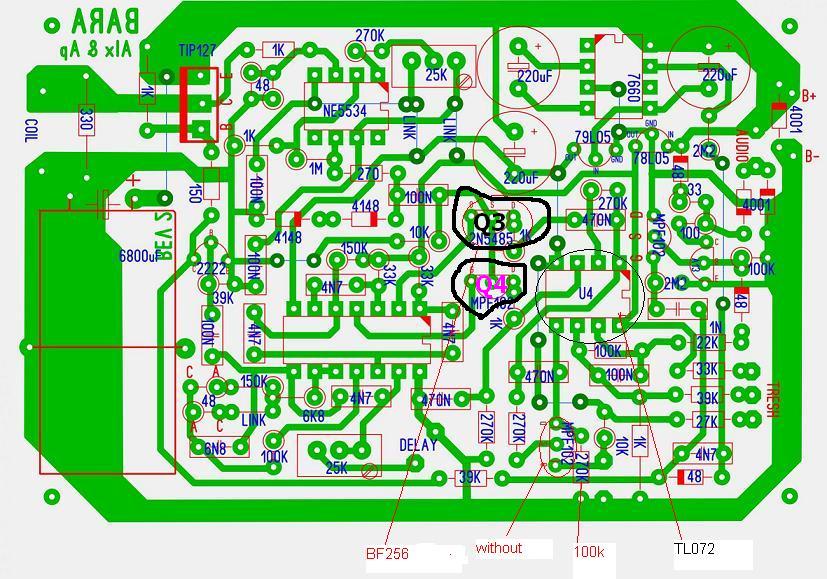

      If you can, try to find matched pair J-fets in TO can package, like 2N5912, 5886, 5884 or similar. Then whole thing can work even in completely static, non-motion mode.
        If you cannot buy matched J fets , buy 20 of same type and try this tester.
          ok
          i test this fet by many equevalents lik bs170,bf256,bf245b ,....
          best stability and result for me Q3 is bf256 and Q4 is bf245b and can detect in bigest depth at 17cm.
          any one knows which is better to use these.for example both are the same transistor

                bob, i built the same unit, have similar sensitivity to yours with large objects, but wont pickup coins unless right beside the coil, i am using a minelab gp3000 coil 286uH 3.7 ohms, can you please tell me your setup procedeure.
                  Rabbit,
                  Setup is what was recommended from Silverdog. I'm thinking you need some more turns on the coil and R is a bit high from the manufacturers coil specs. Just a guess I'm no expert.
                  Bob
                    bob, i didn't get any setup procedeure just the parts and pcb. can you please post that procedeure or email me direct?
                    cheers
                    rabbit
                    [email protected]
                      Bernt one already answered you awhile back....Here it is for you to reread.....
                      hello rabbit
                      with the parts from silverdog the units should work
                      the setup procedure you read often here was made for the ideal (or original coil) i think
                      if you dont hit the coils specs wich are suggested you cant setup the offset to zero volt and think all should work fine then
                      i do it this way:
                      i make a coil for example 24turns of 0,5mm yv wire, 27cm diameter
                      schould be under 2R and 400uH
                      threshold at nine o´clock
                      delay at 12 o´clock
                      (if you have pots connected for both)
                      offset is in middle position (i dont use multiturn trimmer i use an ordinary pcb trimmer)
                      then turn offset down and watch result - mark best postion on srew from trimmer
                      then turn trimmer up and see if you can get a better result as before, if yes you are right there
                      at the end you can make a chekc and measure ne5534 and lokk the offset voltage
                      in my case it is not zero volt but often it is near a critical border before the voltage doesn´t change anymore when turning the offset trimmer
                      with light humming threshold and delay between 9 and 12o´clock i got a 2€ coin easy at 30cm in air
                      and i think all about this distance +/- 2cm are godd enough for such a simple machine
                      head up, i hope i could help
