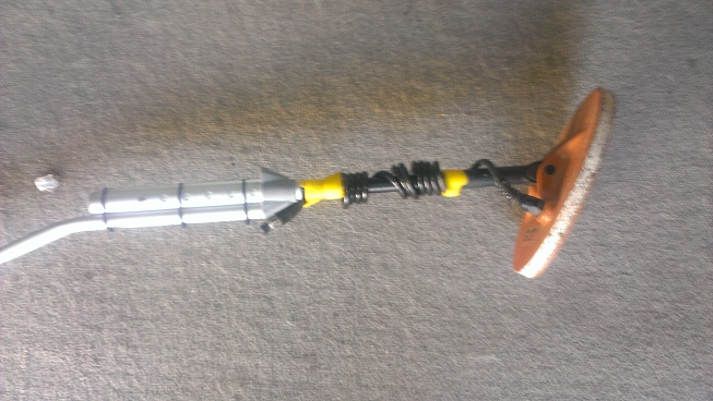

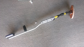

                  have finished the shaft and coil set up to start with i stole one of my gpx coils coiltek 5x10 mono will build my own coil but just to test the new build will go with the coiltek as i all ready have it
                  ive got also a 11 commander mono and a 16 mono nugget finder probly a bit big tho
                    made the shaft from a crutch and slid a minelab fibreglass lower shaft in side the lower crutch so i can use the adjustment buttons
                    one the lowest it suit my son and on the highest it suits my just nice and i quiet suprissed how lite it is the yellow things are velcro tyes

                      the lower part i glued the lower minelab shaft in side the lower crutch witch i shortend buy about 6 inchs and about 8 inchs of the minelab lower it was a snug fit just like a bought one
