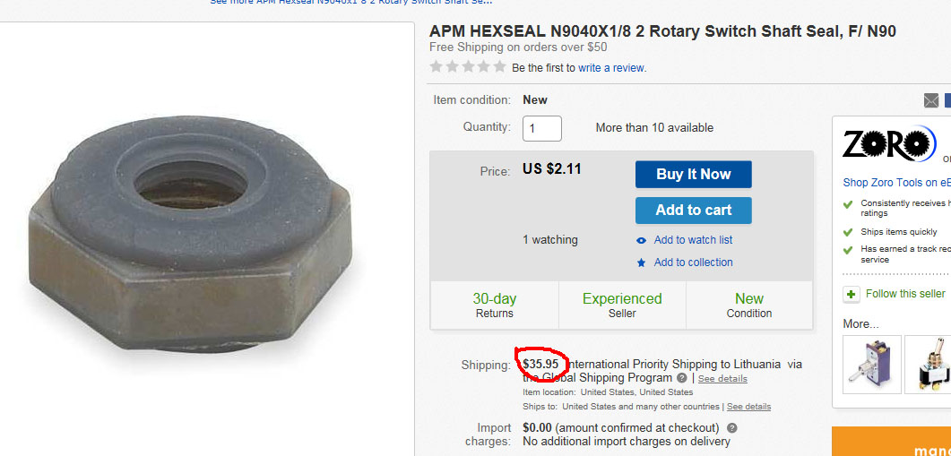

      Why not just do it right ? http://www.potentiometers.com/select...fm?tab=HexSeal
      • #48
        • #49
          [ATTACH]38334[/ATTACH]
          That global shipping you have highlighted is a rip off and nobody should use it.
          Ask for normal post office shipping or you will not buy the item.
