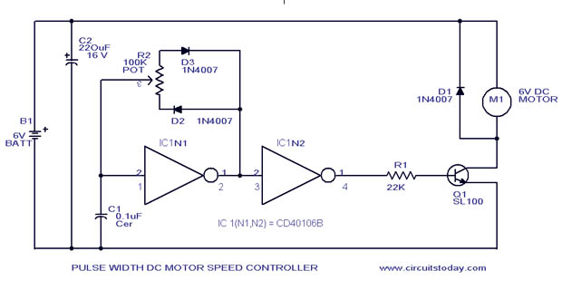

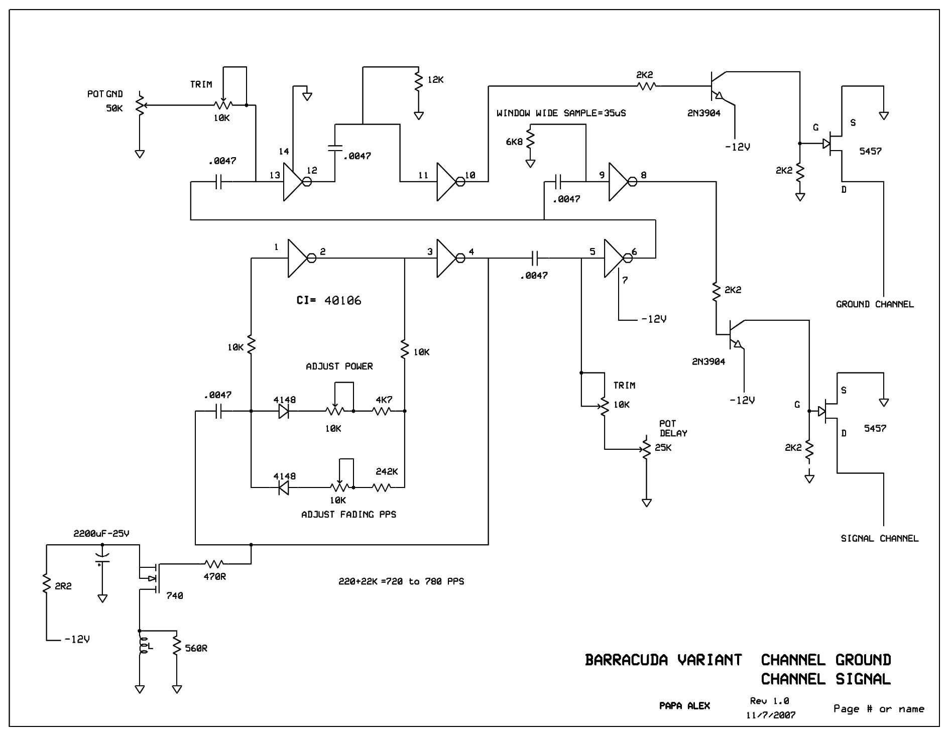

Is someone able to explain the function of the 40106 datailed, resistor by resistor and cap by cap
found this and it was very helpful
the reason is that i think about to make the pulsewidth and maybe the frequency variable by some additional pots
but i am still not able to explain all myself
my first target would be the oszi form pin 8 and 9
