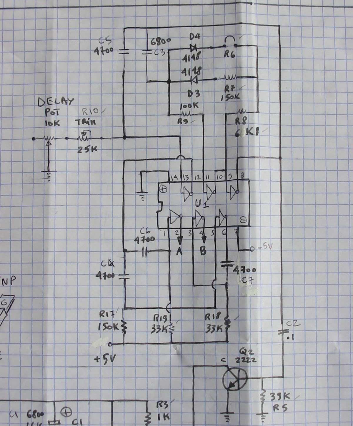

    Is that Any One Have Clear Schematic For Baracuda

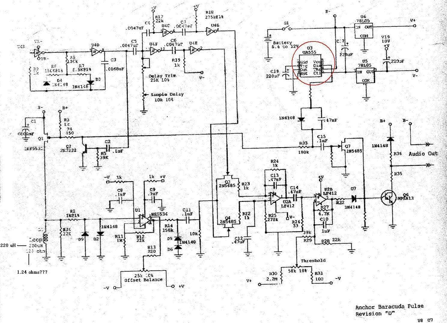

    How about this one?
      How about this one?
      You Are Thanks SilverDollar I Want Try Rip This Schematic
        not sure if you should trust that schematic,
        quite allot of values of resistors have been "doctored" / changed to "silly"
        values,
        also the 555 configured all wrong, itll go pop !!!
        it's poss a "spoof" schematic..........
        check out resistor values around the 5534 and u2a and u2b !!
        pin 3 of the 555 goes to "earth" !!!
        and the 220uf between reset and trigger made me laugh, a bit !!

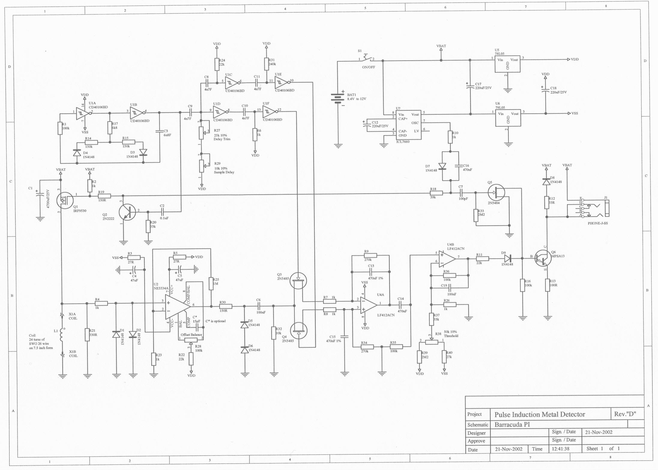

            here,
            try this schematic,
            it's the clearest one I have found,
            had a quick look over, haven't spotted anything.........

            oh, since compared the other schematic to this one......
            the 555 on the top right supposed to be a 7660,
            which, unless you have the high voltage version it won't like
            12v's going in to it.

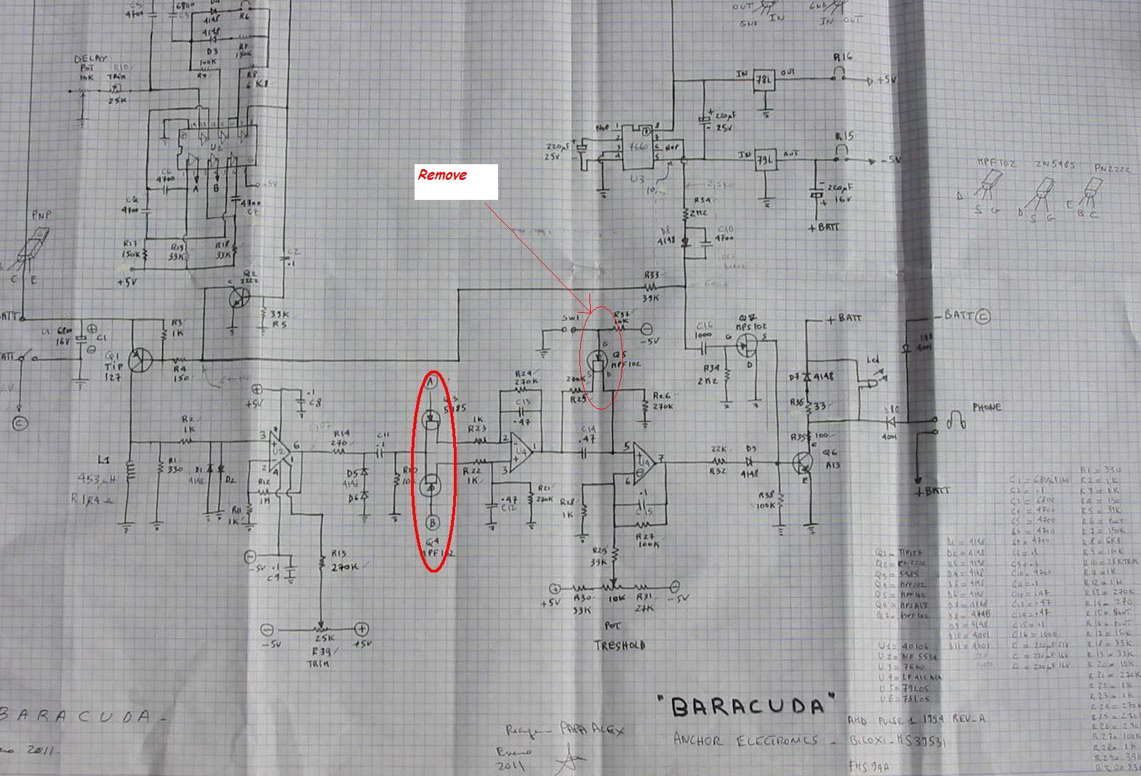

                  kt315 in your schematic remove the read mark, and the board have empty hole, leave it empty ?
                  or what
                  sorry my stupid question and my very bad british english :d

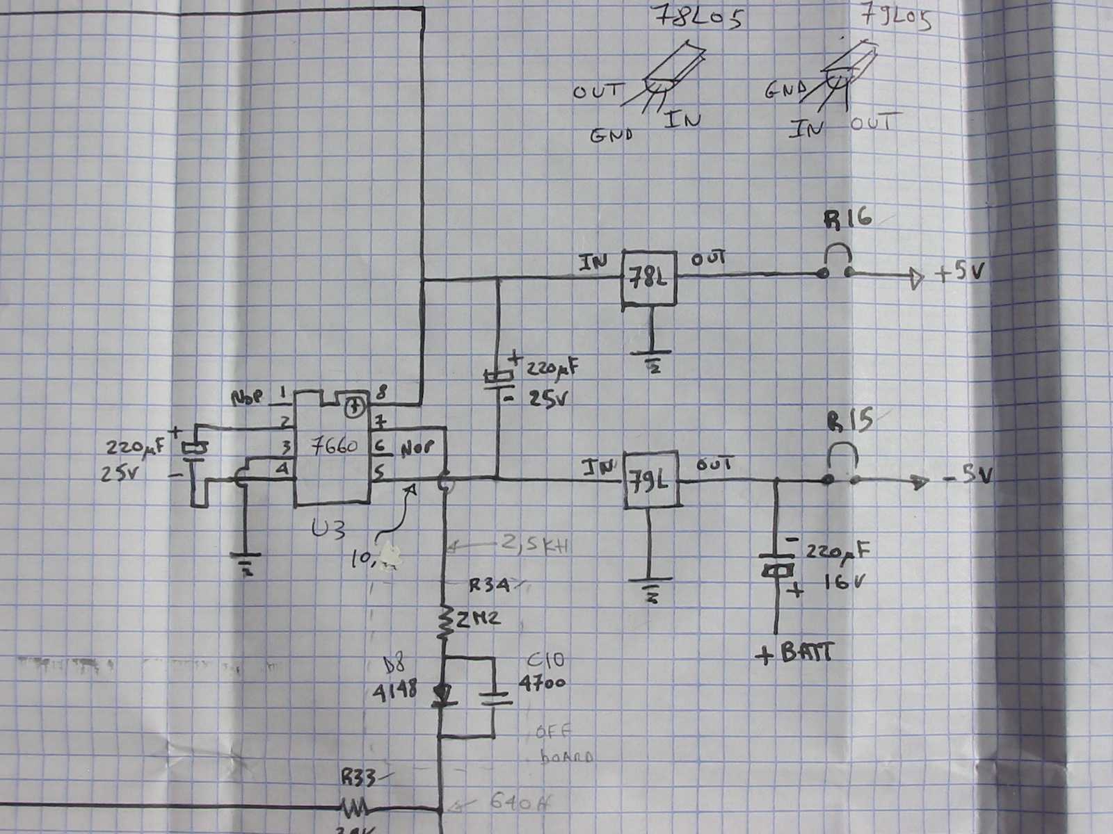

                        at pin U3 IC 7660 Pin 5, Some Schematic have Resistor 270K, or 10R other schematic have direct without resistor which is true
                          the schematic and the part placement on pcb layout is much rong

                              best resolution shematic i have for the moment
                              just change the partnumbers if you find some parts which a not same on the actual layout
                              thats not critical, follow the legs / pins of the integrated circuits and you will find what you want to know
