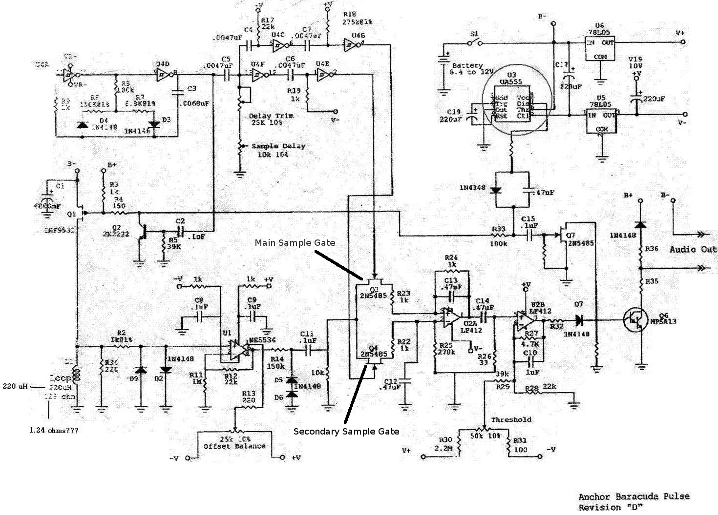

          Perhaps the Earth Field elimination is not working. That would account for it being ok on the bench (non-moving coil), but beeping when the coil is moved. Does it beep on the bench when a magnet is waved in front of the coil? Of so, then check the EFE part of the circuit.
          What parts are EFE part of the circuit?
          I will try with microphone cable.
            Have a look at the attached schematic. I have marked the main and secondary (EFE) sample gates.

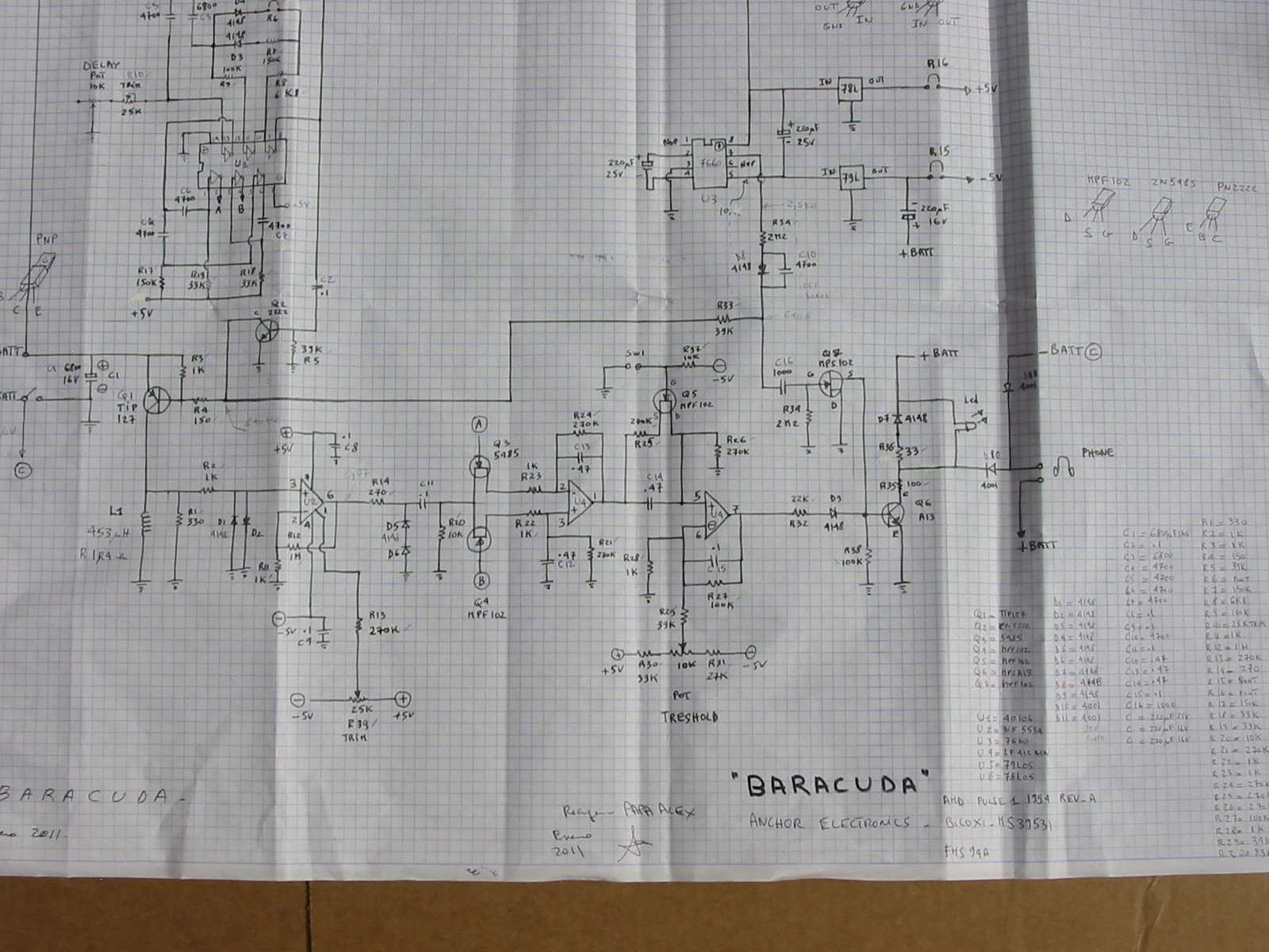

                  On my barracuda these two transistors Q3 and Q4 are different. Q3 is 2n5485 and Q4 is MPF 102. Should not they be the same? Baracuda is version Alex/Ap rev2
                    In your kit did you not get 3 FETS two the same and one different. You could swap two over so Q3 and Q4 are the same. There was a discussion on the main Baracuda thread about a performance advantage of matching Q3 and Q4
                    Board is marked with different components for Q3 and Q4 ????
                      The pcb Alex / ApRev2 is based on this reversed schematic from the original Baracuda - which has different Q3,4
                      That is not to say of course that findings since prove Q3,4 are better matched

                            those are same FETs. identical. NOT DIFFERENT. do not take attention on that. I setted BF245's and they working in all places (inverted position of course).
