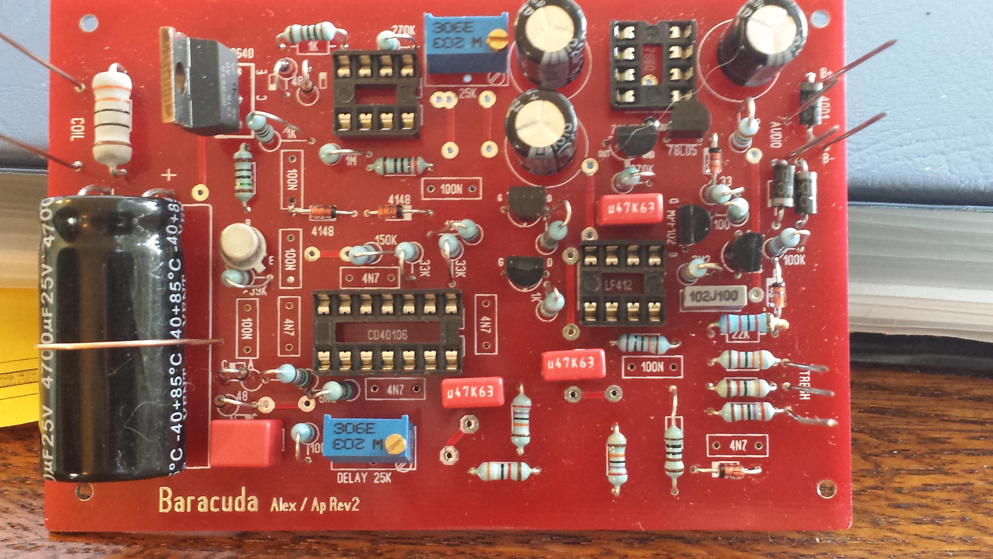

          looks like 4N7 on board is #472J100 like tables show but I still can't be sure if #10nk100 is 100n as for swapping wrong parts I used the process of deduction and pics of assembled boards. So here is what I have: 15 rectangles on pcb 5x 100n, 5x 4n7, 3x 470n=#u47k, 1x 6n8=#6800, 1x 1n=102j. Here are the parts I had
          5x (472j100), 5x (10nk100), 3x (u47k63), 1x (6800 100). where I show ****=#**** I have soldered these already HOPE that's right sorry for making this so long I hope I'm clear on explaining or does it sound like rubble? All thats left is 2 sets of 5 parts / 2 sets of 5 places.
            Here is a picture of the board so far to help with explanation if you spot any discrepancies in placment of 4 red & 1 gray capacitors let me know.

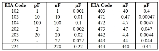

                          4n7 = 4.7nf the n = the decimal point. EIA code 472
                          100nF is 0.1 microfarad = EIA code 104
                          10nK100 is 10nf or 0.01 microfarad rated at 100 volts = EIA code 103

                            (On board 4n7) I put 472j100 (on board 100N) I put 10nk100.
                              If the board says 100n then 10nk100 is the incorrect value. 10nk100 is only 10nF. You need a 100nF cap. The 100 at the end of 10nk100 denotes that is rated at 100v. An incorrect value may have been added to the kit by mistake. You will find that the circuit will operate better with the correct value in place.
