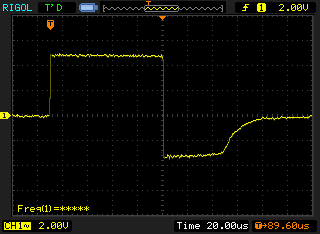

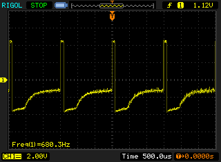

    Pin 6 of NE5534 is looking like that:

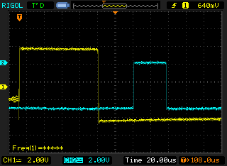

    With Pin 2 of 40106 additionally:

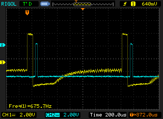

    Zooming in:
    Is that how it is supposed to look like or is there something wrong with my assembly?

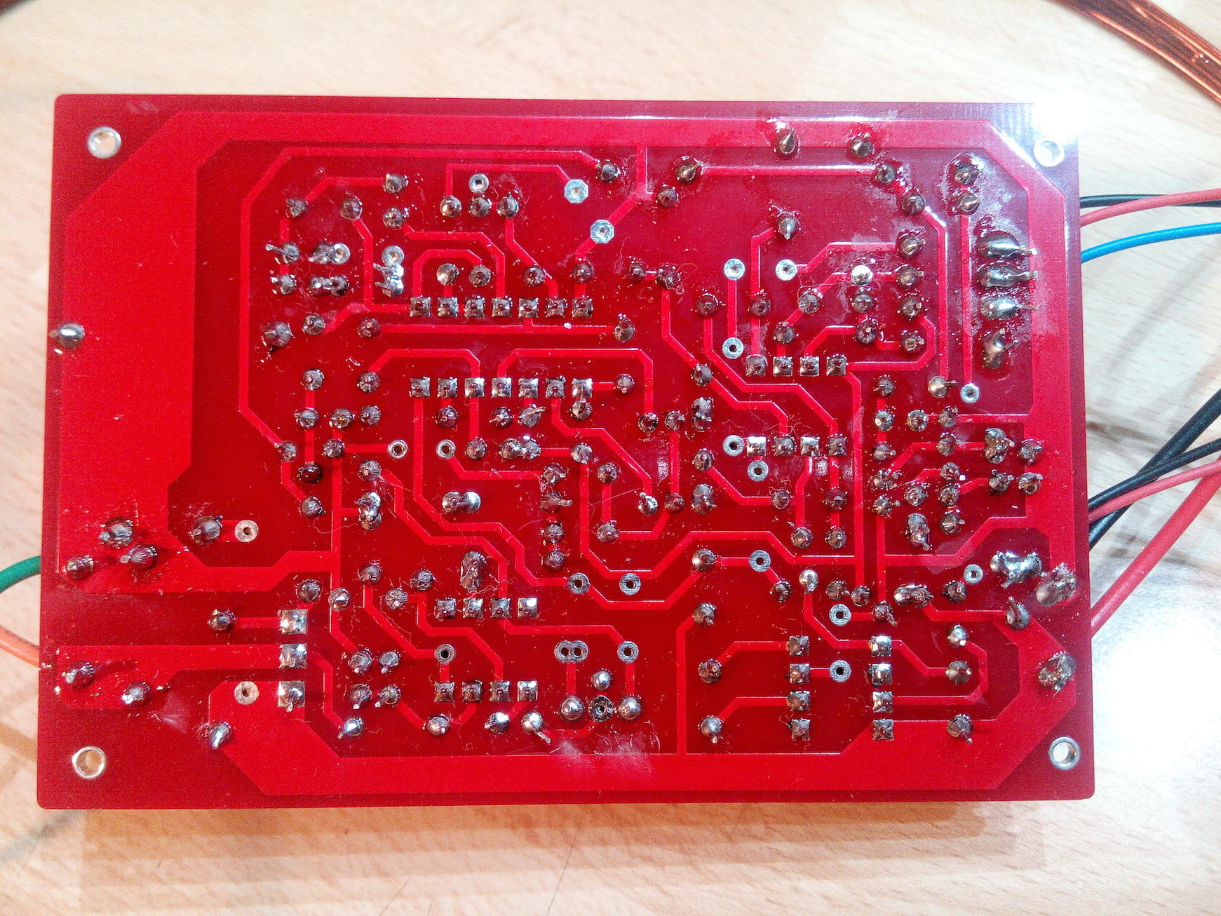

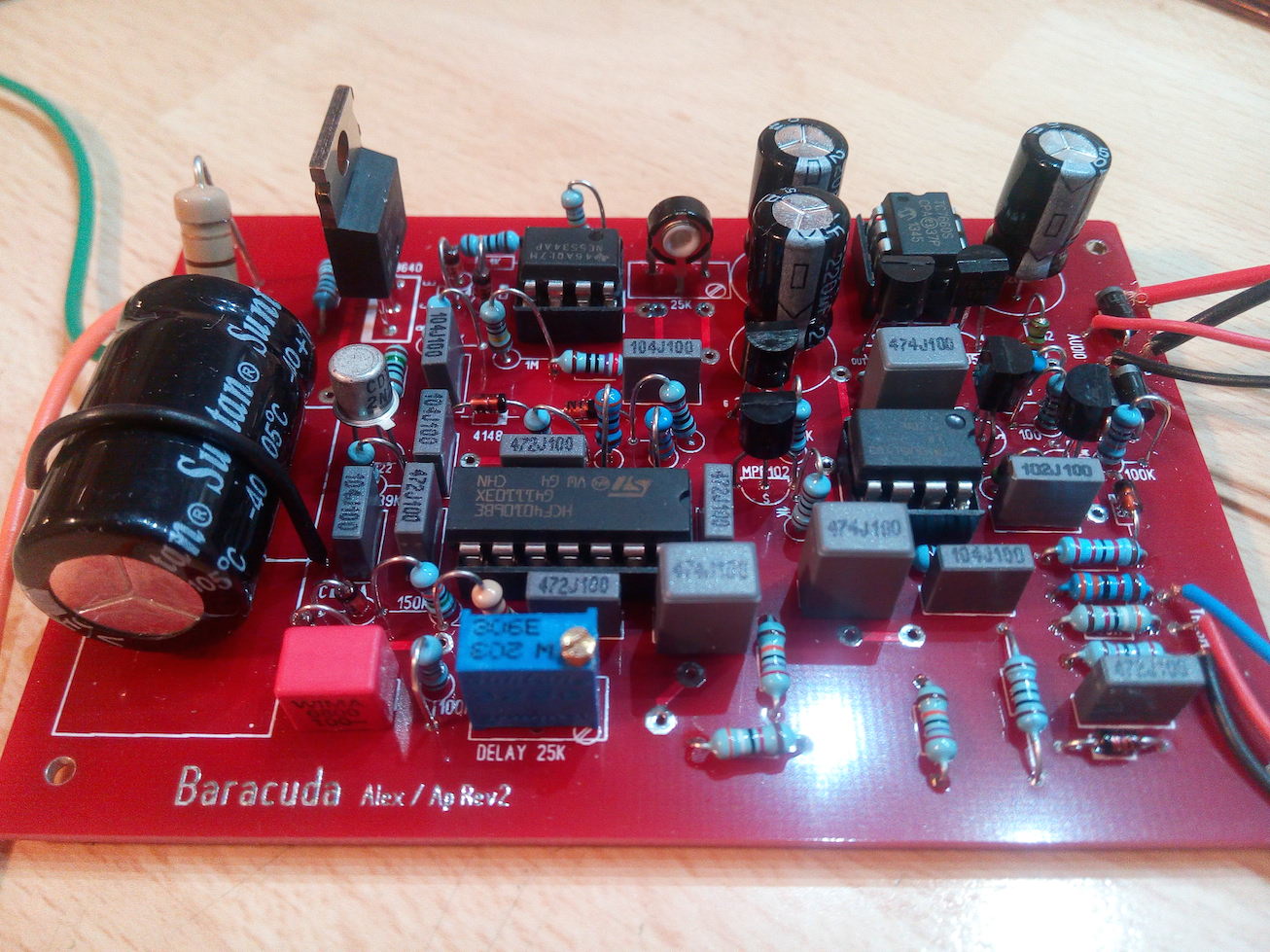

    That's how the board is looking like: Click image for larger version
ID:	369357 and bottom: Click image for larger version

          When comparing scope shots of other baracudas (e.g. this one: http://www.geotech1.com/forums/attac...9&d=1309516746 from post #141 of the Baracuda Legend thread in Schematics) with mine, the NE5534/6 signal looks completely different. After the falling edge, the raise of the signal is happening quite fast. Depending on the delay setting, this happens before the raising edge of 40106/2. In my setup the raise of NE5534/6 happens significantly later. See a12.png above.
          I don’t know if this causes problems but at least it’s an obvious difference.
          Any idea which components are influencing the raise of NE5534/6?

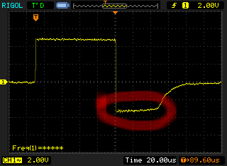

            Finally some good news...
            During holidays I read "the book" (ITMD). The 2nd edition was available right in time. Thanks to Amazon, it arrived one day before we were leaving
            Back at home I've again tried to find the problem (after preparing a better coil). While measuring several several OpAmp outputs etc. I have lifted the coil from the desk and noticed that the picture on the oszilloscope is changing heavily. It was morphing into the the figure I was aiming for:
            Stupid me! I should have noticed earlier that there is a metallic construction under the plate of the desk I was working on
            So finally everything seems to be working fine.
            Only one thing: I've connected a 1k/5W potentiometer as damping resistor. While changing the value one from 200 to 1k I did not notice a change in the oscilloscope picture.

                After a second look at the oscilloscope screenshot, I've noticed that there's still a difference to the other pictures: It takes about 50us until the signal starts raising from the lower saturation to 0V:
                In other pictures, this is closer to 20us. This makes more sense as the minimum delay on the original Baracuda was 22us.
                Is this difference caused by the coil (e.g. too high capacitance)?
                Or is there any other known reason?
                Thanks!
                Frank
                  Thanks!
                  Frank
                  I haven't built the Bara, so I don't know what minimum sample delay is expected. However, assuming it's supposed to be around 20us (which sounds reasonable for a beach detector) and your coil is critically damped (or slightly underdamped) then the finger of suspicion points to the coil.
