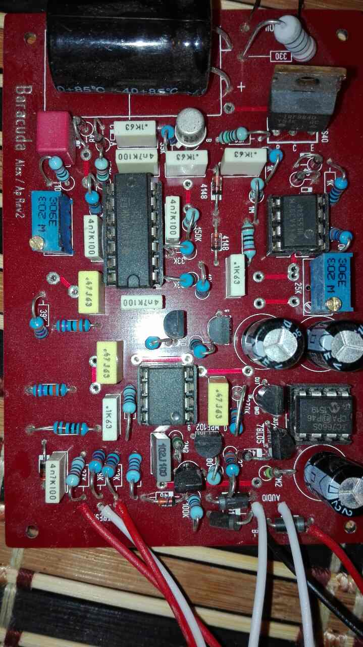

              Hi. I have a problem locating VT1 on the pcb, and the trimmer pots are 20 turn, but they are turning continuously, and i don't know where is the middle position, except if i desolder it. Here is the pic of the board, so please can you mark where is VT1.Click image for larger version

                Originally posted by gogi View Post
                Hi. I have a problem locating VT1 on the pcb, and the trimmer pots are 20 turn, but they are turning continuously, and i don't know where is the middle position, except if i desolder it. Here is the pic of the board, so please can you mark where is VT1.[ATTACH]38673[/ATTACH]
                Turn your pot in one direction by more than 20 turns. At this point you must be at the end. Then turn it the other way by 10 turns. That's the middle. Simple really.
                  Yes, thank you.
                    VT1 is a big transistor IRF. It stands right on the big capacitor.
                      1. measure the resistance between edge pins of the pot ie full value, pin 1 pin 2 and pin 3 - you take pin 1 and pin 3.
                      2. stay on middle pin and one of edge pin, pin 1 and pin 2, either pin 2 and pin 3.
                      3. spin a shaft of pot and look the resistance value on your tester meter.
                      4. - before you would get 1/2 of full its value.
                      5. thats be sure the middle position.
                        why you need to desolder irf to set 0v null?
                          1. if you do not have o-scope
                          1.1. desolder irf
                          1.2. measure and set the nulling
                          2. if you have the o-scope
                          2.1. not desolder irf
                          2.2. set nulling looking the pic on the your o-scope.
                          3. if 40106 is setting on socket
                          3.1. remove 40106 from the socket
                          3.2. no generation - irf is closed
                          3.3. irf is not needed being desoldered.
                          3.3. measure the nulling
                          is that clear for you?

                            yes,thankyou!
