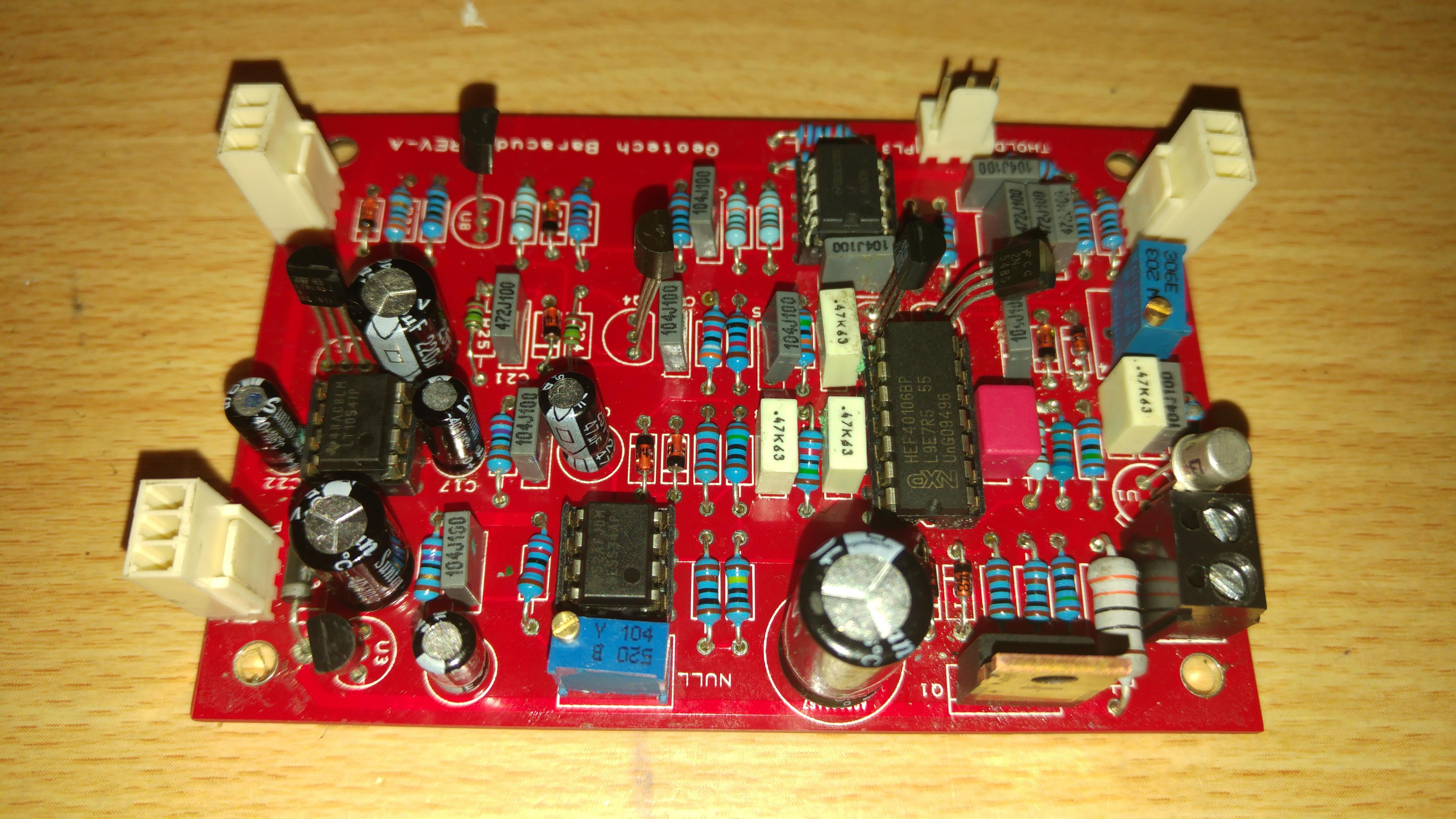

    I have bought a barracuda rev a set from silver dog and I am having some problems getting it to work. It seems as if half the board is not recieveing power as the speaker/buzzer has 0v on the pins.
    I have also noticed the schmitt inverter only puts out .7v on pin 4 where on the instructions it states to try the buzzer. The lf412cn also outputs 1.5v on pin 8 instead of 5v.
    Does anyone have any clue what could be wrong?
    Thanks!
    upload a pic to the forum of the board also make sure you have had flow through on the holes sounds like a resistor out of place or a bad soilder

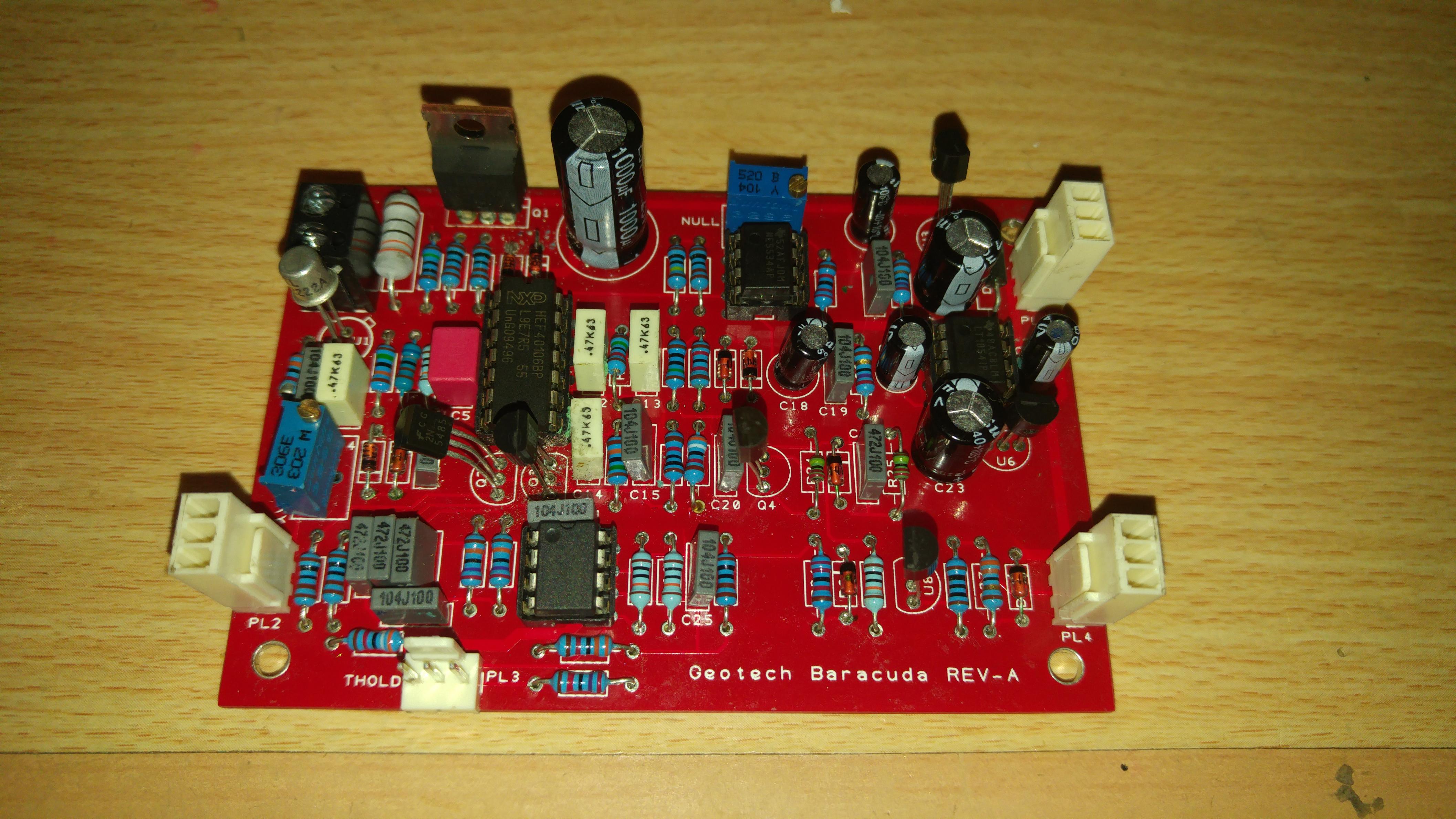

      Here are the pictures of the board. Click image for larger version
ID:	347114Click image for larger version
        Did you get 5v and -5v from 78L05 and 79L05 output?

            by the look of the board you need to buy some flux put it on your board and resolderer, you have not got flow through on a lot of the solider joints
              That's no so important, as the board has plated-through holes.

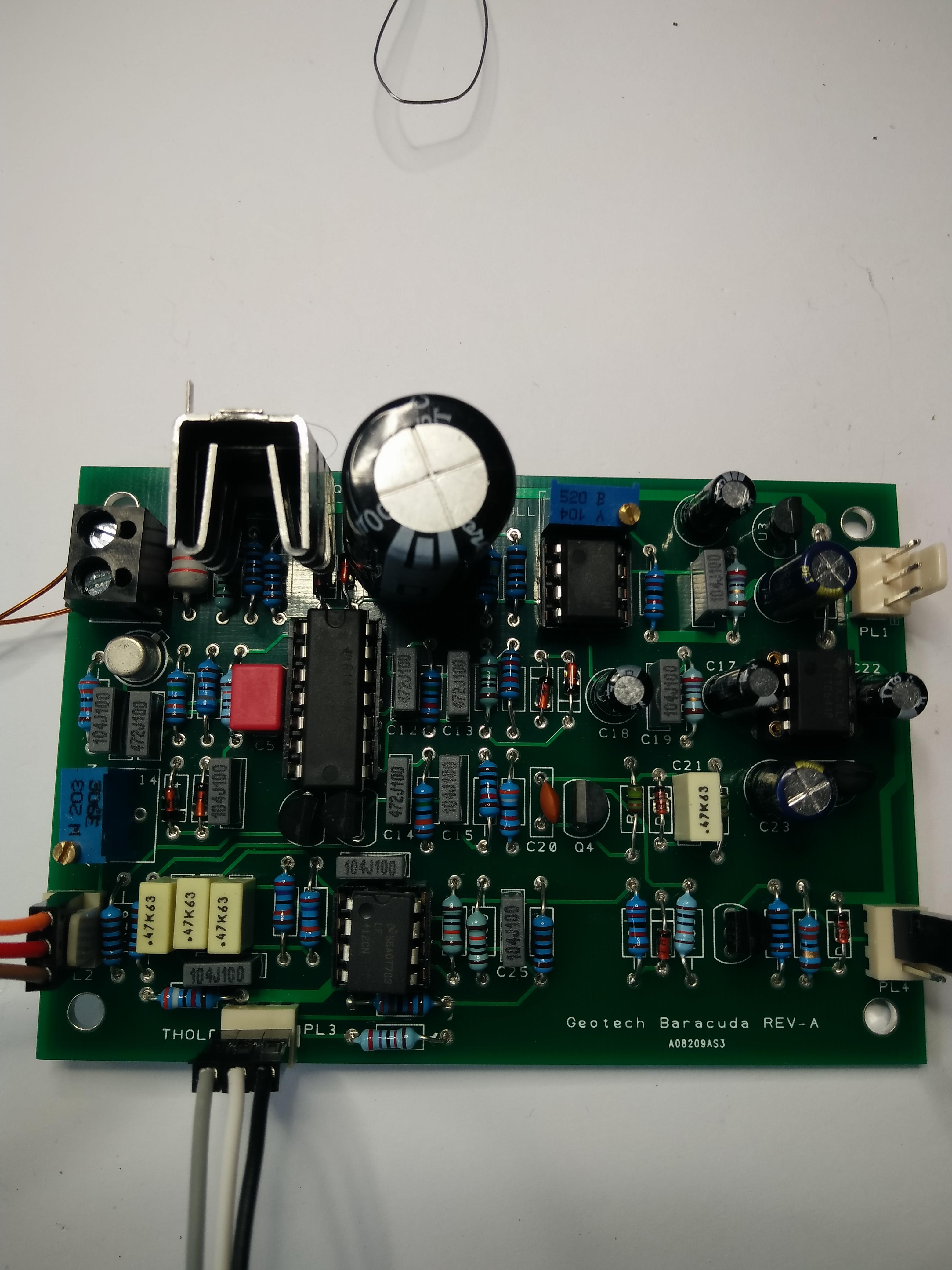

                I am at level 7 of the kit construction.
                The sample delay is 20 us on pin 4 U4,
                But the voltage on pin 1 U7 is -1.00v instead of -2.1v?
                Worrying or not?
                  Worrying or not?
                  As long as you get a voltage increase when a target is placed near the coil, then you should be ok to carry on. The voltage measurement is only a guide, and there may be some variation between different builds.
                    Voltage increases , I continue the assembly.
                    Thanks for your reply.
                      i also noticed the caps are in the wrong place
                        looks like you mixed up 4n4 and 470n at least
                        472J100 = 4n7F
                        .47K63 = 470nF
                          C5 seems big for a 6,8nF, but maybe it is provided for a high voltage.
